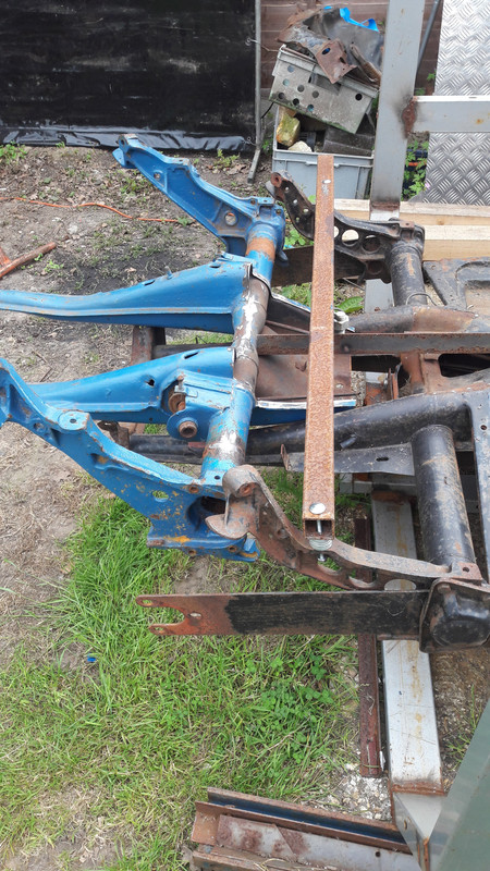

Frame head all on still need to clean the welds up,
I hope to cut off and fit the IRS rear end in this week jig 1/2 made I will give it a 1" lift as well, It's a lot of work for not a lot

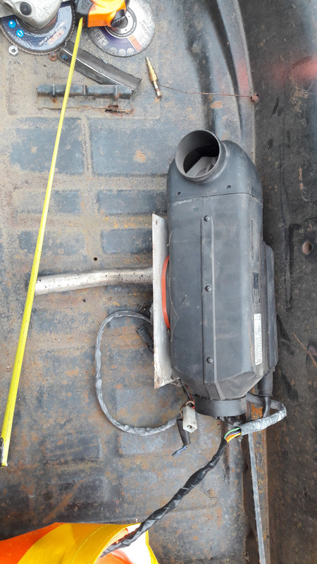

I'm fitting gas night heater in our camper so the buggy will get the D1 :D

Posts: 3,507
I have a friend who quite some years ago now fitted a eberspacher petrol fired heater pulled from a left hand drive beetle in the local scrap yard. This had two controls. One for heat output and I think the other was a timer but not certain now. It certainly put out some warmth but smelled a bit bad. This may have been because it was old and probably never serviced at all.
IDA
Posts: 513
Mk2 Rat and LDV
Location: CHICHESTER
Quote from: Paul1953 on June 03, 2019, 01:41:05 PM
I did have a petrol Eberspacher in my 181 they are good that had the red and green controls but they are big and old,,.. I like the Diesel ones as you can use red-Diesel" so cheap to run,,

Yes they are large. Almost all still existing will be in a "fairly dangerous" state condition wise. I have never seen the diesel version other than in pictures but they must surely be safer running off diesel. Do you still need to be a registered user to get duty free red diesel legitimately?

It is not for road use ;-)up They will run on red or home heating oil etc but not on veg that is why I took it out my van,

They have been in my shed for 20! years, at last, I got a buggy that they look good in ;-)up

A good day in the garden at last ;-)up, I got the side irons on!! as I do not like the look of body to pan I hope the Irons will give it a clean lower look and it adds 20!!kg ,, I ended up using a rack and it looks like turning circle will not be too bad,,
I always fit the iron under in the channel or if needs be remove the outer down lip, then you can fit riv nuts into the top of the box to secure the body, roll cage needs spacer tubes and long bolts then though. but it keeps the pan in original dimensions.
IDA
Posts: 513
Mk2 Rat and LDV
Quote from: snoopy on July 15, 2019, 04:18:01 PM
I put the box seam at the bottom as was going to us m10 rivnuts I used the GP dimensions as I will not be swapping chassis and unlikely it will fit any other buggy as it would need a flat rear boot! floor
