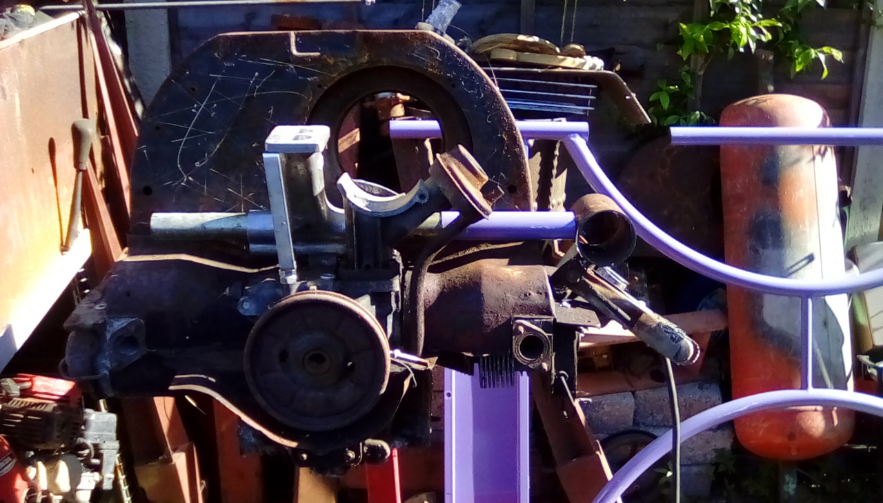

I made!! a engine running stand as my old one is at my parents :D and made a engine dolly and a flywheel lock! bar! and started to build a manifold  ::) I will let the pic do the talking!!

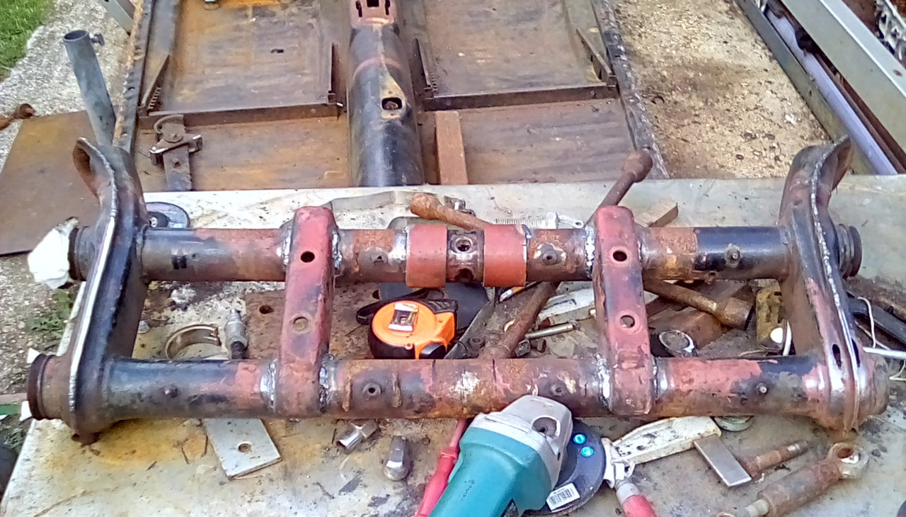

Weld and weld some more part of the fun of it
After another cool day for welding clear the drain holes in the bottom of the shock towers  then with it upside down spray hot waxoyl in and rotate the beam to ensure it goes everywhere, it will slow the condensation rotting it out again.

I did cut 1" out of the towers and clean them out why I was at it  . . I will fill them up with red oxide drain them and wax oil. it is now all seam welded up as well.

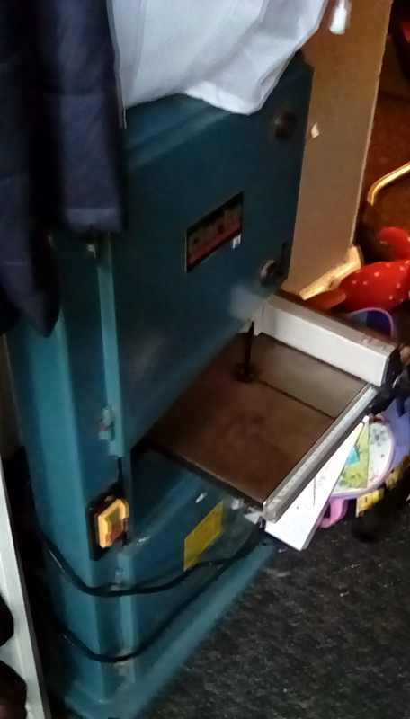

My dad pop over and had a look :D at the week end.... I live! a mad life with a family to match :) Now I have a lathe etc at my mum and dads but it is 13miles away :-[ my dad asked me why I had not made some of the bits I needed... All I did say was time" and you got my lathe :-[ and it is to big to go in my shed.. That was Sunday I got call Tuesday  and was told to come over with an empty car thats all :-\ . 3 lifted it in to my car but only one got it out😩 I now have two Boxford lathes :D and a bandsaw that came with it ....All a late birthday present from mum and dad...Next! I will have to say milling machine

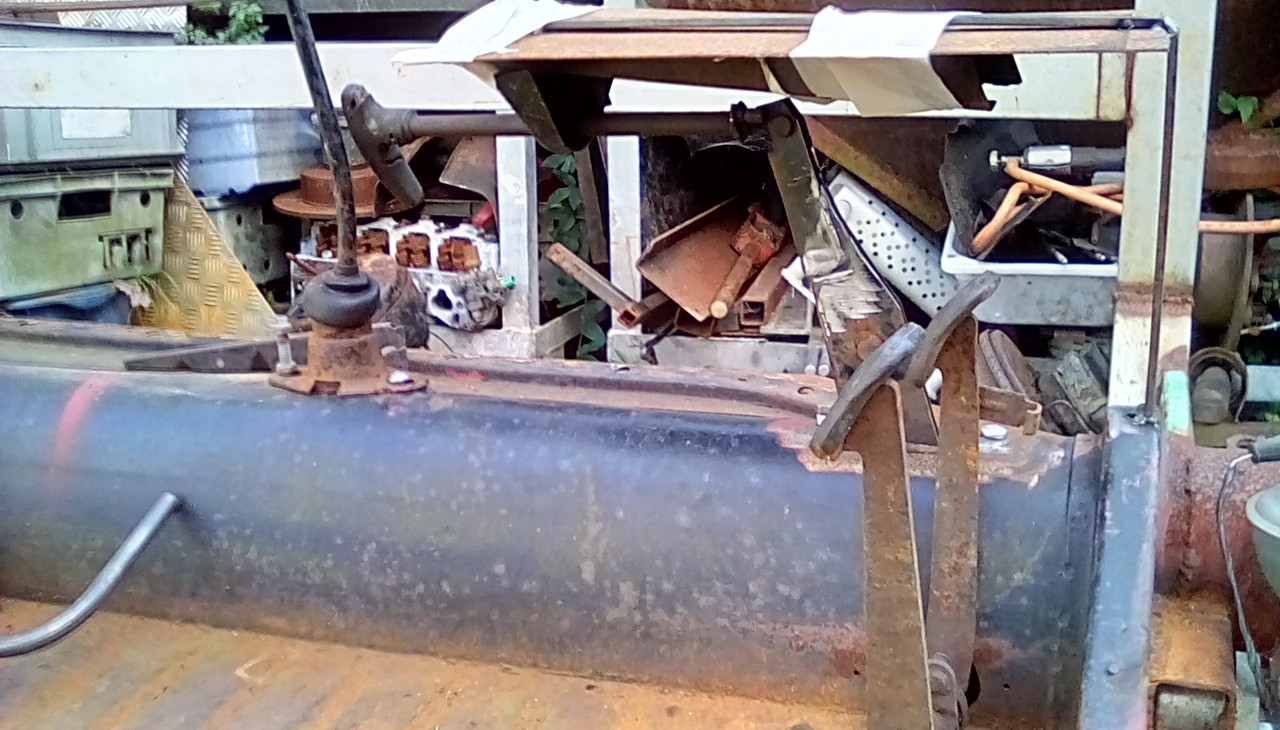

Kids are at school so back on with the build.. It would of been less work to cut a hole in the seat for for the hand brake..
umbrella handbrake there is a reason they died out ;D that will be a lot of work for the cables and mechanism but nice to see ideas out of the normal box.
