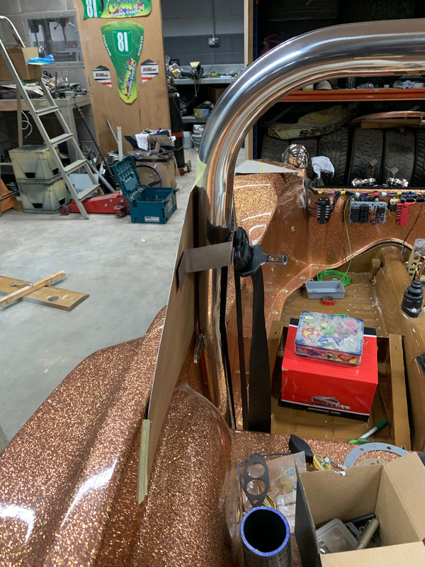

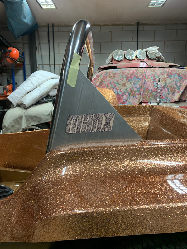

The roll hoop is not really strong enough as the upper seat belt anchor so this is a mock up I have done which will be laser cut in 3mm 316 then tigged on, this will then be bolted to the shell then an outer bracket down to the upper shocker bolt.
Work hard : play harder

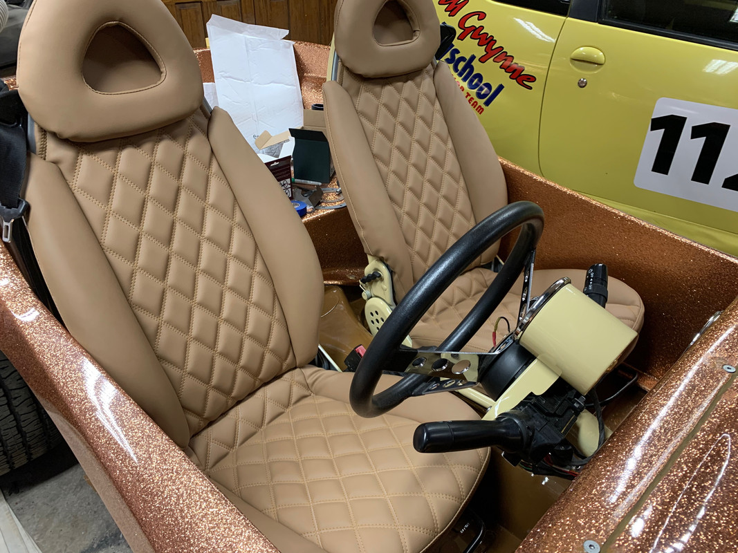

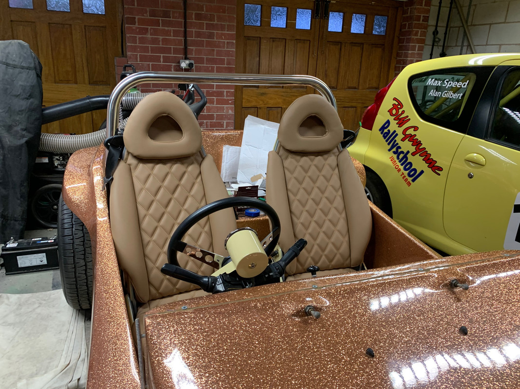

Seats have now been reupholstered comfy too  :)

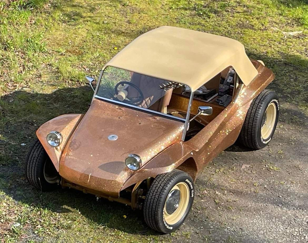

Not been on for quite a while as rallying has taken over again but with a couple of months grace, picked up the roof today from Rob Kilham.

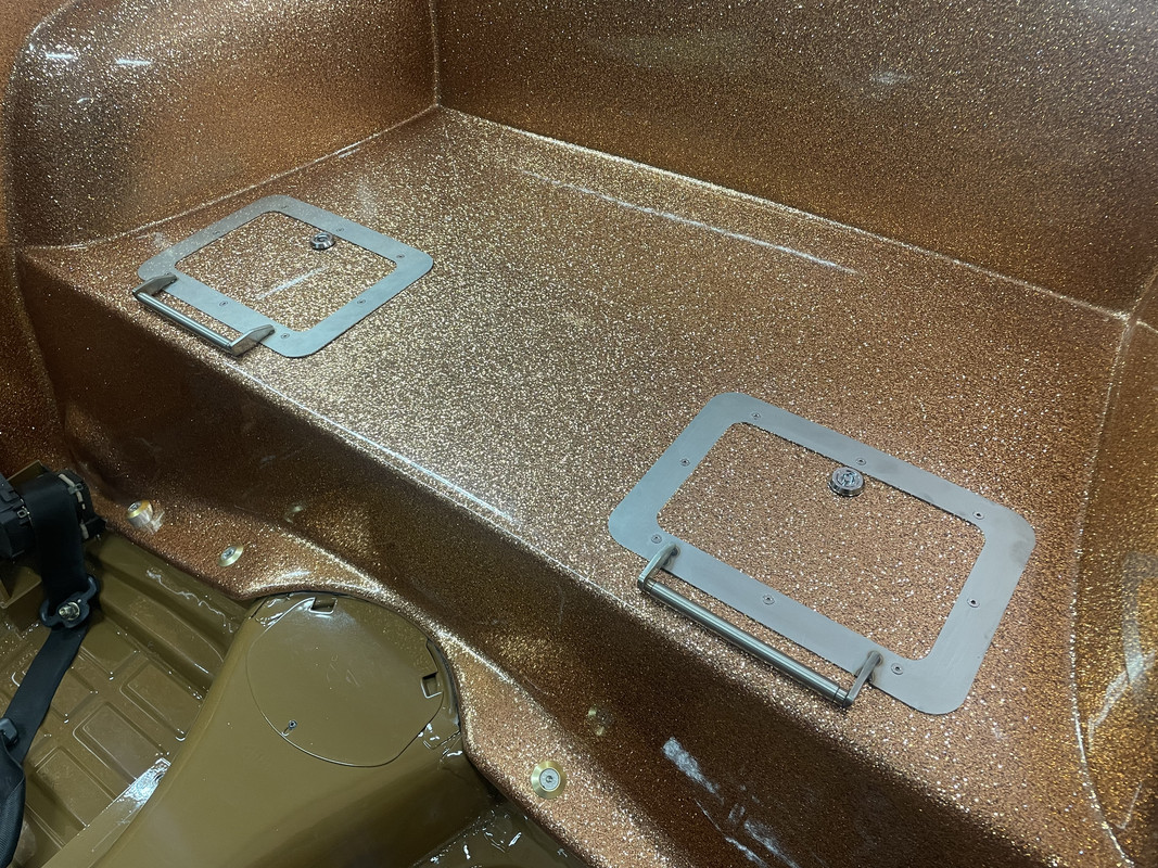

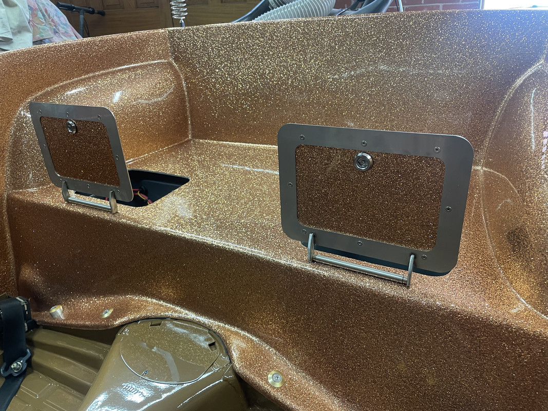

Battery box and tool box lids done just need to polish now

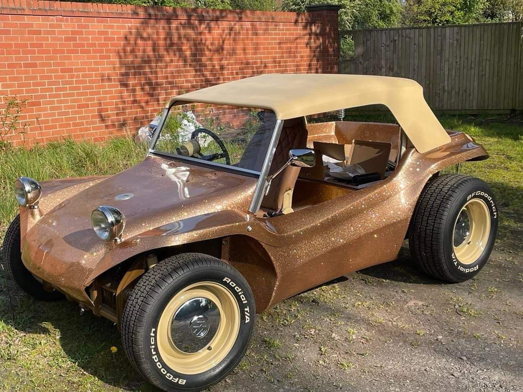

Rallying season is now over and the boy does his Alevels next year so no rallying for probably 12 months
This time the buggy is getting finished   ;D Into the business end waiting for tinware to come back from the chromers

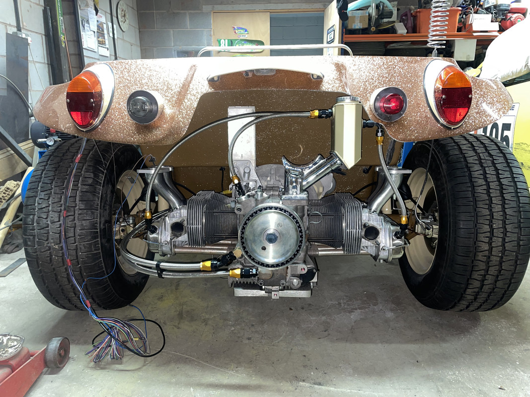

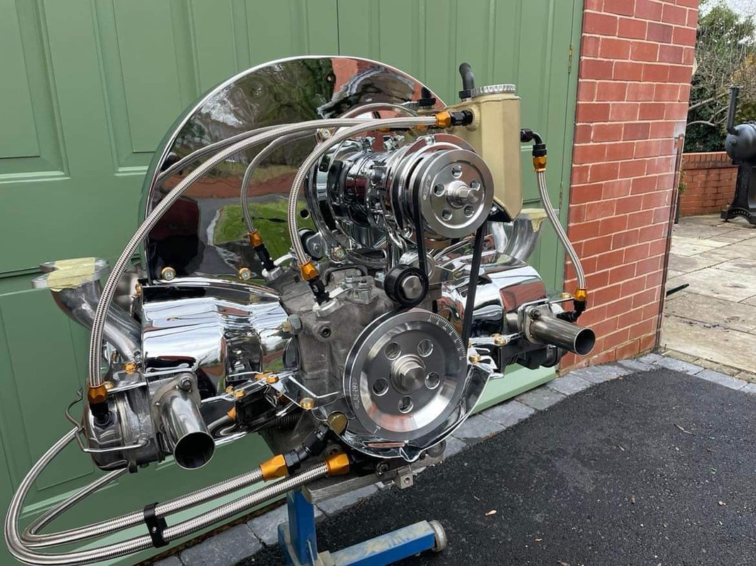

Tinware back from the chromers
Posts: 11,803
I guess that engine isn't going rallying then  ;D
Looks amazing  ;-)up
Posts: 5,011
Brilliant
Need sunglasses to follow you
