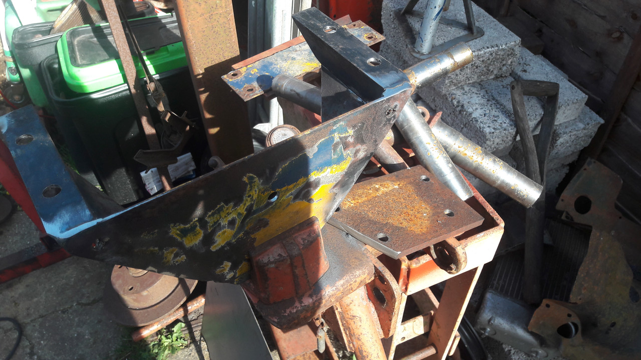

Back to the build :D and I'm going to fit a new frame head :) and sell the chassis ::),, Why as I'm going to cut the frame head off and the back end off a good chassis,, I have a good irs back end and I got a spine and frame head from a buggy I had 15 years ago and I may as well do a flat floor and loss the pan rim at the same time and get a clean body to pan look :D why doing all this I hope to drop the body 1" over the spine and lift the rear maybe 1" I'm lucky as I got a flat boot floor only thing that may stop me is the engine fan top hitting the body, I would build a box-tube chassis but time a money ,, If I can do the chassis and airlift all the bits like roll cage, turbo engine, can be added on over time

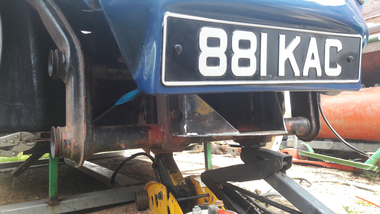

Rain stopped play today :( but in a way we need it ;)  The chassis parts and engine-gearbox are from a Q plate buggy,I strip years ago as no one woud buy! it,, And as I will all ways mot my cars and I can tax as I need it on line now why not use it,,:D

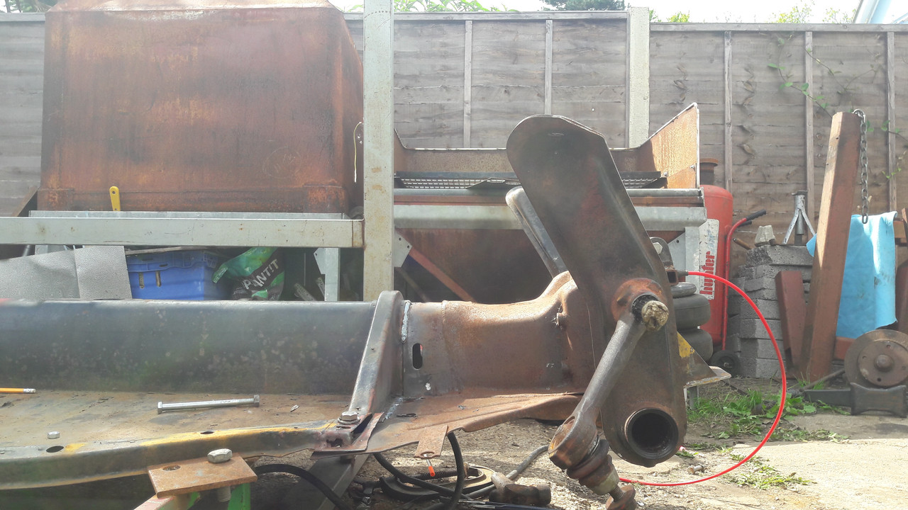

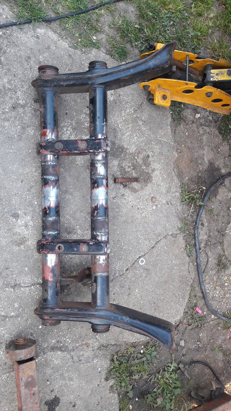

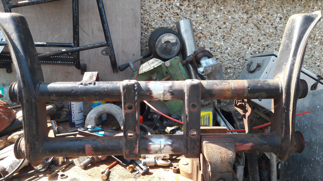

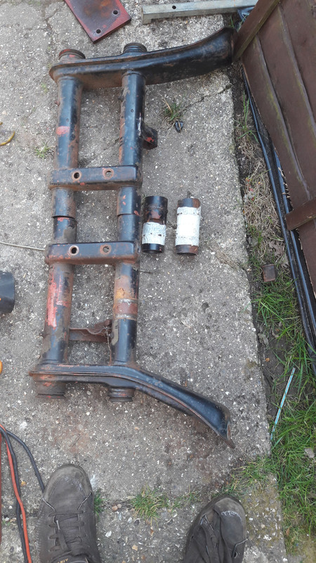

I got ok to work on the buggy at last  :D Front end 5" ::) narrowed beam but will have drop spindles, discs, wheel adapters, so it will be only 3"! overall I was going to buy 5x120 pcd discs but it is less cost for new discs and I can go back to 4x130pcd etc if need be at any time,
I do some things the hard way as like the beam Yes it would only take money to buy a bolt on made one" but "cookie-cutter buggies have no soul",,
I did cut 5" out the middle weld and then I cut the uprights off that is a pig of a job! makes for a stronger beam! and I do not like beam inserts bleugh you will see no beam adjusters I will come to that next post

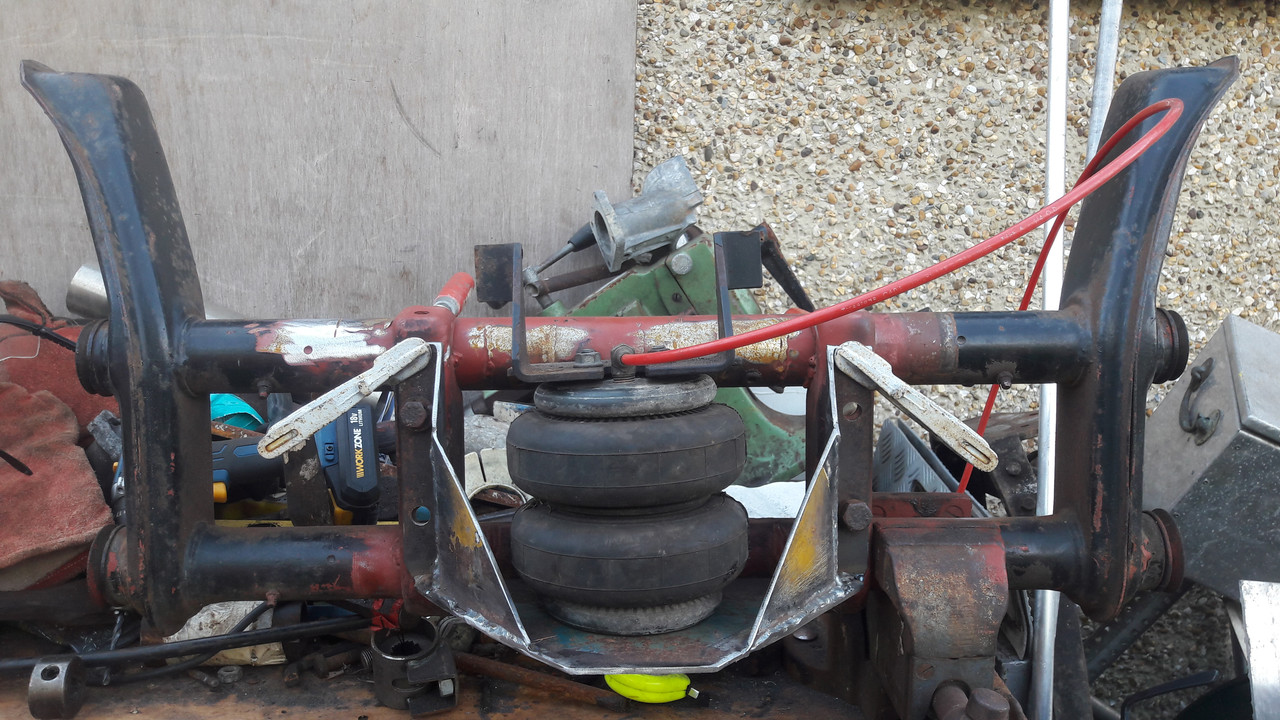

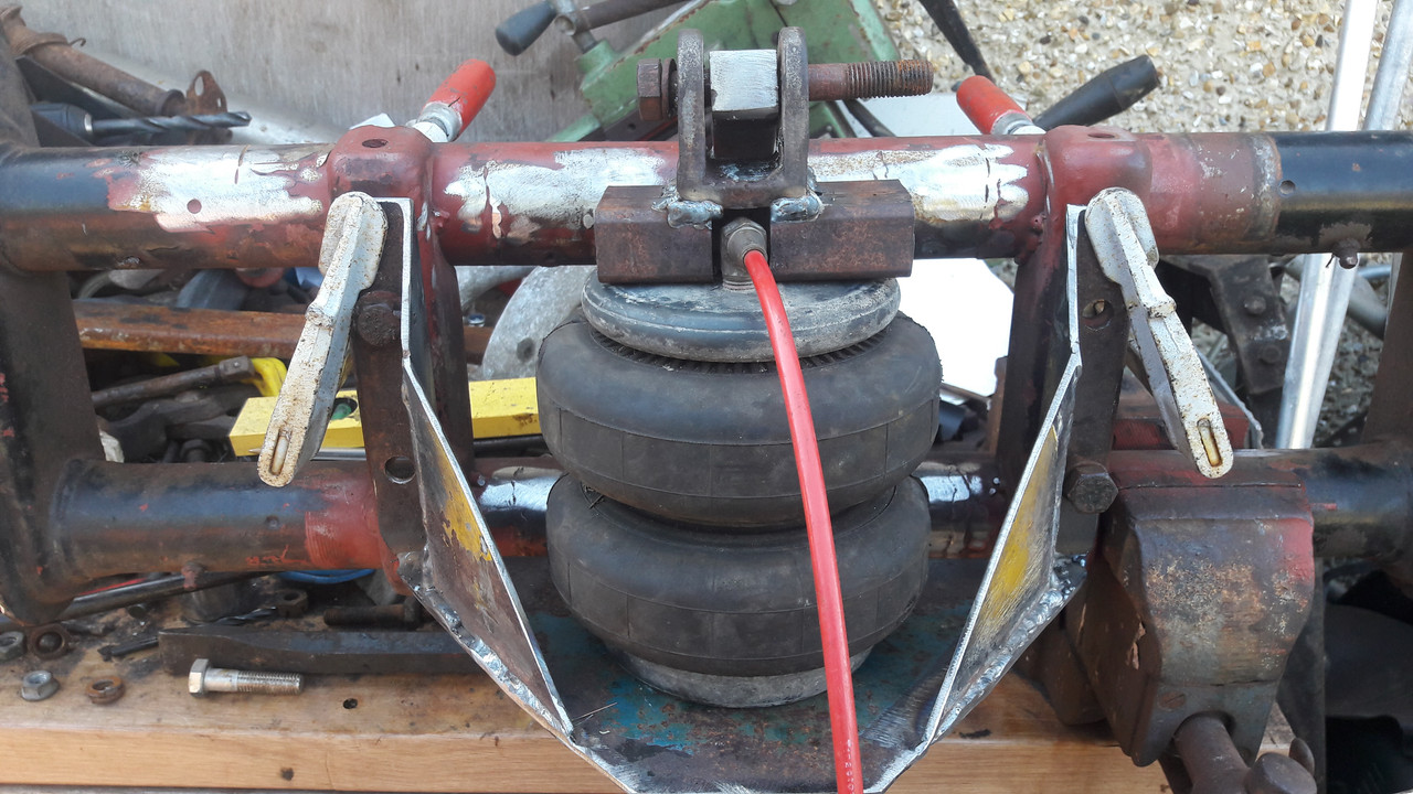

Why no beam adjusters! Over the years I have had lots of vw's and the best ride has been coilovers but good ones like avo's are over £400!! a set and my buggy Is not for racing and I have only seen one buggy on air shocks and I think airbags are best! ;-)up,, I do not know how this is going to ride or if it will work as the wheels may hit the body and tie rods may hit the tank an so on,,but it is all made from scrap so low cost!
it is worth a try and to save track rods how about a steering rack.

To days work ;-)up and lots of welds to clean,  It's going to be hit and miss: :) how it sits as I still got torsion bars but I made the airbag mount bolt on so I can drop or lift it if need be?

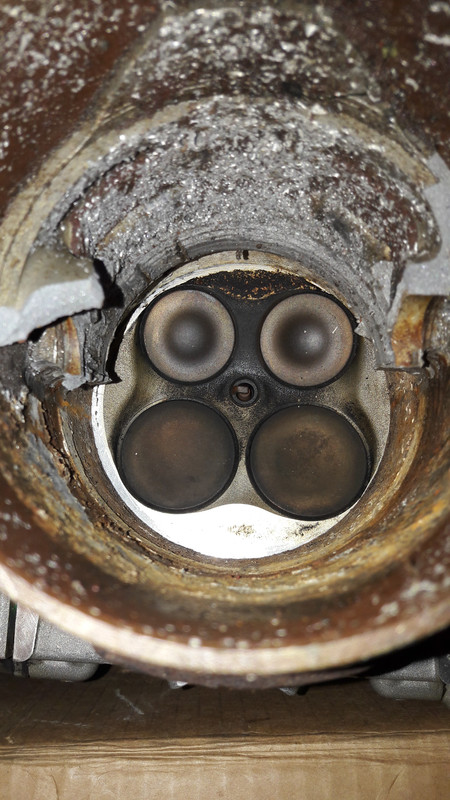

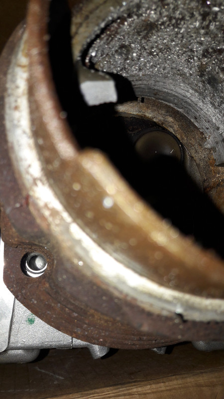

I got sent 2 heads today :D I will need 4 of them for a project 16v type 4 engine I'm building,,It may go into the buggy if it works???????? its a good start as head stud pcd ;-)up sorry bad pics
A 16 valve type 4 so will it be OHC and belt driven. Keep us posted of this involved project motor.
Posts: 11,802
Intrigued - and watching this with much interest   ???
What were the heads from?
