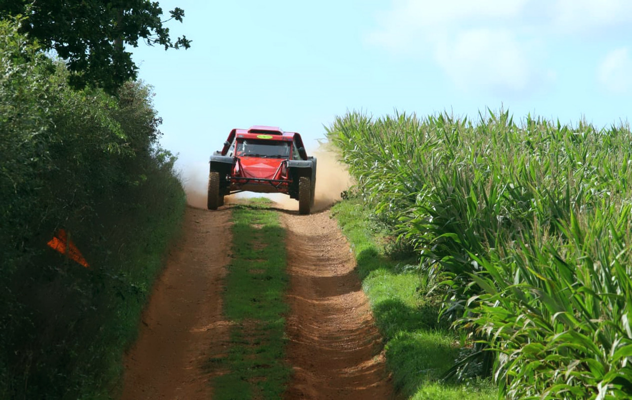

Excellent fun way to check if all the nuts and bolts are correctly tightened.
Bet its quite tiring bouncing along a course like that.
PhillipM
Posts: 534
Comp Safari Rail
Location: Rotherham
Oh yes, 2 days of that my back and kidneys were killing me

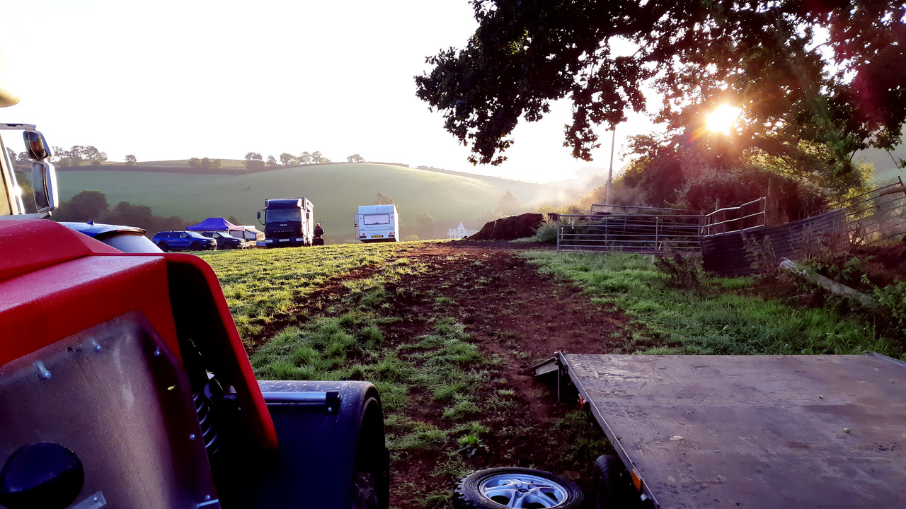

Trip to Tiverton after some mods to the front end, car feels far better now.
