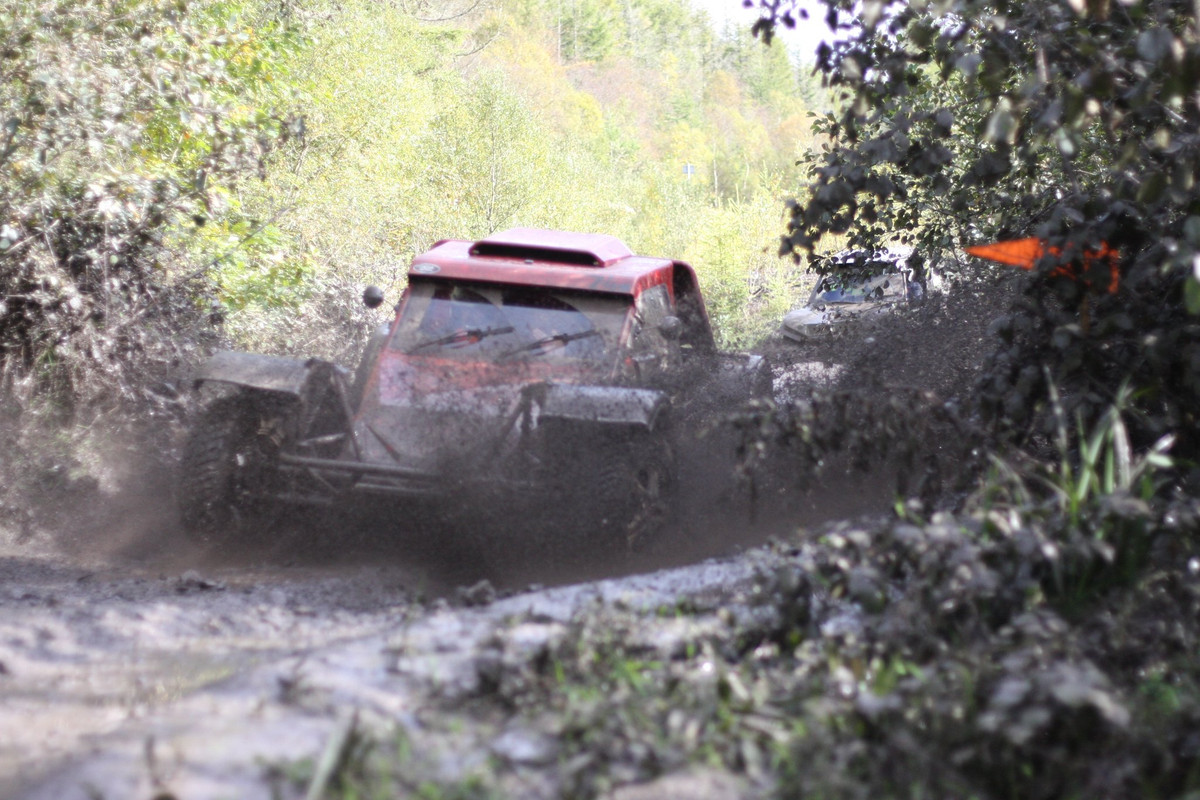

Cows got a free show then.
Looking pretty clean and fired up.

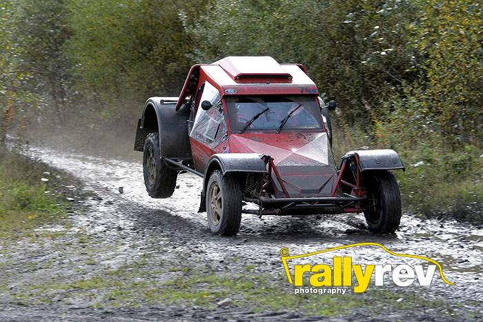

Thought the car sounded a bit loud at scrutineering - got louder through the day, then started to get a ticky rasp like an exhaust leak. Checked the backbox and the ceramic wool had blown out, couldn't work out why, but I think we found it...
Few more pics too:

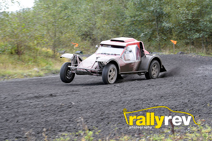

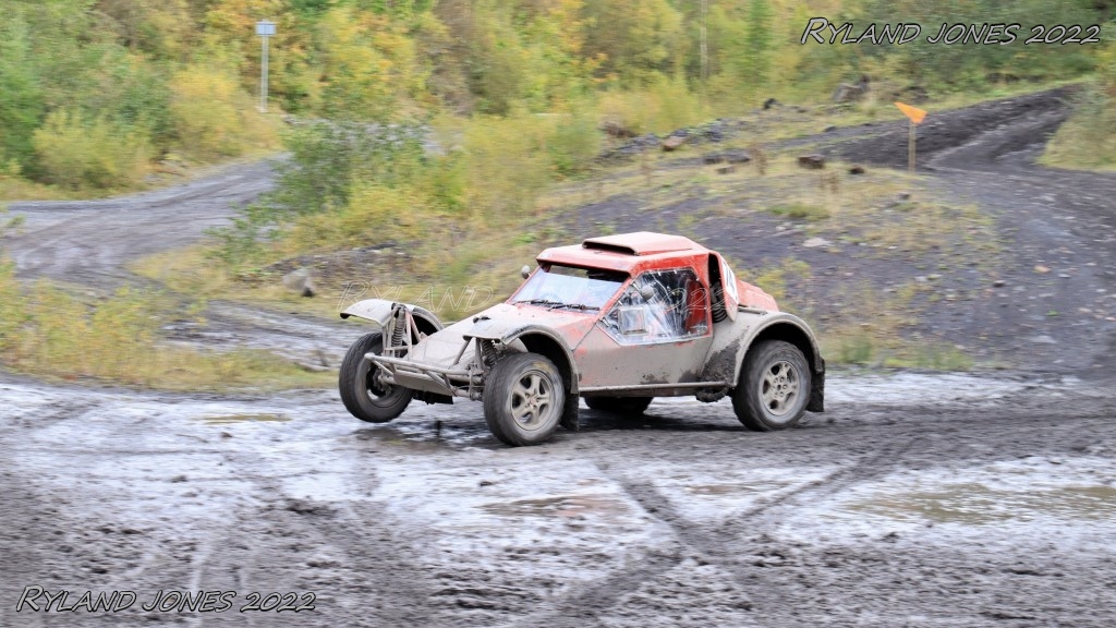

Okay so - it was a mixed weekend, incredibly slippery the first day - felt like the car was on ice, no grip anywhere - I bet anyone watching thought we were out for a Sunday drive from the outside, it was like driving on marbles, some of the downhill corners you just couldn't touch the brakes and it was a case of just letting the car slowly slide itself into a turn without doing a 180* and heading down the the hill backwards after the corner.
However I made some big changes overnight to the damping as the new spring rate on the rear seemed to be okay, so I kept that and then went far softer on the low speed and rebound to suit - no big hits to kick the rear end up here so felt fairly safe to do so in the name of finding some grip and feel, and cranked the cracking pressure up instead to still take out the bigger hits - car came alive on the second day on the other course, we put a few times in that were top ten which was pretty good on such a fast, slippery course.
Doesn't sound too much but there were a lot of quick cars here this weekend, to put it in perspective some of the 4wd Canam cars that are fairly consistent across courses were about 60-90 seconds faster than us at the start of the year on a similar course length, we'd dropped that to 30 seconds by the second event, were faster at the last event at Tiverton by a few seconds and now we're pulling 30-60 seconds on them at this one - and matching some of the guys who are usually contenders for the championship on odd runs, which was a surprise even to us :D
We're certainly not front running pace, not even close yet, but this kind of championship is as much about endurance as pace, if we can get there and keep it consistently at that pace, it's boding well for some fun at least.

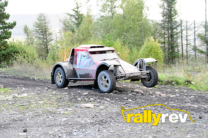

It's still very situational so I've a lot of work to do on the damping once I get tools to strip these new Foxes, to make them more consistant across more terrain, and we could do with finding some of the soft compound race tyres in the right size for the rear - currently we're on standard road tyres whereas most teams are on either soft grass race compounds or Michelin forest rally compounds, I bet there's a chunk of time there to find. Also need a bit more front camber we're on the edges of the tyre all the time even with 3* static on there:
