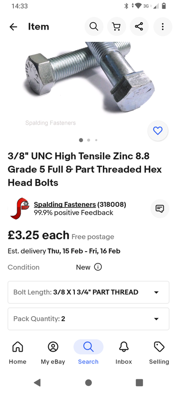

£3.25 for 2 with free shipping?

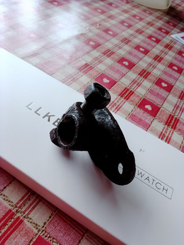

I found a flange if any good? When you say 'good internal threads' I'm not quite with you. They're smooth inside, the only splines are on the shaft, any that look splined have just picked up 'witness marks'.
Just message me your address of you want it.
Yes please mate - perfect   ;-)up
I didn't realise they were smooth inside - I thought splined to match the outer  ???
That makes my life even easier then - PM incoming   ;-)up
Thanks for the spot Krug, but most of the aftermarket ones seem to be made from cheesium which is why I was after a genuine one.
Now solved thanks to the kindness from ManxDavid in sending me one to play with   ;-)up

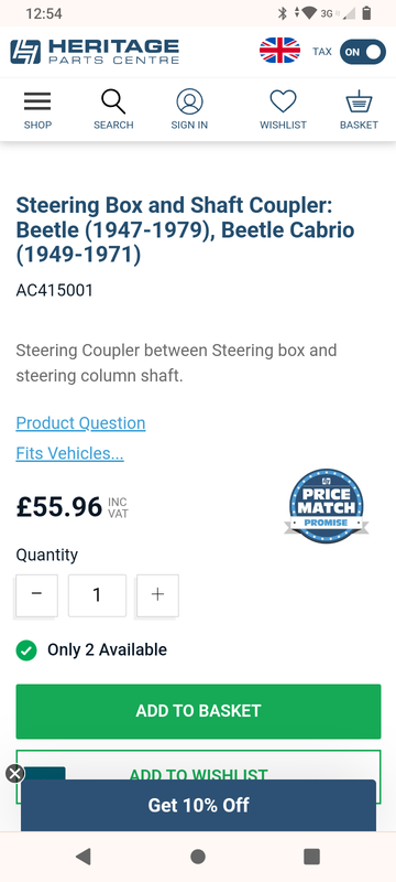

How much???
'kinell!!!  :-\ :-\ :-\
Parts prices are getting silly 3mm x 22mm screws for indicator switch £2.50 each I got 12 plus postage for less than £8
