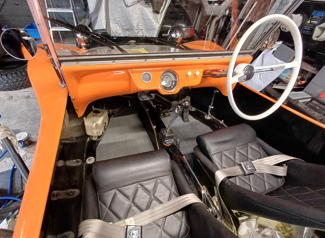

Thinking I will stick with the basic "Meyers" style interior.  I have the matching rear seats.
Don't know whose dashboard that is but it suits the original speedo really well.
Empi gear shift was a pain - bent lockout stop and endless adjusting to prevent accidentally getting reverse.

Good news then the wufe cannot get on with aftermarket short throw gear levers a cut down standard one works fine.

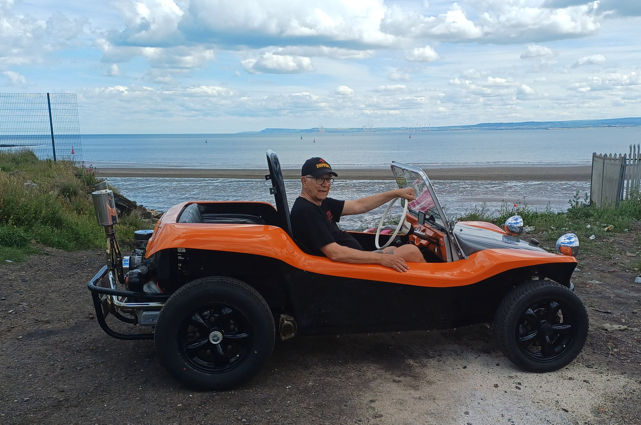

Body sits high as has 2" box section around floor pan (helps when you are over 6ft tall).
Originally had 33" Mud Terrains on the back hence the clearance but past experience suggested 1641 and standard gearbox would struggle to turn that tyre size in everyday traffic.

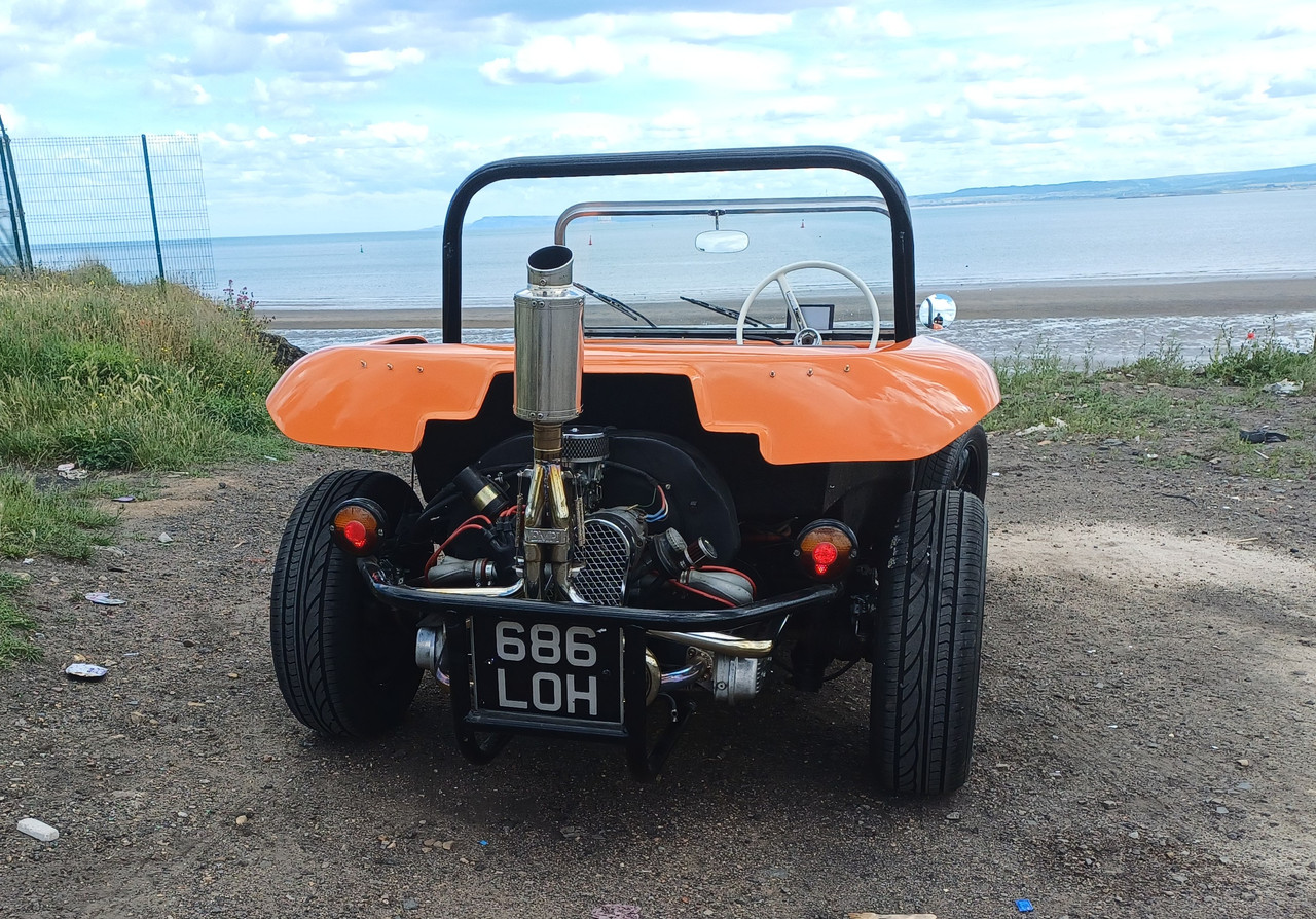

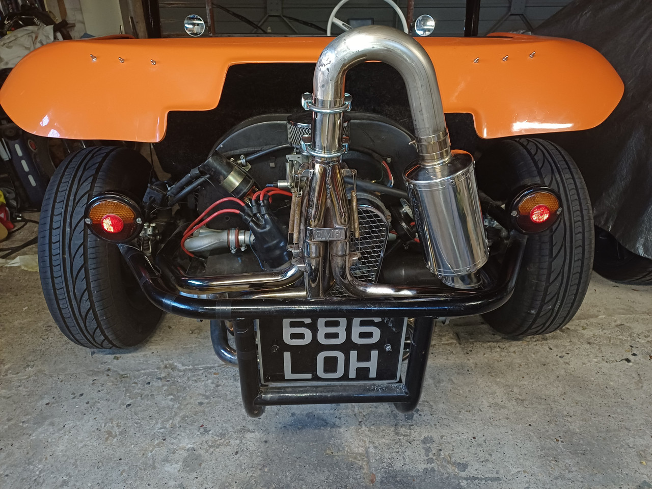

Modifying the exhaust to get rid of the "periscope".  Keeping everything within the engine cage.
Tidy and less of a rain collector.
