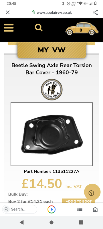

Do you mean torsion bar end covers by any chance? These?

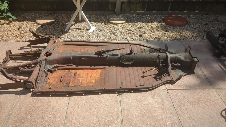

looks like you need a swing axle gearbox and front beam 1968 on,  4 stud wheel pattern and a set of wheels to get it at least rolling

Have to do the metal work first, just got the new floor pans and frame head, will be working from the front to the back when it comes to the suspension side of it.

Quote from: Warren on July 17, 2024, 05:08:05 PM
If you are doing frame head I would recommend finding someone who can either lend you a jig or getting someone with a jig to do it.  The replacement frame heads aren't known to be the best fitting.
Nor are they structurally strong.
Patch welding an existing frame head is often stronger and easier than a full replacement if the original is not too far gone.
Agree on the repair but if a new one is unavoidable like one I did weld then new one up first before fitting and you need a front axle fitted so you can get all the measurements correct and get it aligned if you do not have a jig unless you make one before cutting the old unit off.
