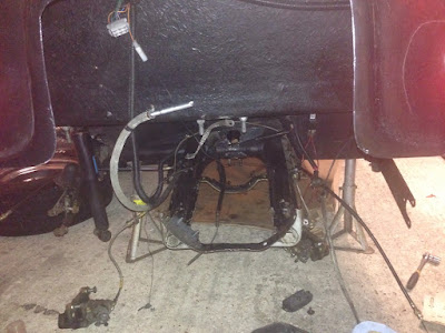

I've started on it, got the gearbox out, borrowed a car and ran that down to Cogbox on Monday.  Spoke to Peter down there and asked him to look it over and stop it leaking, that I just wanted something reliable that I don't have to think about.
Last night I removed the front brakes and will pull the front beam ready for a swap.
Also working out a list of parts I need to replace, not too much, mainly just nuts and bolts.
Thinking about lifting the body off next, maybe over the weekend.

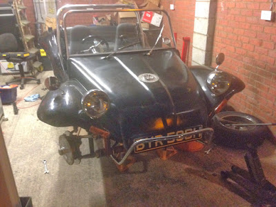

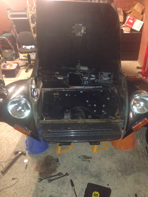

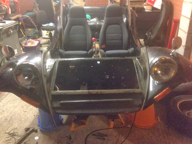

I got a bit more done last night, with a little helper at hand.

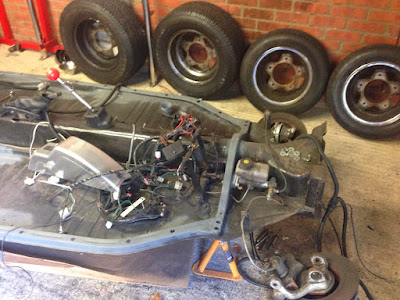

First was to remove the steering wheel, then finish pulling the front beam off.
With those out of the way I set about unscrewing the bonnet and removing my gauges out of the dash.
Bonnet out of the way I could pull the fuel tank which needs a bit of a clean up, but appears to be solid.
Just need to finish removing the rest of the wiring, which I'm labelling up as it's not been in there long.
I heard from Pete at Cogbox today and my box is about done, nice and quick turnaround that, just need to arrange a time to go and get it.
Hopefully I'll get enough time this weekend to lift the body and then I can start the rebuild.
I must remember to write a list of bits I need, plenty to do though while I'm waiting for deliveries.

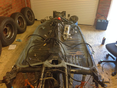

Did a bit more work this weekend, but haven't got photos today.
I've disconnected the loom, and done a few tweaks ready for a new dash side panel I'm putting in.

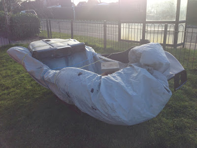

Roll bar is out and the body is all undone and ready to lift off.  I've got a friend over in the morning, so the shell is being lifted then.  It'll live outside for the time being while I check out the floor pan.
Should be the last of the disassembly, before I can start building up again.

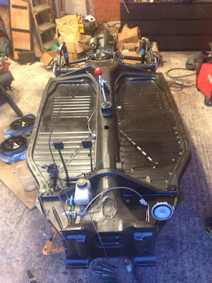

Picture time.

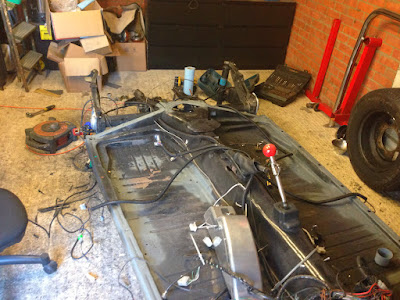

Stripped down to the floor pan and started cleaning up, removing the rubber seal between the body and the floor was a pain, heavy duty sealant had been used to hold it down

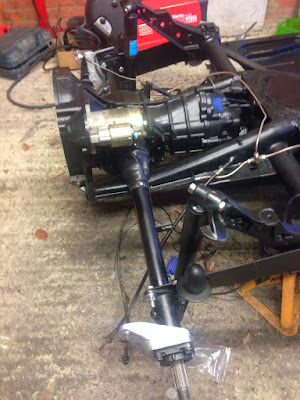

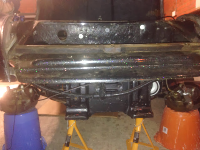

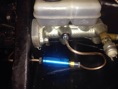

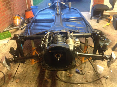

Floor pan welded and touched up with paint.  The gearbox back in place and Kunifer brake lines going on, also added a little unit to retain 2psi on the rear brake pressure.

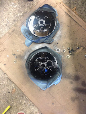

Painting up the front of the rear brake discs

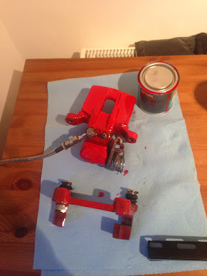

Painting the rear brake callipers too, after smoothing them off.

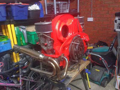

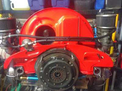

Also rerouted the fuel lines, moving the regulator to the rear of the engine.  All the lines are now R9 7.6mm.
