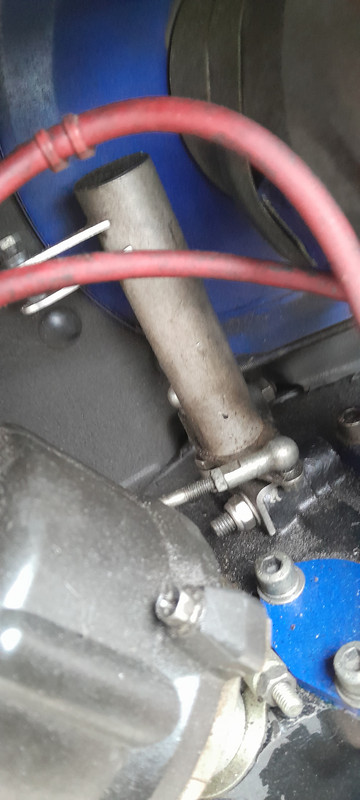

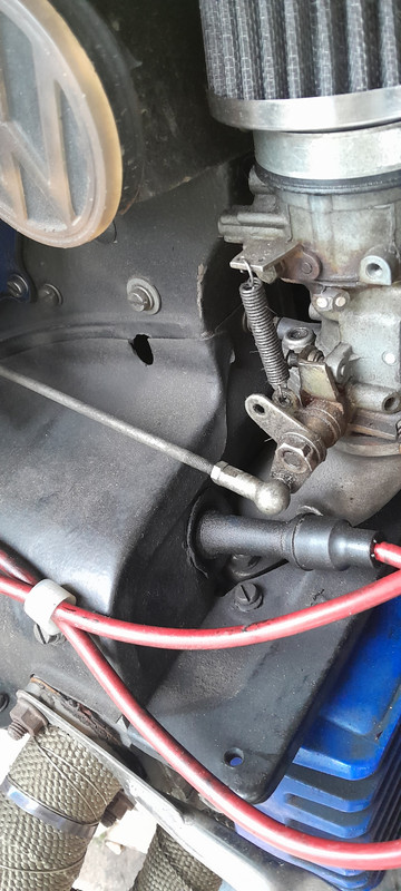

Here is my hex linkage
Couldn't use it as the lift arms for the carbs fouled the body.
This is what I use so the arm runs under not over the alternator
Not brilliant pics but you can see how it works
