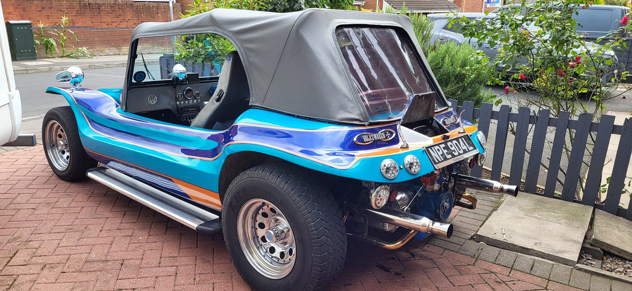

Totally with you on this - there are basic guides which help get close, but the ultimate set up is very specific to your engine if you want it spot on.   The carbs Brookster is referring too were originally on my buggy.  They were set up on a rolling road and were spot on.  However when Dave put them on his he has a very different set up.  He has protected his filters from heavy rain and this changes the airflow.
Krug it will be Interesting what happens when Dave fits those rain shields , when i tuned it they were not fitted  . If it starts running rich when they are fitted we know why ( reduced air flow )  ;-)up
