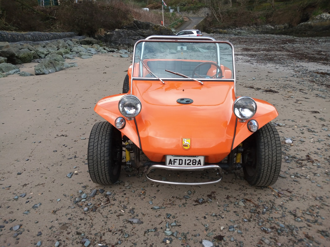

what wipers arms are everyone  using   buggy has late beetle arms at moment but   need replacing but to gain extra pressure on screen they have been  severly bent    would I be better of with   1303  arms or is there something better out there ,  years ago I used   a set   where you could   extend the arms to different lengths    and held on with grub screw but was never really happy with them as they used to work loose  over time

the  beetle ones I have are longer than on my 2000  air cooled  beetle   fitted with 11  blades, problem I have is on sweep the  bottom  part of blade is   riding over the bottom of windscreen frame     plus they have been bent   to   increase pressure onto the screen
