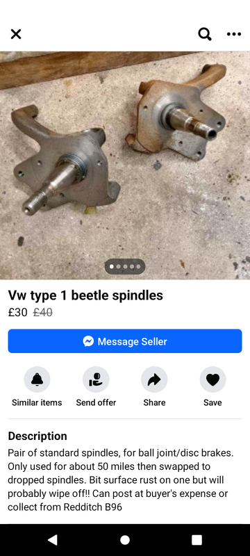

I know I am using a set of "Borrowed" short shocks to get me started with some height measurements, but those hubs do seem to sit very high up into the arches, so I have just bypassed my cornflakes and gone out to fit a wheel - and I am not happy as I do not appear to have any suspension travel at all without the wheel physically hitting the wing. Something has gone drastically wrong here.
Mandavid's comment has saved me a lot of head scratching here though as he has spotted and commented on something that I had not even considered. It appears that I have been incorrectly sent a pair of Powder Coated LOWERED spindles instead of standard ones that I ordered and I have lost two and a half inches of travel. Didn't spot that one and could kick myself for assuming that I would have been sent the same parts that I had ordered, especially as they had been customised in blue as a special order.

Your problem is possibly that Eva Resto are aimed fair and square at the low brigade not buggies with big tyres, fit some standard hubs and sell the lowered ones summer is coming and you need to be on the road.
Cheap as chips...
All sorted and I am now the proud owner of a pair of complete hubs from this donor Beetle. I think that the discs and pads were replaced just before it was laid up as underneath the surface rust, the pads look new and there are no wear marks on the discs. Been standing a while though as the back plates are disintegrating as we speak and it looks like I have left a long trail of brown breadcrumbs going back to the garage.
In fairness to Dave Fisher, he rang me earlier in a bit of disbelief that this could have happened and I think he had a few choice words with Max about it. I think Snoopy is right though that Max is so used to dealing with lowered cars that everything goes out with dropped spindles, irrespective of what you ask for. Anyway, Dave is shipping me a brand new set of spindles as we speak, but I think I am going to strip these rusty ones down first and see what I can do with them as I would far rather renovate some genuine parts now and try and limit the use of some of the aftermarket bits where I can.
