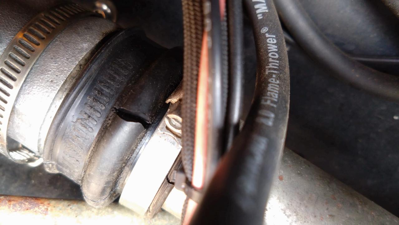

After a great weekend at the Rutland show with the buggy running perfectly, started it up yesterday and had a misfire on the engine from the left hand side cylinders
Checked the plugs they all appeared ok, then looked at the rubber gasket on the manifold and rotated it to find a split on the underside, superglued it closed and the engine started perfectly. New ones on order. Motto always look for the simple things one at a time.

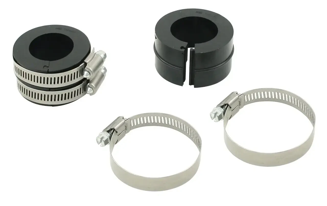

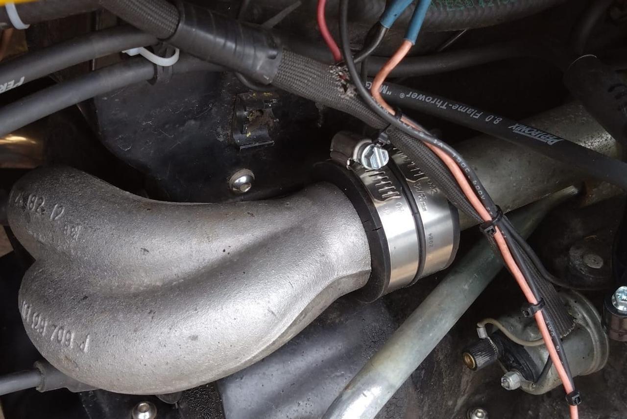

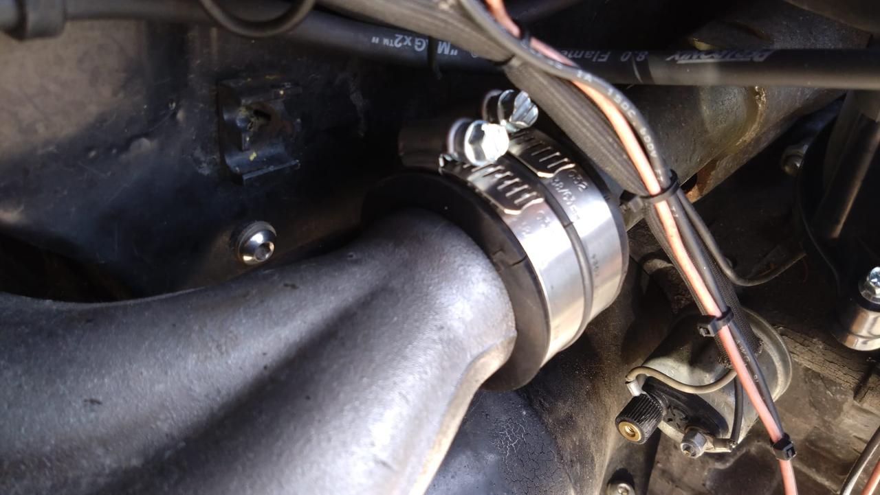

Quick and easy repair done using EMPI split gaskets from Just Campers, no stripping out of the manifolds  ;-)up

Took the buggy out for a 25 mile run today to check everything ok. I had to replace the LHS heat riser pipe as the original one would not fit with the inceased size of the gasket. Luckily I had a spare pipe from a different manifold which is bent closer to the manifold so giving more space for the gasket  ;-)up
