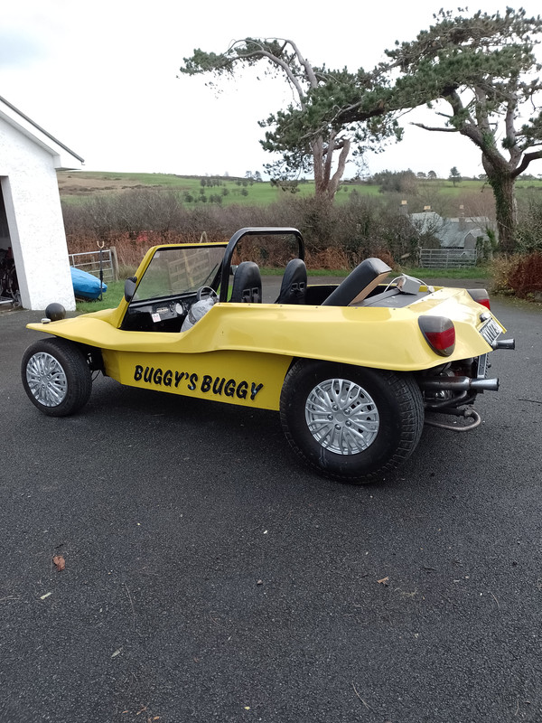

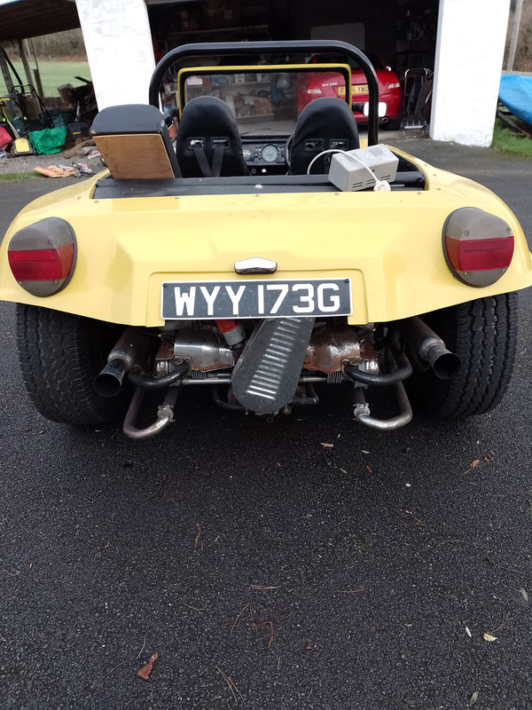

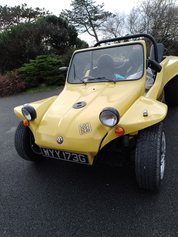

Hi All,
We have  visit from DVLA on Monday 19th Jan. They don't believe our buggy is Vintage!
I have the Chassis number which matches the V5 document but if I can say how old the body kit is will help.
Can anyone help please?
Thank you
Alan & Simone Stein
Wales

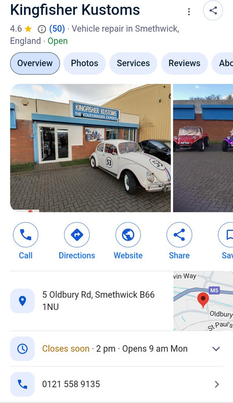

The awkward thing is it is believed that the moulds still exist in the hands of Kingfisher Kustoms in Birmingham but I don't believe that they've actually had any moulded in the past 25 or so years. Maybe a phonecall to Dave Fisher could confirm that fact at least.

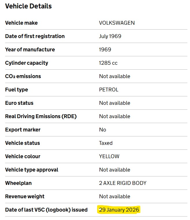

Well some thing has changed a new V5C was issued on the 29 January 2026
Chris : On the road since 2005
Well that is good news it must have landed on somebodies desk who knows the system.
