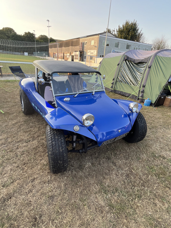

I've made it to Swanage FC by the skin of my teeth and have a problem that I am hoping the collective expertise here can shed some light on.
My buggy ran perfectly for the first 2hours (75 miles) from home but then started a misfire... 3 cylinders OK, don't know which, one not. This developed not a full blown stall. Breakdown service called and he removed, cleaned and replaced the plugs. Another 5 miles and the same thing again. And again.
Every time it gets hot, and under load, sputtering and death. I made it as far as Swanage and called into a local garage where a lovely guy explained that he thought it sounded like an HT lead issue. As it was Friday afternoon and he already had a full workshop, he lent me a a multimeter to test my existing leads , telling me that anything above 8ohms was bad. All leads were below 1.5 ohms
I set off from Swanage FC to test it out after tightening up the threaded ends of the HT lead as suggested and five miles in, same problem.
My (completely uneducated) gut feel is that it's a fuel problem but having Googled it and spoken to a few people it could be the coil, plugs, or any number of of other possibilities. :'(
Where would you start, based on the fact that I'm miles from home, have almost no tools, potentially have a cruise tomorrow and the carnival on Sunday and need to get home, preferably not on the back of a recovery truck...
