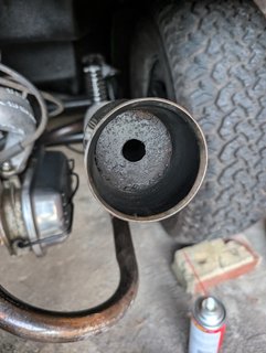

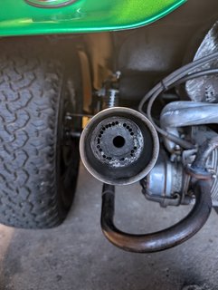

Sorry but I have another question  :D . My exhausts appear to have restrictor plates in them, one has clearly been badly drilled.
Should they be there or should they be open?
Posts: 841
Should be open, maybe someones neighbours moaned  ;D That can't be doing it any good at all
Posts: 11,250
Those look a bit if a restriction the exit hole needs to be the same diameter or larger than the inlet  if you want more performance a bit of back pressure is good but the engine needs to breathe freely
Mark2025
Posts: 14
LWB
That's another thing on the list of previous bodgery then  ???
I'll be removing them straight away.
