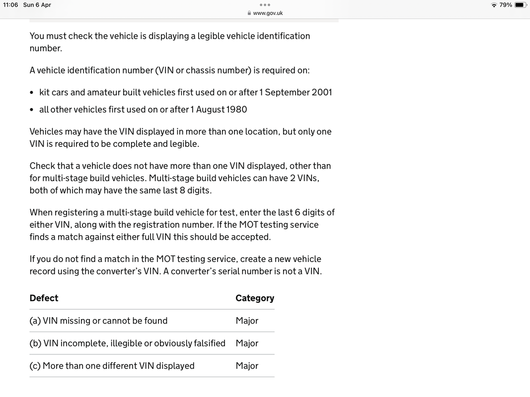

You do not need a chassis number for mot as the VIN is for certified build vehicles the mot manual says.

Quote from: redbug72 on April 06, 2025, 09:56:32 AMWhat if the chassis was rusty and rotten where the vin number is making it illegible so had to be replaced?
OK, possibly entering into a grey area here, but I had the same issue on mine where the VIN is quite difficult to make out due to the amount of paint and rust that has been applied over the years. It can be seen, but it is certainly not easy to read.
I bought a blank chassis plate and stamped it with the number and then attached it elsewhere in the vehicle with pop rivets - following the rules regarding chassis plates that says they are not allowed to be removed with hand tools. My mot guy initially checked that this also matched the correct number as stamped in the chassis and each year thanks me for making it easier for him to check at mot time.
