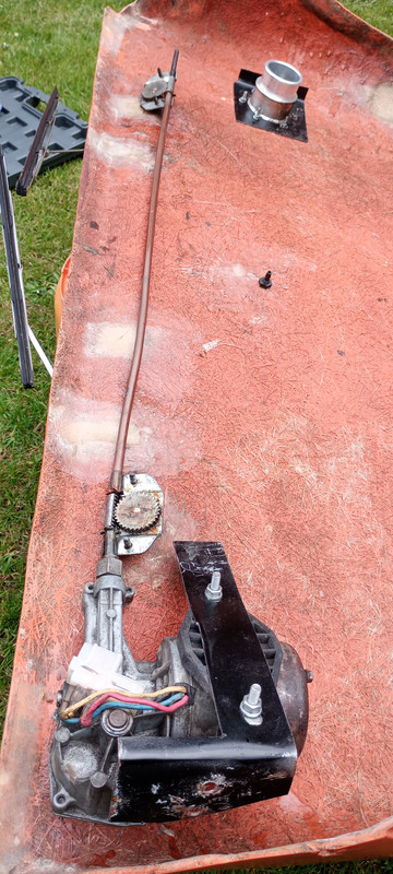

I have a Lucas set up.
It allows the motor to be out of the way of the speedo...... assuming you have a centrally fitted speedo.
As you can see it is currently in a free bits as I'm re-greasing the wheelhouses/worm screw (whatever the term is)
I had a whole world of pain trying to get the self park to work (due to me not understanding how they were supposed to be wired in!!) and ended up just turning the wipers off where I wanted them. It is actually handy when the sun is reflecting off the stainless steel wiper arms to be able to move them a bit.😁

Yes I can understand that. Being of ancient design, and fitted to hundreds of thousands of UK vehicles over the decades, the principle is definately old school. Very simple when you know what wire goes where and the fact a single relay can operate both speeds.
