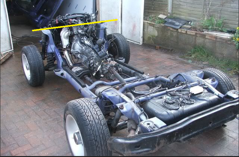

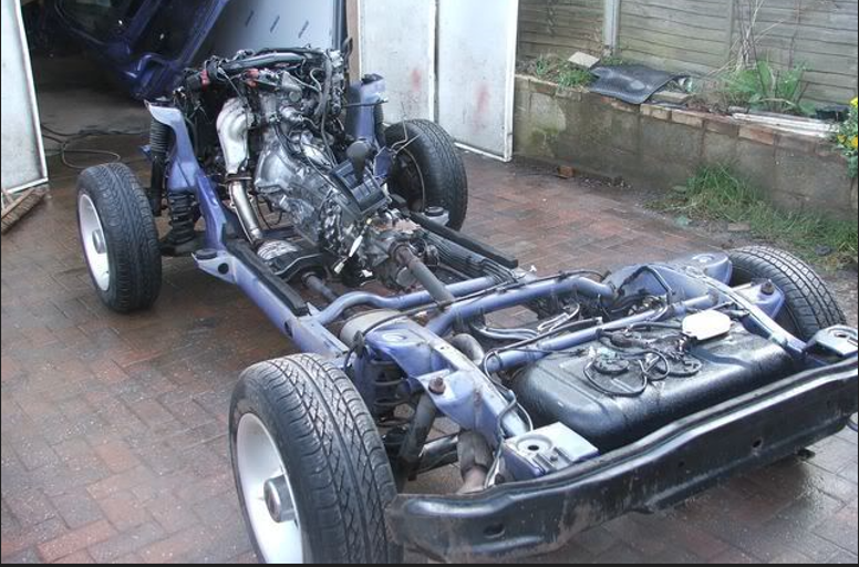

its my intention to at least try and make a beach buggy somewhat like the original manx style fit on an alternative chassis, not that theres anything wrong with the beetle base or engine its more a case of i have a few suzukis kicking around the place and i would like to us them up,  so a swb vitara or X90 chassis  looks like this
its low in the middle section giving me a fighting chance of making a body fit and look somewhat standard
clearly im going to be front engine and rearwheel drive, this probaly means the front bulkhead is going to have to shuffle back a little bit  but firber glass is easy to work with so i dont see a problem,  next issue is the front suspension suspension towers on the chassis dont quite fit under the front wings they sort of sit right on the inner wing edge where the bonnet  meets the wing, if i cut and narrowed the front of the bonnet  then extended the wings inward to compensate for that then it would work ok, i doubt any one would notice my bonnet was 2" narrower at the front edge,  i have placed and order with FF buggies which will be due for collection shortly  but in the mean time i bough a second hand  buggy shell to chop about  and play with  until im sure its all going to work as i dont want to be hacking about a brand new shell,  plan is to make this a completely standard chassis with a stock 1600cc engine which is 105 bhp and then try and get the V5 amended by dvla to read buggy or similar,

so my height restriction is the top of these suspension towers, the engine can easily be lowered down till it below them
you can get the engine way down  which i will as it will lower the transmission tunnel thats running down the centre  of the vehicle

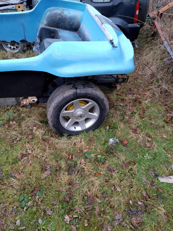

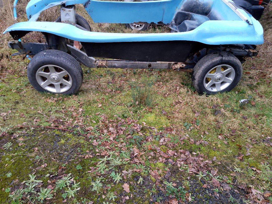

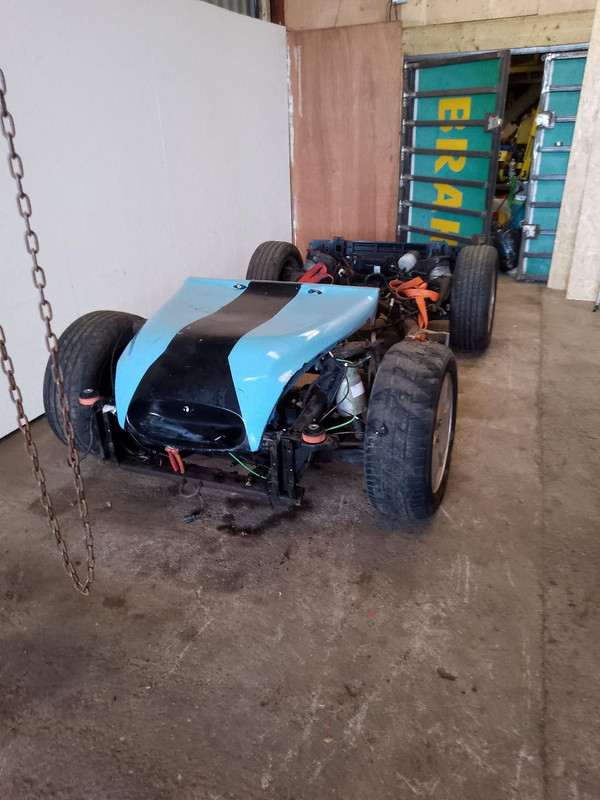

so heres the second hand shell i will be starting with
i will cut, modify and shorten this till im happy with how it sits then decide if im going to take a grinder to the new shell

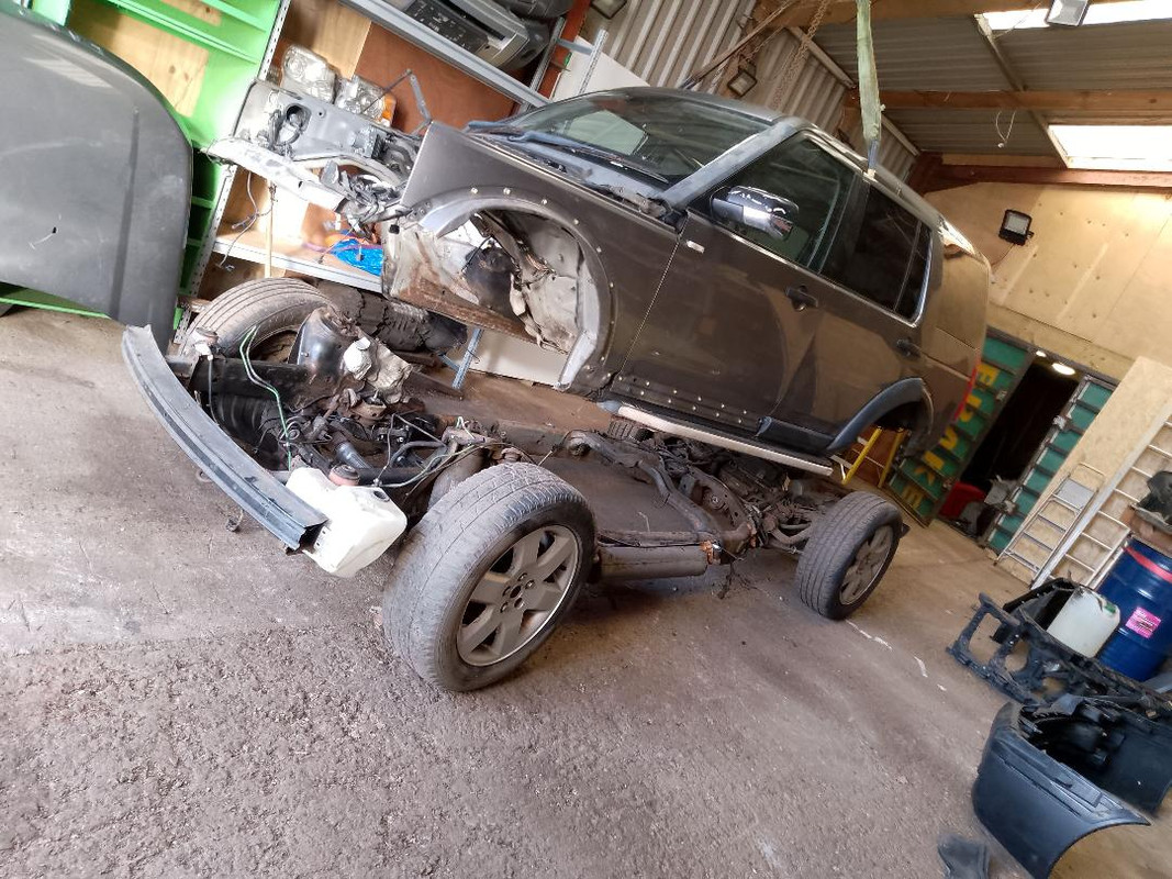

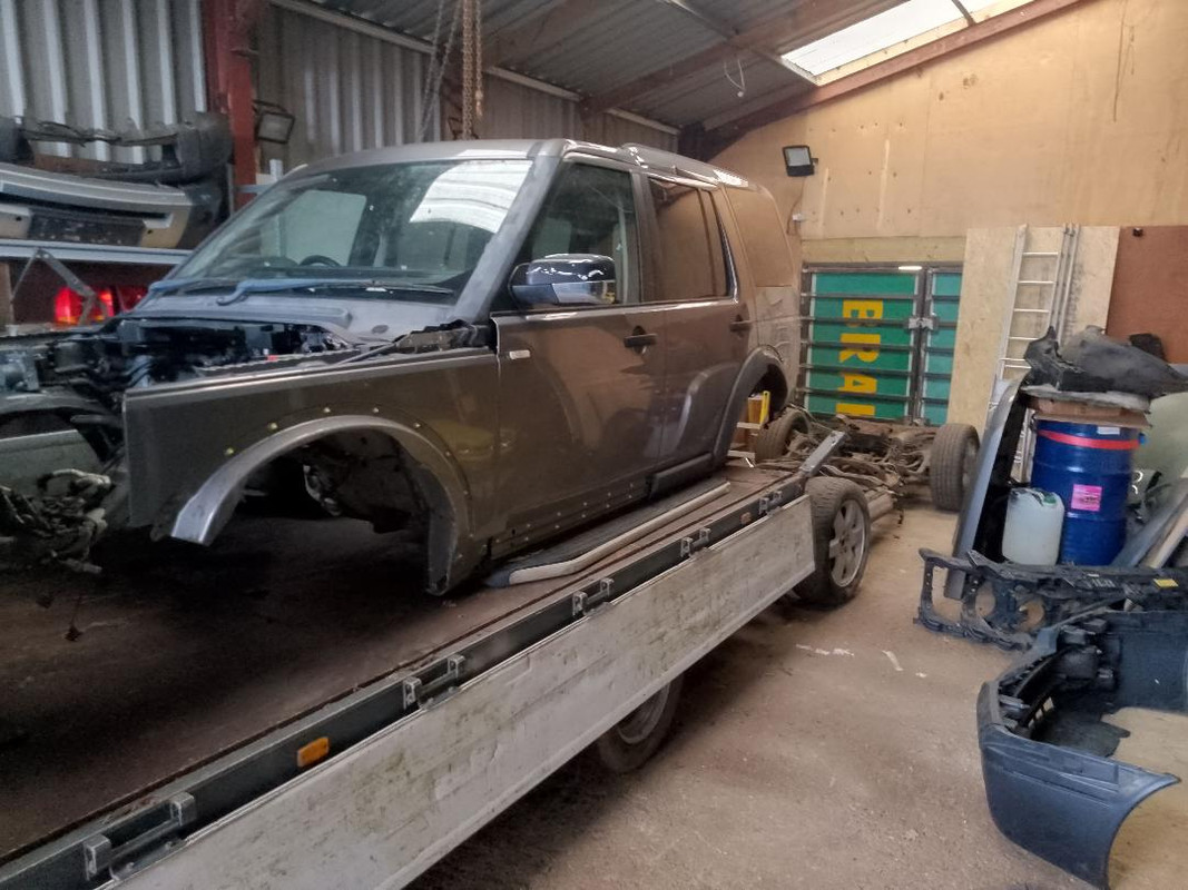

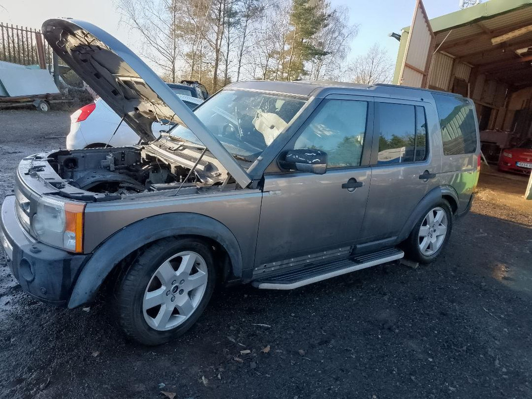

anyway back to progress, this biuld thread is going to jump about all over the place as there are 2 buggies, i was suppose to be working on number one first  but my pal dropped this off outside my workshop door the other day,
its blocking the entrance so not much choice but to push it in with a tractor, so this is the running gear for buggy 2
then it was clogging the workshop up so i thought i better try and make it smaller
onto the back of my truck and off it went to live a new life as bake bean tins

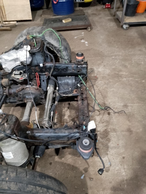

so that left me with this
but at 114" wheelbase its a tad to long for a dune buggy
i had to do a bit of thinking about what length i wanted it in my  view lwb look to long and swb look just a bit to short so i decided on 87" more or less half way between  the 2  its also what a suzuki vitara is  so my bodies will be interchangeable between chassis

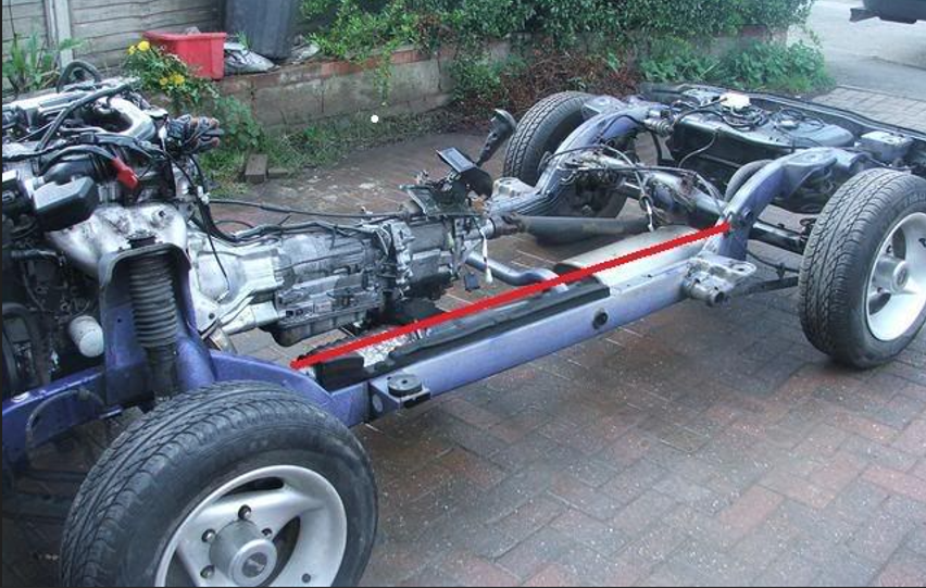

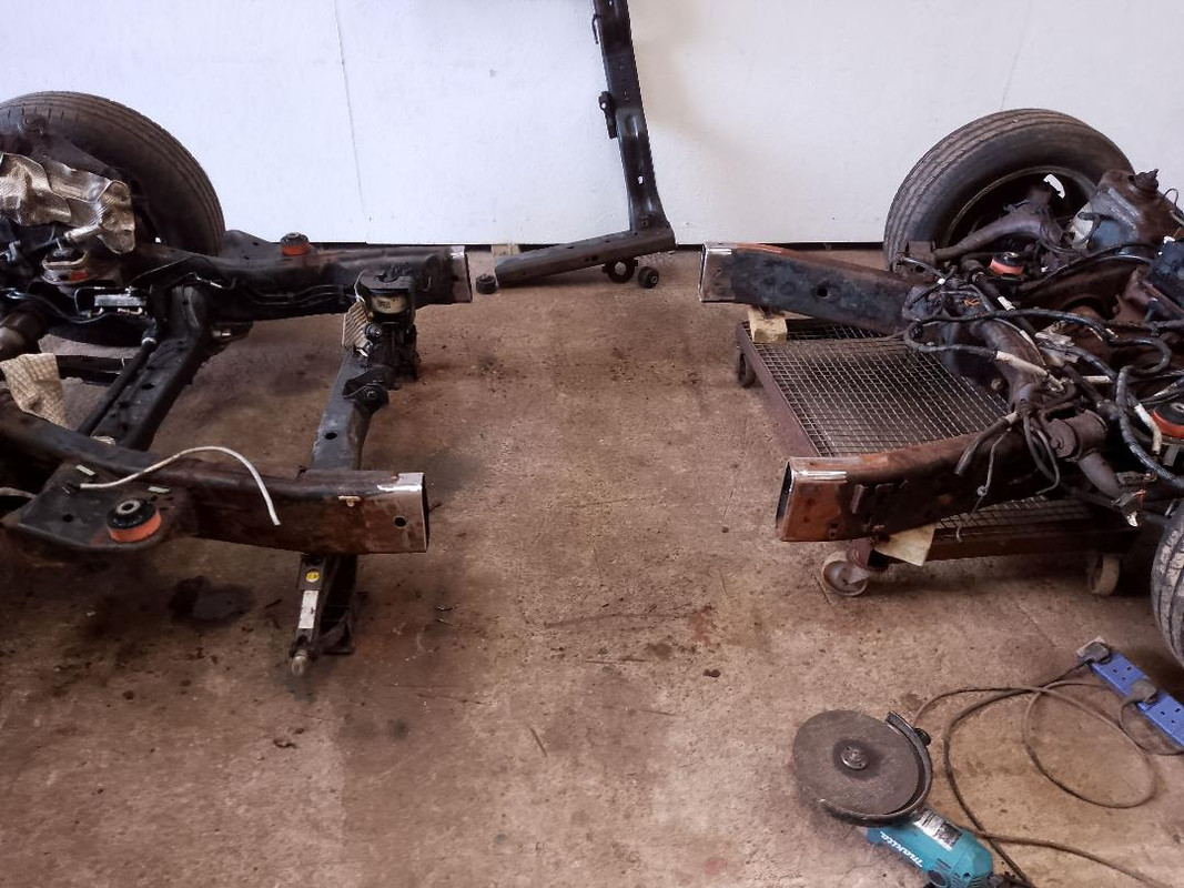

now that rear overhang just has to go  i cant be doing with that

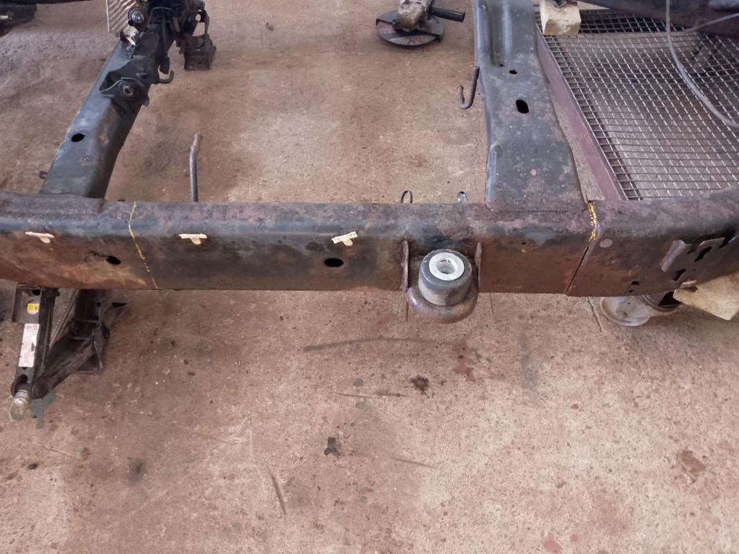

and here you can see the yellow  lines showing how much i want to cut out of the chassis
the rearward of the 2 lines is right on a manufacturer's joint  front section slides inside the rear section so joining them back together will be simples

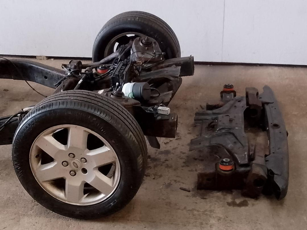

i re used the rear bumper section which is just tacked back on for now, i need the body on to see exactly where it wants to be and also when this chassis goes to the shot blasters it will go in 3 sections to make it easy to handle, then it will get finished welded

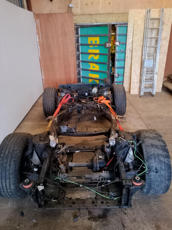

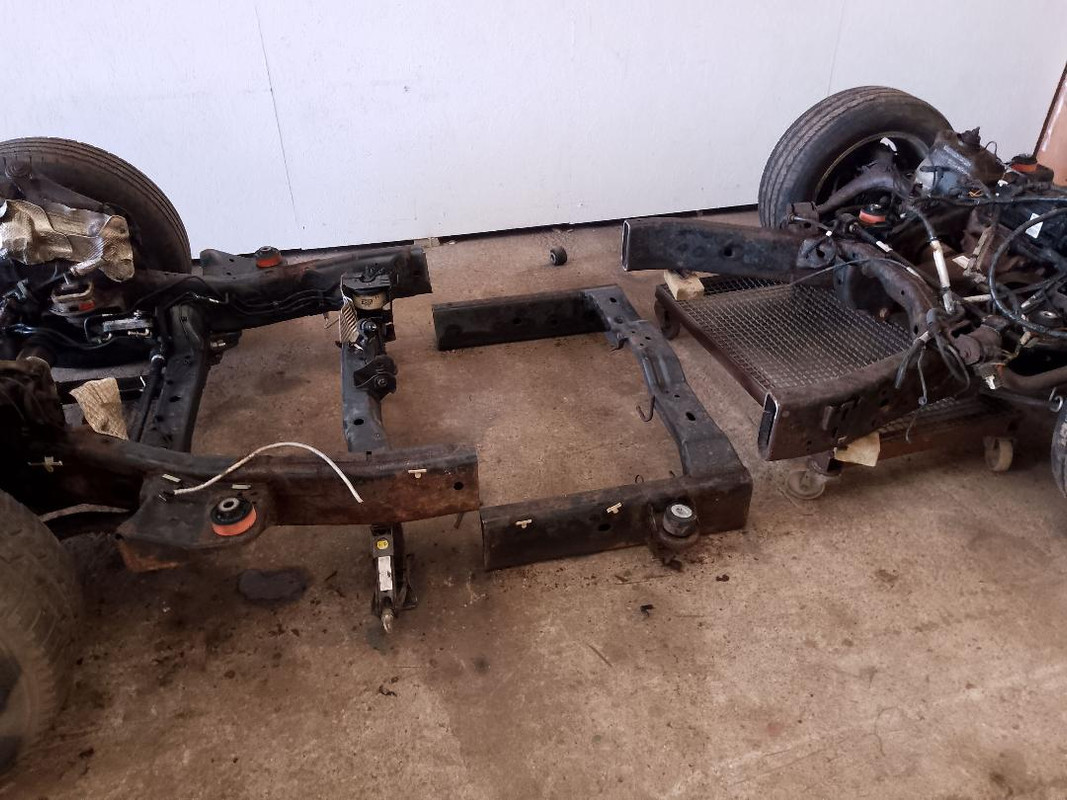

then it was time for the centre chop
baloo
Posts: 128

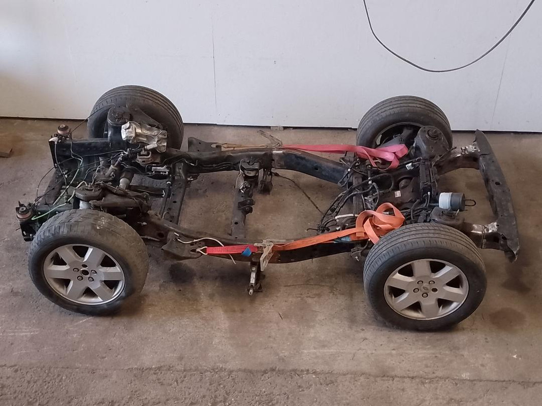

#10
2 ratchet strap pulled the 2 halves back together and forced the front chassis up inside the rear section till my marks aligned,  will get a temporary weld for now until its time to split it back into 3 for shot blasting

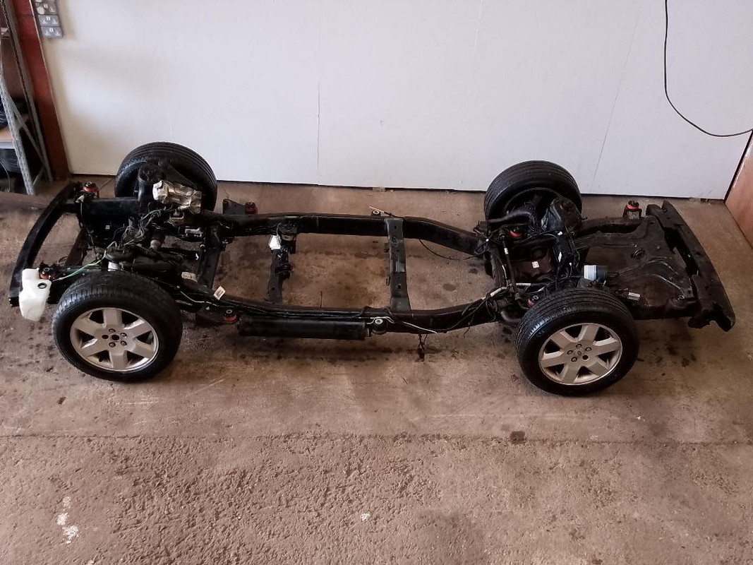

Posts: 128
#12
so there we have it a buggy size disco 3 air ride chassis, its quite curvy when viewed from the front, ive ordered some push fit air line fittings so i can work the air bags and see what the range is like
