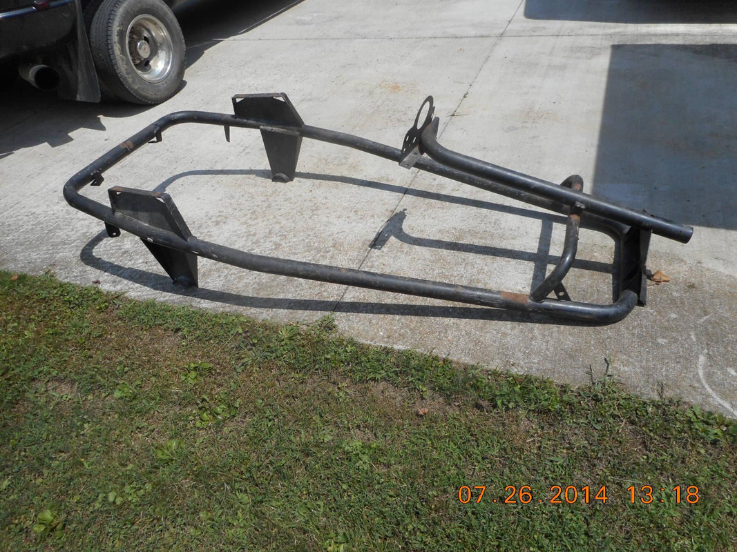

That rear bumper and cage like tubes on the back of the yellow one looks great Far better than the usual tubular cage

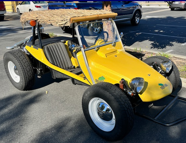

slighy going of track here but as i hunt around the internet researching different shapes of "beach"  buggy i keep coming across these , called a tow'd i believe ?
does anyone know if there is a uk supplier of these body panels ?, it might be an idea to use up the beetle chassis that i have in the shed
The Meyers Tow'd was never sold in this country, two clone kits were imported a while ago ago and the body panels from one of those get listed on eBay occasionally.
Tow'd didn't use a Beetle chassis, it had its own custom tube frame.

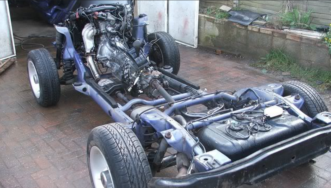

Posts: 128
chassis looks like this with the body off
baloo
Posts: 128
you can see there is no front diff or driveshafts on that pic  also there is a big space under the sump where the front diff should be on a 4wd version , the limiting factor on trying to get a fiberglass shell on to this chassis is the height of the front suspension towers, they just squeeze in under the front wings and then the bonnet runs up from there
im going to have to drop that engine and box down by about 6" to get it under the bonnet but by not having a front diff i have the room to do that, which i can do by altering the engine mounts on the engine and not the chassis

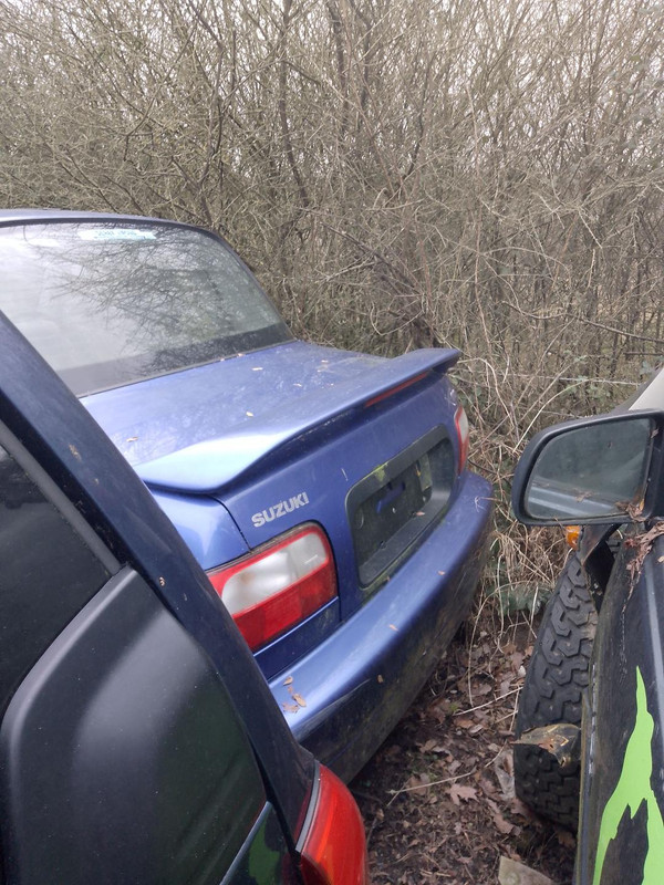

well i fell at the first hurdle lol

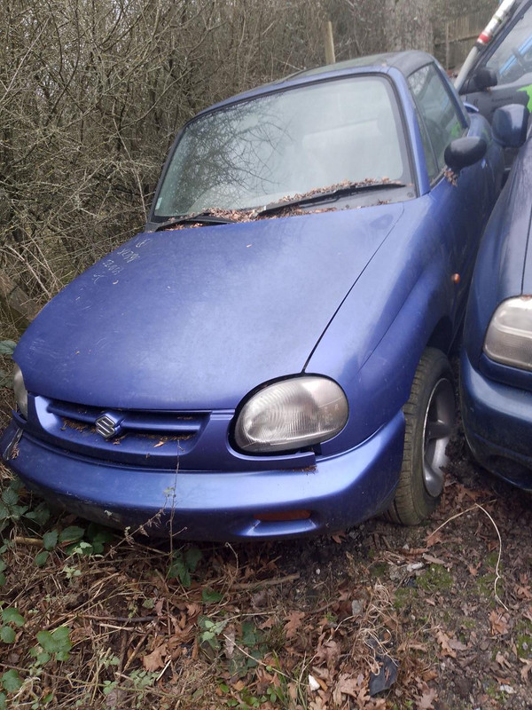

i started clearing out the yard behind the barn trying to get to "suzuki corner"
i managed the clearing out bit to get there

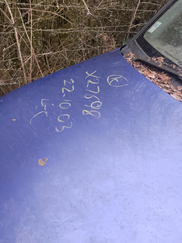

even found the X90 near the front which is the vehicle i was intending to base the buggy on
guess what no number plates on it, im hoping they are in the boot,  i bought this from a salvage yard i thought about 10 or 12 years ago  but looking at the yards description  still chalked on the bonnet it was 2003  ::)
wow time passes quickly  20 years ive had this thing lol
so if the number plates arnt inside it then im going to swap to another base vehicle, i dont fancy trying to explain to dvla why i dont know the reg of a vehicle ive had for 20 years lol
