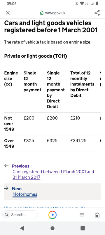

The only down side of a Q plate with a 1500cc plus motor is the £325 road tax but they are bullet proof as it cover undetermined age and model.

Quote from: snoopy on December 25, 2023, 07:34:54 PM
1500cc engine is in the lower tax band of £200 a year. A 1500 engine rebuilt with 1641 b&p's (who's going to check?) and twin 34ict's would be loads of fun in a buggy.

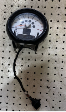

new shape mini pod with a rev counter and indicator lights, its appeal is that it would mount onto the column behind the wheel and its got a back on it already easy to mount nice and simples,  would have to convert the rev counter to a speedo  and re wire a few of the lights   but would be minimalistic and leave the dash free of switches/gauges,
light switches wipers etc are all on the column,  and you can get one for less that a tenner

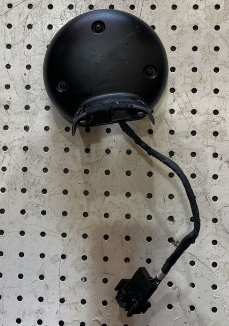

and if you want more info on the status of your engine then there is this version also

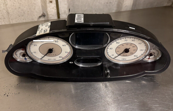

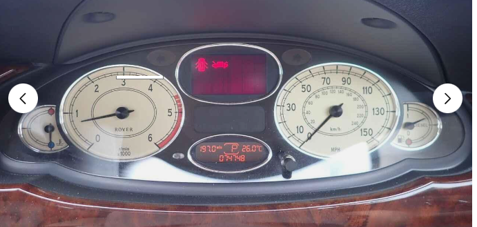

then i remembered there is a rover 75 dash on the shelf in the shed which i saved because l liked the period style of the clocks but i would have to hack a hole in the centre of the dash for this, but i do like it

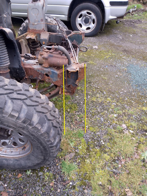

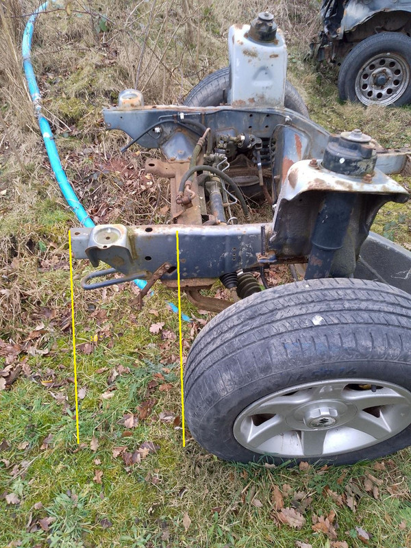

i want it to look just like a normal predator  apart from not having an engine hanging out the back, so the first thing i need to decide is which vitara chassis should i use,  the mk 2 or grand vitara has a power steering rack and the back axle locted by a 4 link set up, this would be my preferred choice  ...... but it has a quite a bit of chassis protrusion forward of the front wheels and i cant just lop it off if i want the keep the reg with no iva,
i really dont want to extend the front of the body or wings so i started looking at the vitara mk 1 chassis and thats got much less protrusion maybe 3"  that looks like it will work,
only downside i see is the mk1 uses a steering box instead of a rack but i guess i can live with that
i will throw the second hand body i have on both chassis and see how it all fits  the tight spot is going to be the top of the front suspension towers but from measurements it looks like it will work

well the suzuki vitara has a pretty short wheelbase as they come and its  more of a soft roader the chassis has a very low centre section a bit like a beetle, it  sort of lends itself well to a buggy body,  well we see if thats true soon lol
further more not all vitaras were 4 wheel drive they could be bought as 2wd  same chassis just a 2wd gearbox if it was manual and a 4wd gearbox with no front output if it was an auto,  if i use the 2wd version that i have then you have no front diff and driveshafts that force the engine to be mounted up high  to give clearance to the sump, which means the engine can go way down low so i dont have to put a scoop in the bonnet

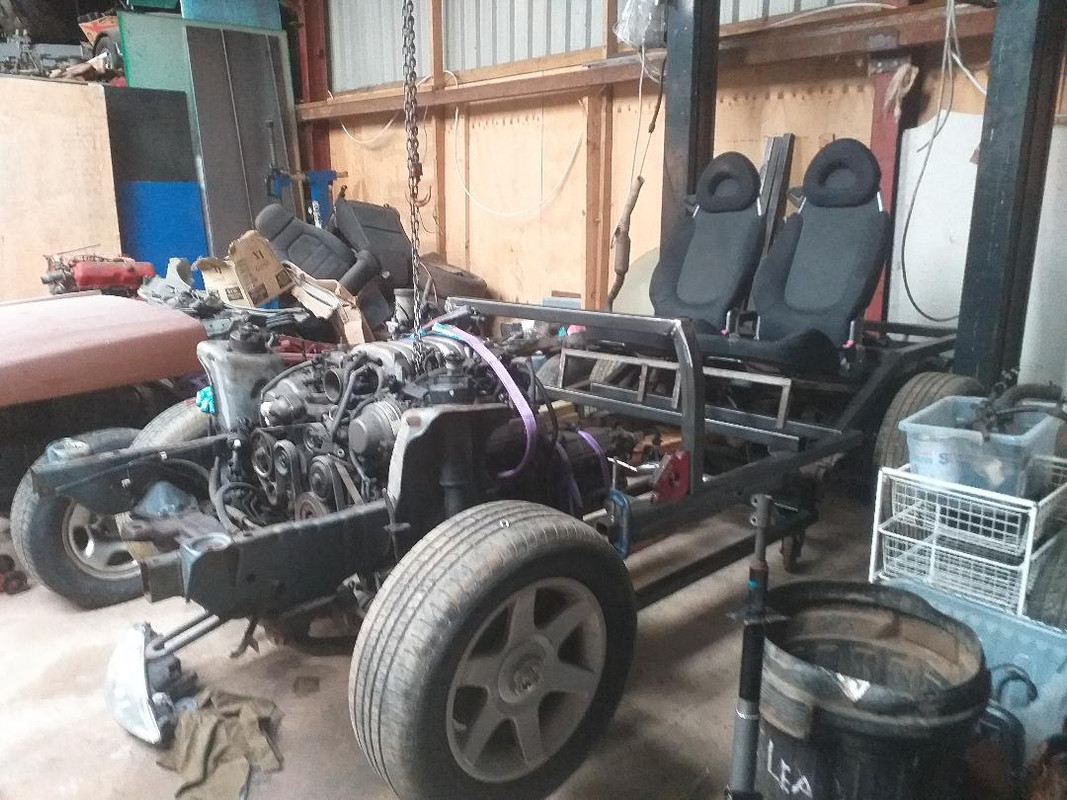

you can see the low chassis centre section in this pic of one of my old projects,  you can get a V8 engine and all of its induction equipment  below the level of the suspension towers
this buggy will probably be powered by a suzuki V6 with autobox and rwd only
you can even get a lexus quad cam installed below the the suspension towers in a suzuki
as can be seen here
the suspension towers i see as the limiting factor as to wether this will work or not
i think the beetle wheelbase is 94" or there abouts and most swb versions seem to be around 14" shorter
vitara is about 86" for the swb  so there is only a 6" discrepancy
