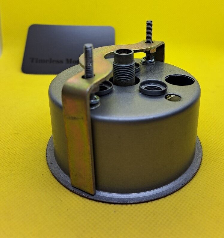

If there's enough step on the bezel you could cut off the tabs and then use a clamp like the smiths gauges use.  You would have to disassemble the speedo and put 1 or 2 studs on the back (bolt from the inside) and use a wing nut or similar to hold the clamp against the back of the dash.
Here's the back of a smiths gauge, shouldn't be too hard to knock something up

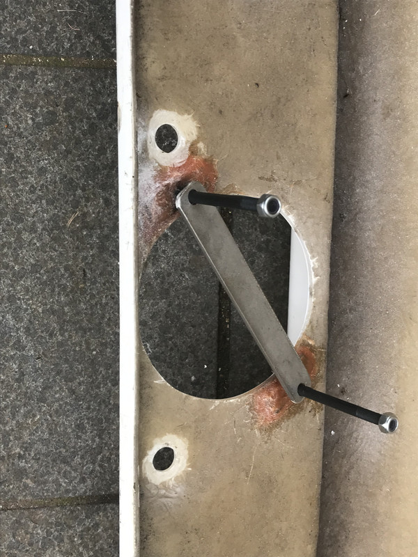

Did this in the end. There's a strap or bar that will go across the back of the speedo to hold it in.
👍👍 sorted fibreglass is adaptable with resin and matting it beats welding or fixings on a metal dash
