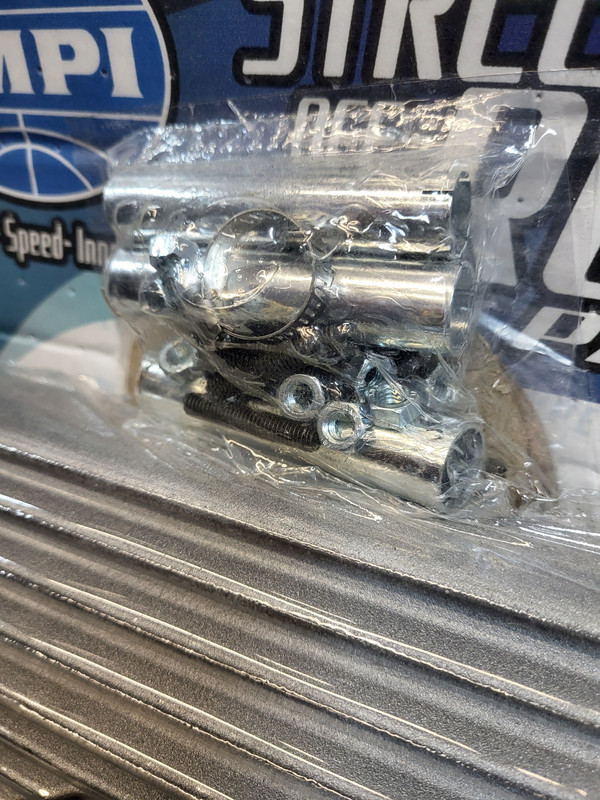

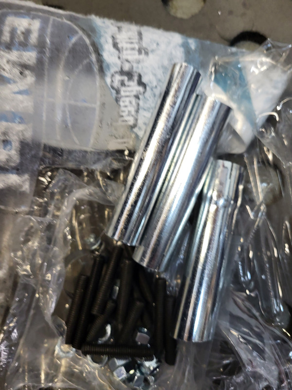

the Studs are M6 x 33mm long
and depending on the engine there are 3 different oil pick tube extentions
