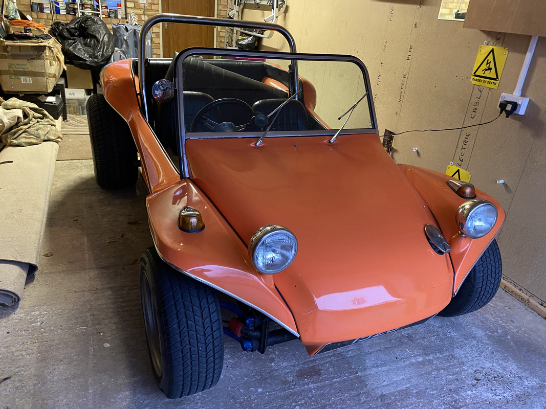

hi guys im new to this and need help in the parts department. i dont know how to start this or even if im in the right depart ment. im after a seal which fitted to a buggy front windscreen, this is the seal that is attached under the windscreen frame and sits on top of the bonnet. without this i have a gap where when raining comes under frame and into the car..    pls can someone help me find a new one and where from. many regards. james

As Paul days Woolies has a massive range of seals. You're not likely to get an off the shelf part for a buggy. On mine I got a filler strip of dense foam that went under the screen,bjust measured the gap, either work it out or stick a bit of plasticine or similar under it and  put the screen back then measure. Add a couple of mil and Robert's your dad's brother
