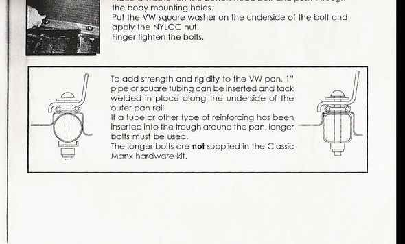

I've always used the thinner, cheaper pans, I've just found they need some reinforcement in the areas of the seat mountings. You could also add a square or round reinforcement under the outer lip of the chassis, this is what Bruce Meyers recommend in Manx instructions.

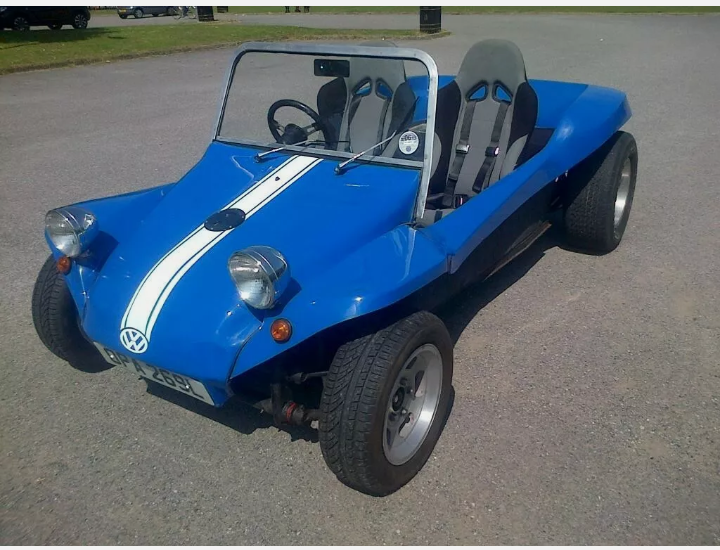

Quote from: Manxdavid on February 02, 2022, 11:03:50 PM
If I were building a new buggy from scratch it'd have to be a lwb, I'd never consider a swb with all of the IVA test and registration hassles. There have never been so many good looking lwb buggies out there as there are nowadays.
I built this a few years ago from spare parts that I had lying around and a reject body, it was a truly great car!
It's an early shape Jas buggy.
Can I ask where the battery sits in this , what size wheels/tyres were fitted and what windscreen did you use ? cheers Jon
myfirsybuggy

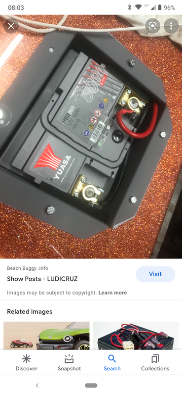

The battery was mounted in a fibreglass box sunk into the offside rear shelf/seat area, a bit like this.
Wheels were 8 1/2 X 15 and 6 X 14 1970s American slot mags (Appliance make) fitted to wide 5 (66-67 Beetle) drums with adapters. Tyres were 275/60 X 15 and 185/60 X 14.
The screen was a bit tricky as the Jas scuttle is a little narrower than most at 41 1/4" wide but I was lucky as Buggypete off this forum had a second hand one possibly off an old Manta Ray? I got the glass cut by a local forklift truck dealer.
