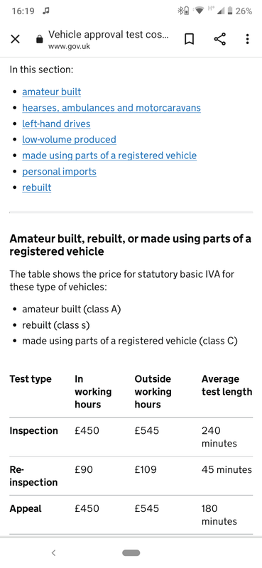

How does the car tax work out on an IVA registered ( Q plate I'm assuming ? ) buggy
myfirsybuggy
IVA....   Q plate which cannot be changed. No MOT for 3 years per new production vehicle. Car Tax.... very good question and to be honest I have not thought of this and I do not know what criteria applies here.
If you decide to go down the IVA route do your homework thoroughly. Vosa test station just down the road from you at Blyth.
