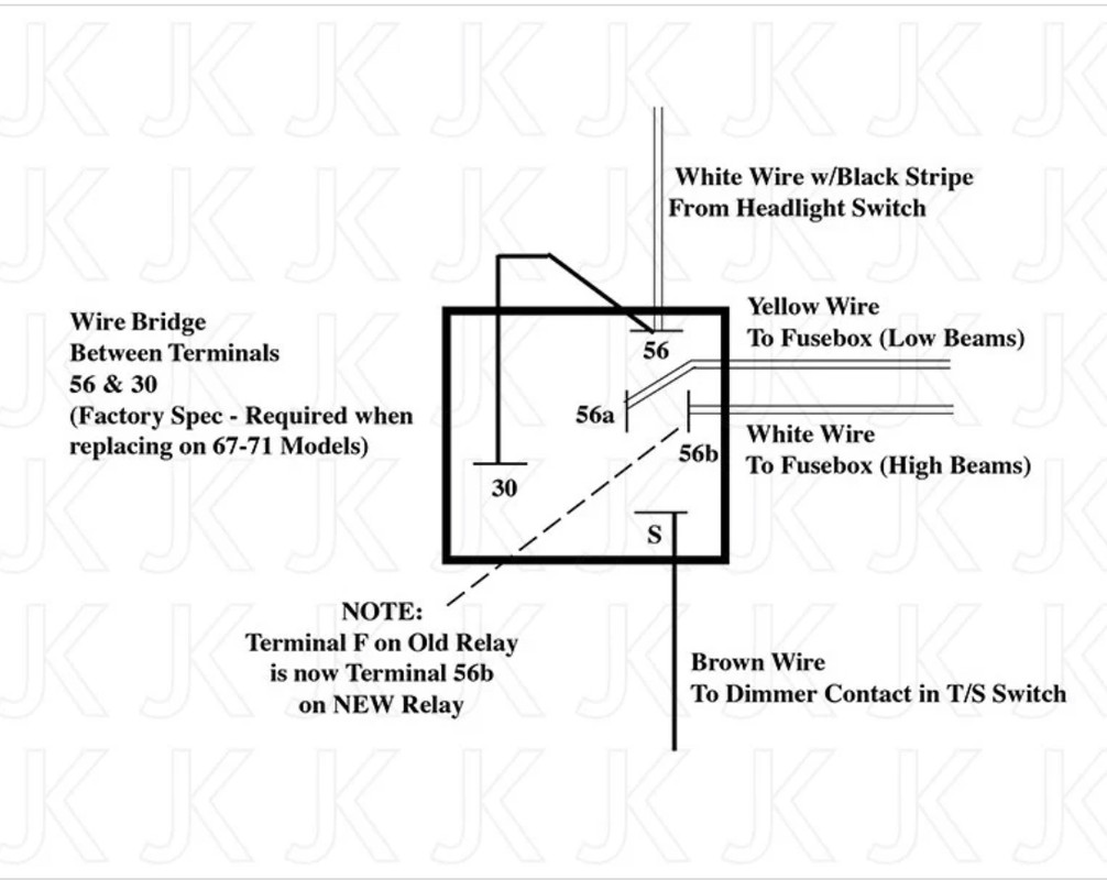

5 pin relay, no numbers only a schematic on side
Bzad
Posts: 9
Volksrod
Location: Malvern
It's this one
Checking wires I seem to have it right
30 is a ignition switched live auxiliary a black and yellow wire. S earth through the micro switch to change the lights over dip/ main.
pull the wires off and leave 56 from light switch, 30 from aux or bridge and S connected, the relay should toggle between the two functions easily checked with a meter or bulb on pins 56 a and b new relays have been known to be faulty.

The "S" terminal is crucial. It is a negative lead, ie ground\earth. When connected correctly with a good connection to earth via the column switch it toggles dip to main beam and back using the column switch lever arm. A quick pull towards you to toggle. For Headlight Flash you pull back and hold back for a short period. Take care in this circumstance because the head flash brings all four bulb filaments on at the same time. That is to say both dip beam plus both main beam filaments at the same time. (Measured 17 amps on my buggy in this mode).

As snoopy says the relay simply toggles between main and dip beams with the added function of being able to "flash" your headlights but this brings all 4 bulb filaments into action. That is both main beam and both dip beams illuminate.
Look at the 5 pin relay..... Terminal "S" is the key to switching between high and low beams. It is a ground contact. NEGATIVE that is.
On the relay diagram, in this thread, it indicates a brown wire from dimmer switch. This wire is the negative and you only have a dimmer if you have the dash mounted switch with integral dimmer. You may simply have a wire from the column switch. Usually black on repro but this is not always the case. Keith makes the point that you could have any version of switch on your buggy and boy have I learned this the hard, expensive way.   What is ultra important is that you have an excellent point of contact to earth/ground the system for switch and both headlights.
