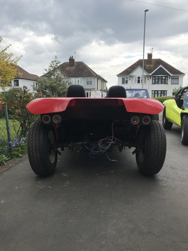

Today was a simple plug the 1303 wipers to the Column switch after removing my loom Connect the earth and put a live in.  Mmmm wipers no work and blows a fuse so reset able fuse in Have a look at the motor speed 2 fine speed 1 works as a constant with the ignition no fuse blow, looks like time to strip the switch out as that is unknown. So fitted the motor instead just needs the fuel tank modifying and hoses. Pedals out to fit a new cable as doing it through the chassis hole is impossible with big finger. Got it outside for a photo or 3
Engine fit shows the Rearbody is 1/4 to the left with the twist in it And putting it back down the 1" has caused it to foul the fan shroud.
