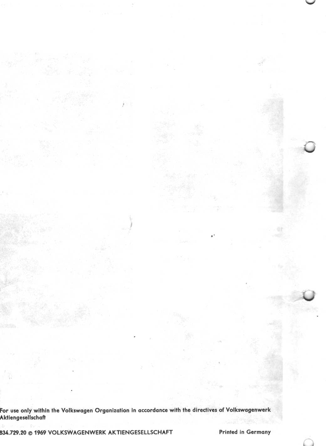

If the Manufacturers deem that their chassis is perfectly suitable to be shortened in the manner shown, then it is difficult to see how this can be questioned by DVLA. It is also important to remember that with Volkswagen being a German Company, then any guidelines published by them will have already met with German T.U.V. approval, which is regarded to be one of the strictest in the world. This set of official instructions from Volkswagen shown below, has been the backbone of VW floorpan fabrication and can be Authenticated and Verified from its part number on the back page.
834.729.20 Copyright 1969 VOLKSWAGENWERK AK TIENGESSELLSCHAFT
You can Download your own copy here: http://beachbuggy.info/Pics/Junk/SWB/VW83472920.zip
Unlike most other cars, the Volkswagen Chassis lends itself perfectly to being shortened in this way whilst retaining full structure and integrity. As time has passed on, the only real change to the 1969 document shown above is the type of welding used. It is widely accepted that the Gas Welding of the 1960`s has been far superseded by modern welding techniques, and all welds are subjected to rigorous and visual inspection each year with the annual M.O.T.

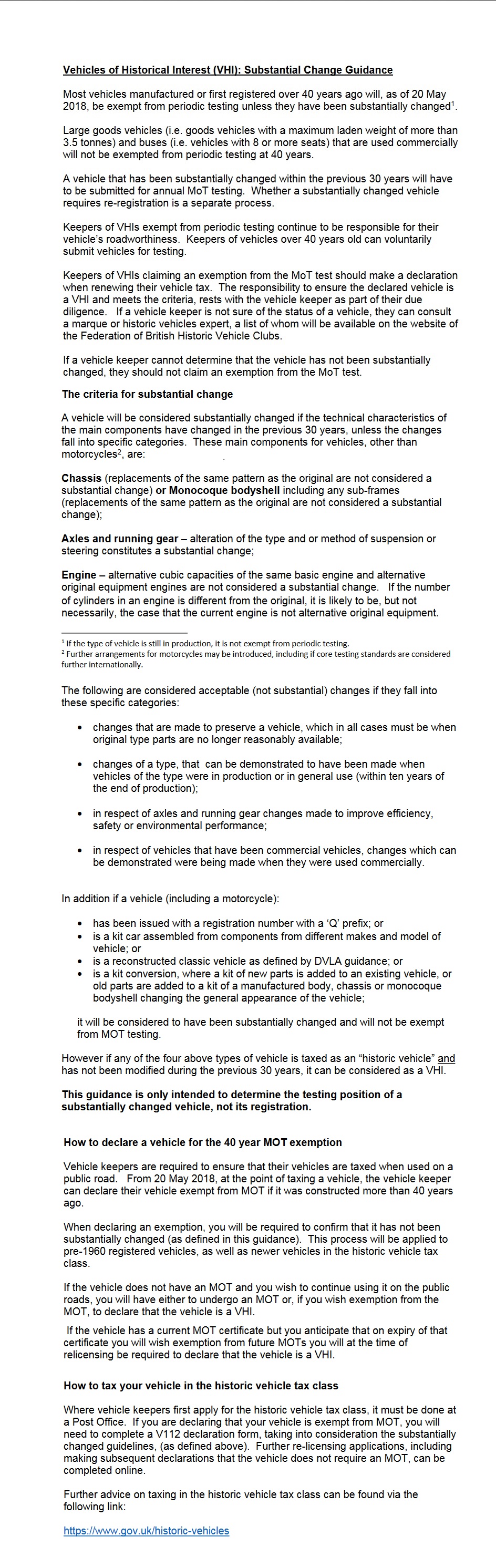

This is now the Official Guidance as of April 19th 2018:
Vehicles of Historical Interest (VHI): Substantial Change Guidance
Most vehicles manufactured or first registered over 40 years ago will, as of 20 May 2018, be exempt from periodic testing unless they have been substantially changed (1).
Large goods vehicles (i.e. goods vehicles with a maximum laden weight of more than 3.5 tonnes) and buses (i.e. vehicles with 8 or more seats) that are used commercially will not be exempted from periodic testing at 40 years.
A vehicle that has been substantially changed within the previous 30 years will have to be submitted for annual MoT testing. Whether a substantially changed vehicle requires re-registration is a separate process.
Keepers of VHIs exempt from periodic testing continue to be responsible for their vehicle's roadworthiness. Keepers of vehicles over 40 years old can voluntarily submit vehicles for testing.
Keepers of VHIs claiming an exemption from the MoT test should make a declaration when renewing their vehicle tax. The responsibility to ensure the declared vehicle is a VHI and meets the criteria, rests with the vehicle keeper as part of their due diligence. If a vehicle keeper is not sure of the status of a vehicle, they can consult a marque or historic vehicles expert, a list of whom will be available on the website of the Federation of British Historic Vehicle Clubs.
If a vehicle keeper cannot determine that the vehicle has not been substantially changed, they should not claim an exemption from the MoT test.
The criteria for substantial change
A vehicle will be considered substantially changed if the technical characteristics of the main components have changed in the previous 30 years, unless the changes fall into specific categories. These main components for vehicles, other than motorcycles (2), are:
Chassis (replacements of the same pattern as the original are not considered a substantial change) or Monocoque bodyshell including any sub-frames (replacements of the same pattern as the original are not considered a substantial change);
Axles and running gear – alteration of the type and or method of suspension or steering constitutes a substantial change;
Engine – alternative cubic capacities of the same basic engine and alternative original equipment engines are not considered a substantial change. If the number of cylinders in an engine is different from the original, it is likely to be, but not necessarily, the case that the current engine is not alternative original equipment.
The following are considered acceptable (not substantial) changes if they fall into these specific categories:
• changes that are made to preserve a vehicle, which in all cases must be when original type parts are no longer reasonably available;
