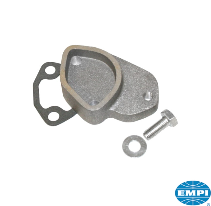

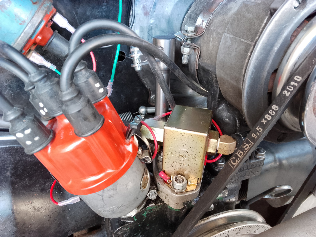

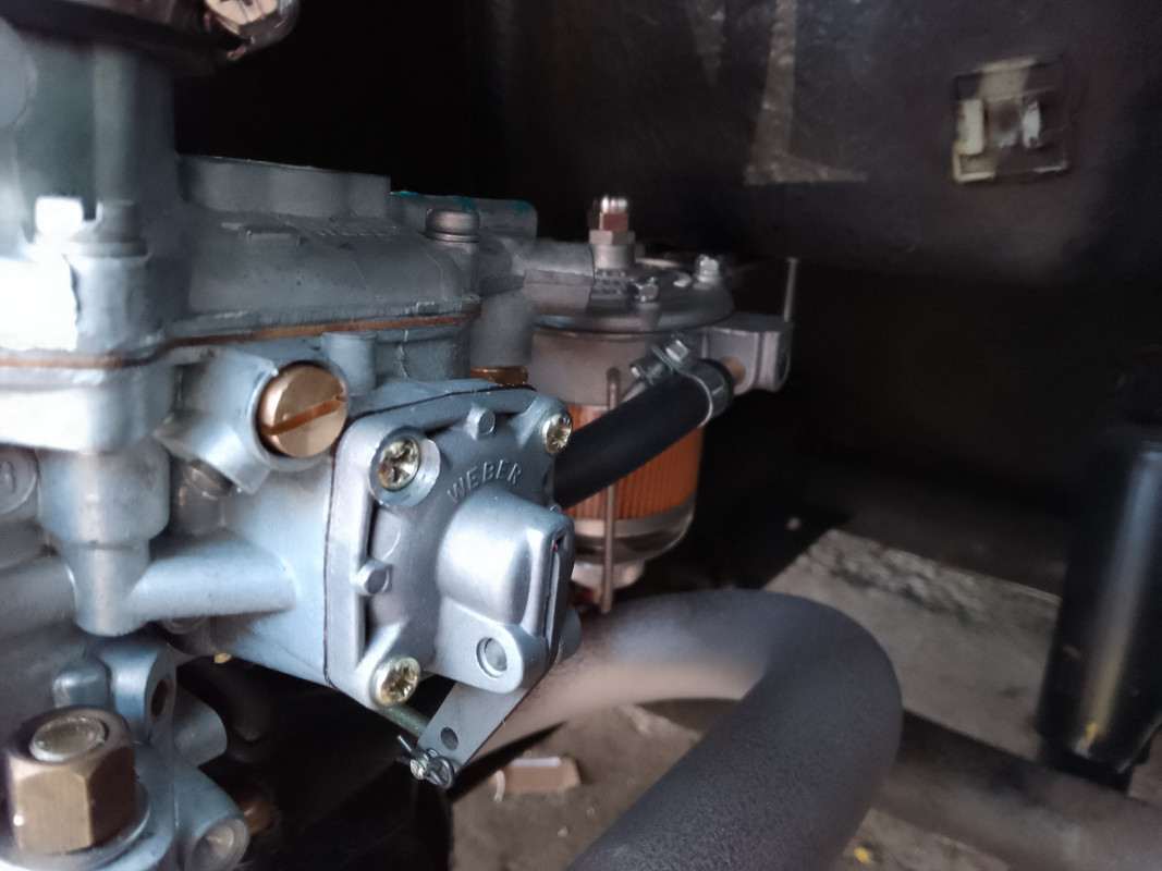

I've recently gone electric (I blame Bob Dylan) using a Facet copy (Chinese I know but I've been using them for years on my wife's golf buggy with no issues) mounted on one of Empi's neat little combined pump mounts/case block offs. I needed a 45 degree / 6mm elbow from the Orient but it sends the hose neatly under the alternator. It's further from the fan belt than it looks.
Filterking is mounted under the rear on the offside set at 2 psi which the engine seems to like. All good so far. Again it's further from the exhaust than it looks in the picture.

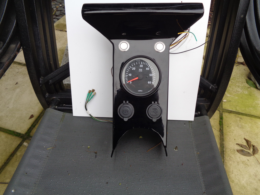

Cannot sit still more than 10 minutes....  Finished the latest bit for my buggy and yes it is inspired by the tramp buggy..
Wanted something to fill the gap below the manx dashboard hence this. Wanted it to fit and remove in a couple of minutes just in case I ever manage to lie on my back with legs in the air to get under dashboard once more.
The rev counter is a nos older "programmable" version. Programmes for any range, within reason, on 2 4 6 & 8 cylinder engines and has a facilty to "fine tune" the meter action so that it zero`s and reads rpm very accurately. These meters have been available on ebay for peanuts for some years but older types are becoming scarce. You can get up to date models but they cost a lot  :'( :'(
Need to shout out about the two switches you see.... They are the best I have come across with an incredible set of options. Stainless steel bezel/body/securing nut. Socket included with ten flying leads, (yes you read that right.. ten of them). Each switch can be "normally closed" or "normally open" whichever you want to choose. Each switch has rgb illumination option. (red, green or blue). They have a really small  panel height when fitted and have a long enough threaded length to allow easy fitting to thick fibreglass panels. They, in my, opinion, are not expensive. Trying hard  to convince myself not to swap out my existing rocker switches for these. (These push button switches are iva compliant).  They are obtainable with logo or without. Latching or non latching (momentary).

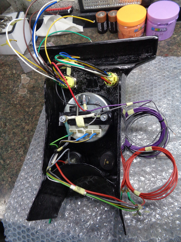

I have come to realise two things. One brought about by the item in the photo below and the second as a result have having a buggy that I no longer need to spend every available hour all 4 seasons of the year for years on end building away.
The first thing is an understanding of why many people shy away from automotive wiring....  In the photo is the rear view of the fibreglass structure that will fit onto the tunnel and at the top to the manx dashboard lower edge. As I looked at the multitude of wires in front of me, and there are still more to add, I thought to myself that what a lot for two switches, one 12v aux socket, 1 usb socket and a rev counter  ;D  It probably does look daunting but it isn`t it`s simple stuff and just needs a methodical approach. Needed a new reel of leaded solder and almost fell over when I had to pay 28 quid for a small reel
