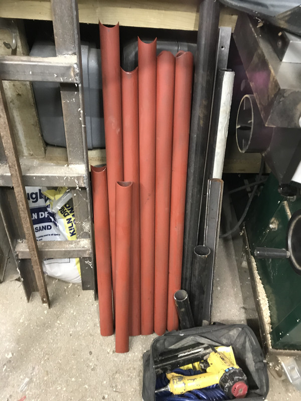

Hi Paul , Admittedly my pillar drill was cheap but I only ever used it for wood work and the gearing was a poor selection from fast to stupid fast , so no real use for metal work above 7/8mm as the drills would just overheat .
Managed to get a good batch of scalloping done but it's easy to tell when the hike saw blunts as it snatchs the tube and cuts an oval more than a circle , so the scallop is slightly wide .
Out of 2 cheap holes 44mm hole saws I've easily cut 16 scallops , with some life left in 1 . And an old 67mm hole saw made two scallops for the tubes notching over the rear beam .

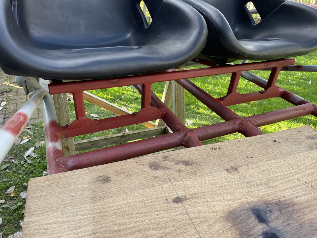

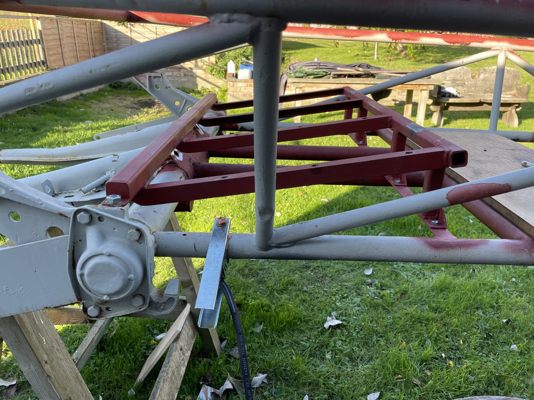

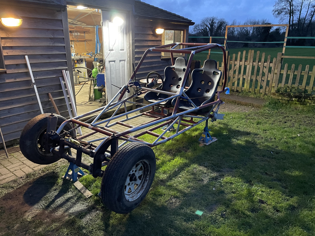

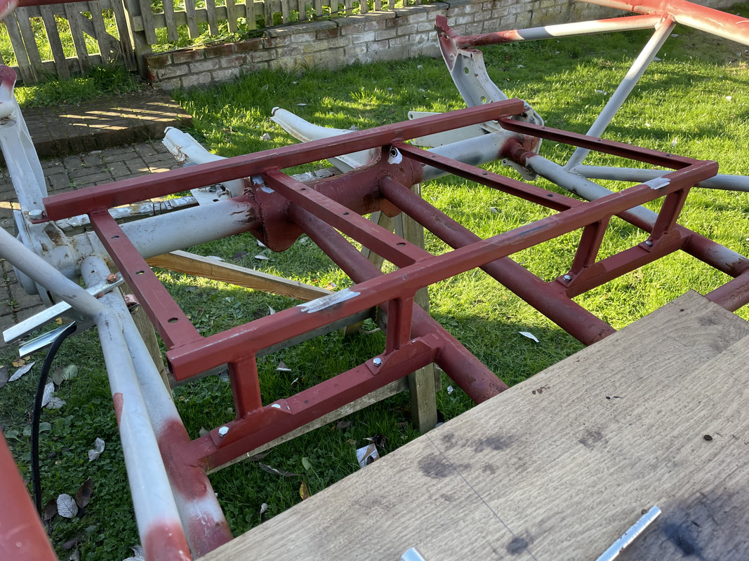

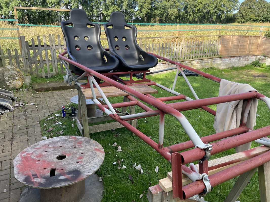

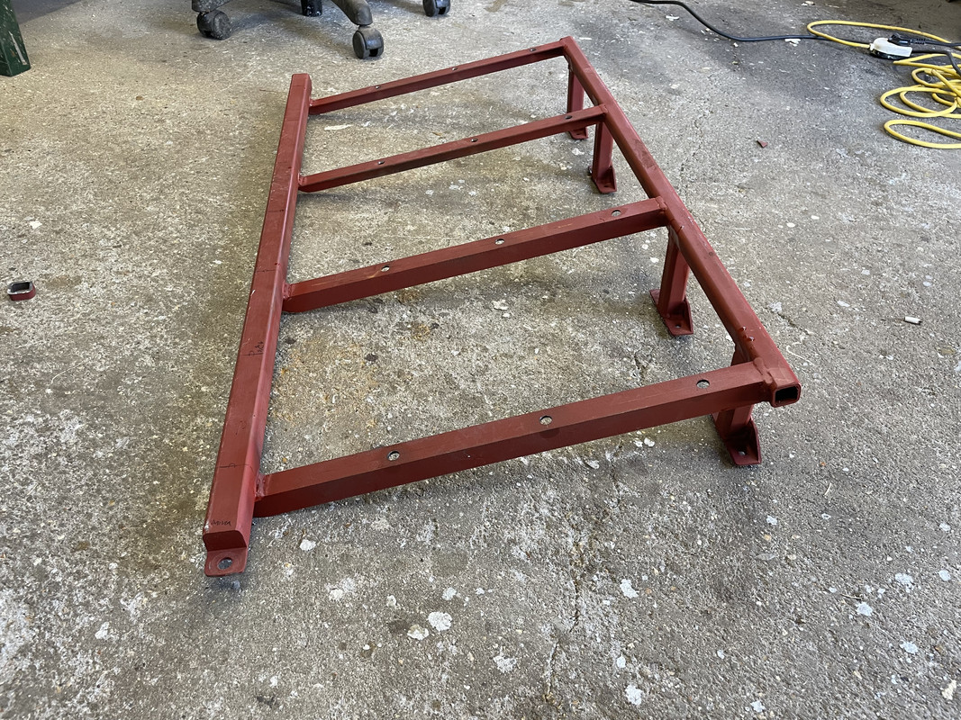

Evening all , not much on the progress side as of late but did manage to get some new seats that I got on eBay fitted .I ended up giving up on the fibreglass rework as time isn't to surplus at the moment .
It's a simple frame made of 20x20 and built with the angle I wanted into it so the seats have a nice tilt back to them .
The frame completely unbolts , all captive nuts welded in and actually used the two 10mm threads in the castings of the rear torsion beam , I am guessing we're originally body mount locations . Once finished properly , not only will I bolt them down via the threads but also add some locking nuts .
It's been fun sitting in it looking like a lemon as the neighbours watch 😂 packing it up and down .
It seemed a good idea at the time !!

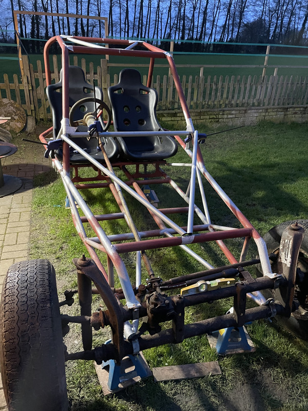

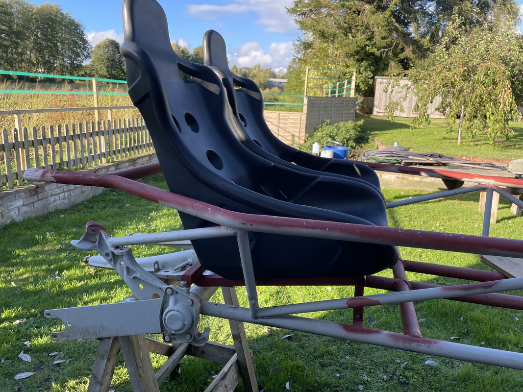

so here are the rest of the pics as they were on the laptop .
whilst the angle looks severe , once mounted its not that much , so fittedwith 2 M10 bolts at rear and 8 x M6 at the front ,4 legs 2 in each
heres the final look
pleaed so far , next is the harness brackets and setting up the gear stick and shaft , as the original is "shafted" with rust and two inchs short .and 22mm tube is not off the shelf .

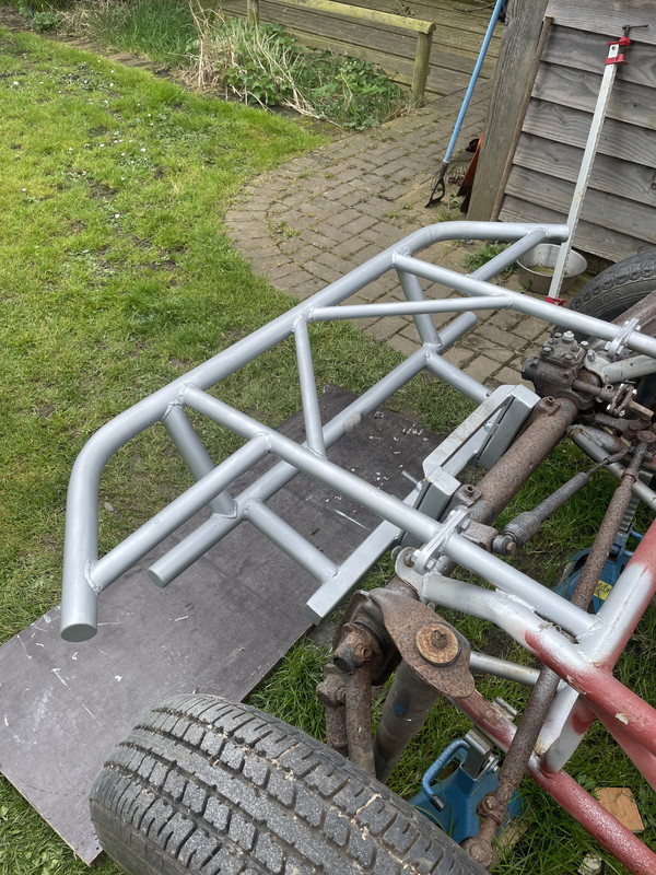

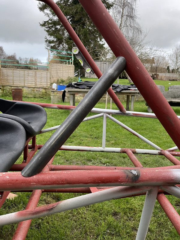

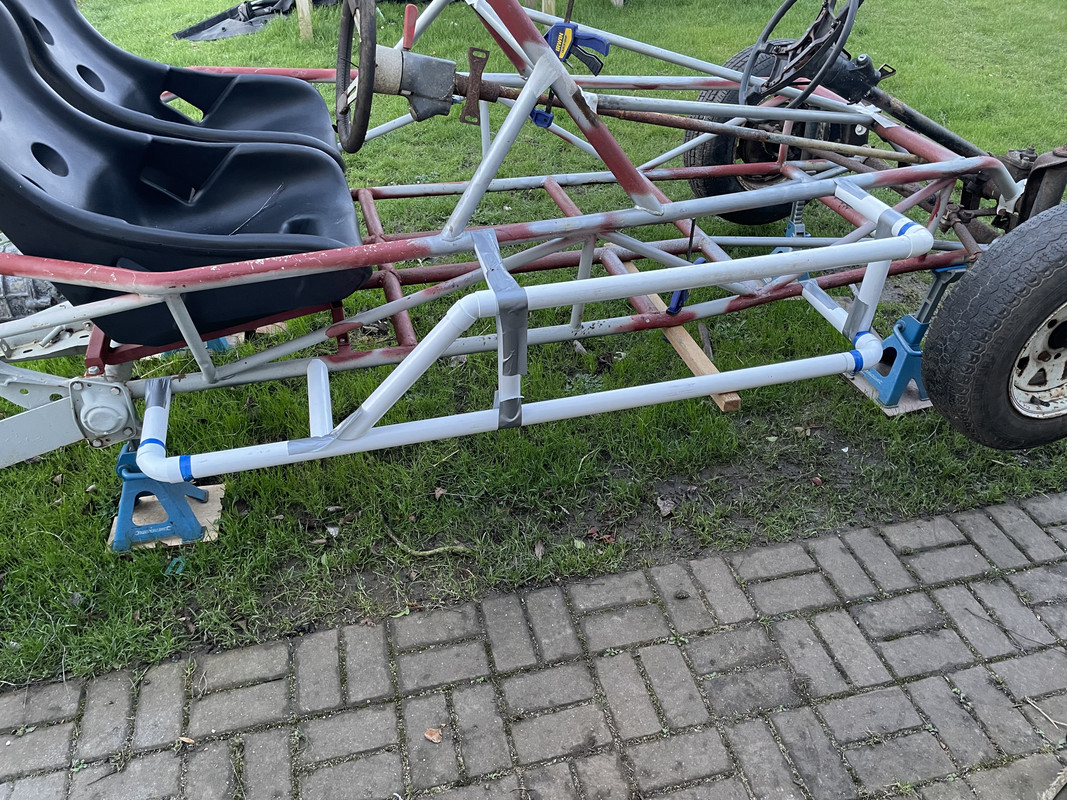

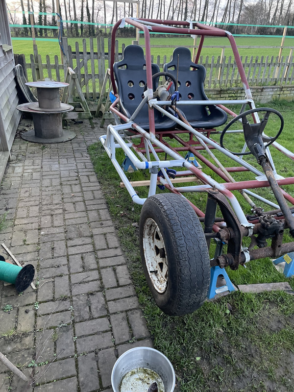

It's been a bit quite for me recently , due to unwanted time from work ! So i have had a chance to do a bit more to the rail .
I've managed to get the bulk of the roll cage and other frame work done , although there are still some niggely bits to do along with the rear frame and engine protection cage .
I've been using a very handy free web page that you add in tube sizes , angles and then print out a template , cut it out and wrap round the tube . Cut the line and sand internally to create the perfect scallop .

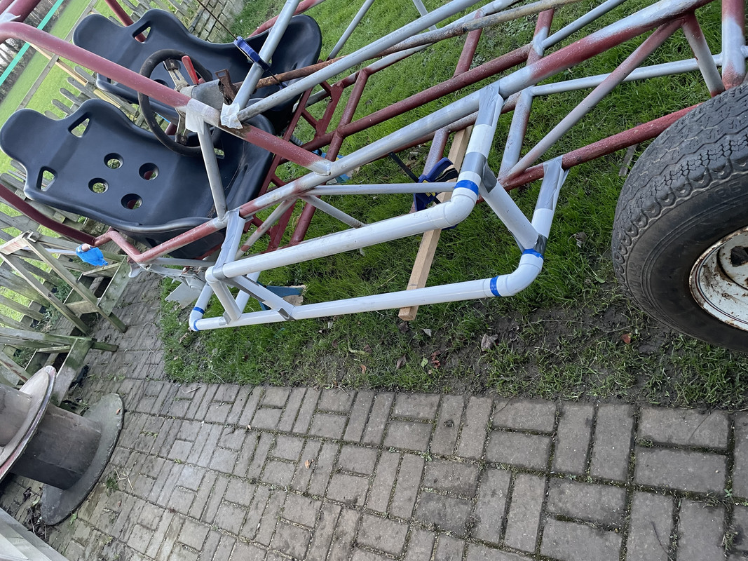

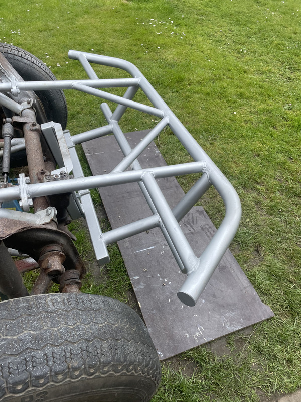

Also , I've been building the front "nudge" bumper as bull bars seem frowned upon in law ....
And now have been toying with the idea of side paniers , so decided to mock one up using 40mm solvent waste pipe , just to see if I liked the idea .
Overall , going well , next on the agenda is steering set up , which I need to get a UJ into as cant get it to where I need it cleanly . And also the pedal set up , which I made a separate request about .
Also hand to admit I will be getting a nylon "bush / bearing " made up as the one in the steering column is seized and I'm not into paying £25 for one , especially as it isn't sealed , and will be in the outside elements , so won't last long .
