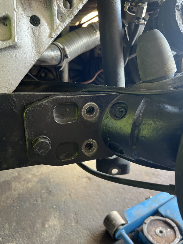

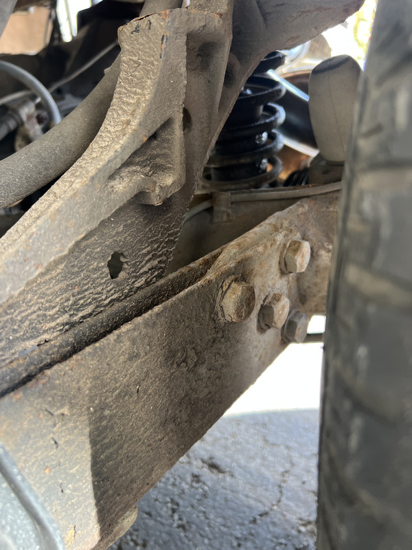

Posts: 11,230
Finally had time to fit the long torsion bars in the Jas and thought ah photo time for differences the dirty one is the Kango 1302 irs that came with twin spring plates the clean one is the Jas which may have come with a single spring plate 15 years ago. One has two holes in the top the other the third  hole is lower down so the twin plates have been swapped side to side and slotted to suit the bolt pattern. Thinking the irs 1302/3 fitted with single spring plates may be a different pattern as per the Jas although there does
 not appear to be 2 after market bolt patterns available .
