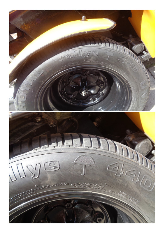

Below are two photographs of the tyres I have on my buggy, (Rear in this case). My initial thought was to keep the rolling circumference as near to an original tyre as possible. (At the time I had no knowledge of front to rear weight distribution requirements for IVA so I imagined keeping the wheels. tyres etc as near to what Dr Porsche decided would be the way to go).
Right that`s the background. Was told a tyre of this type/size was no longer available. Well I proved them wrong. (Note no silica whatsoever in construction). UNIROYAL RALLYE 440 . 225-55-ZR15. (Rain Tyre so notice the true marking for a road production vehicle" rain tyre".  See it..... Yes that`s an umbrella embossed on the sidewall.  Tread plies are  1 x Polyester + 2 Steel + 2 Nylon.  Side wall - 1 ply Polyester
Max Load rating 630 kgs. Max pressure 44psi.(Measures with cold tyre).
That`s what I have. They grip equally well on road as off. Super supple and the tread depth shows no measurable wear.
Bottom line for me at the ripe old age of 73......  Keep it simple, keep it as cheap as chips and get out there and have fun.

The Rallye 440 is a very high silica compound. That's what makes it a good rain tyre. That's why it has the umbrella on the sidewall...  ???
UniRoyal rain tyres in general are some of the highest silica doped road-going compounds you can get.
