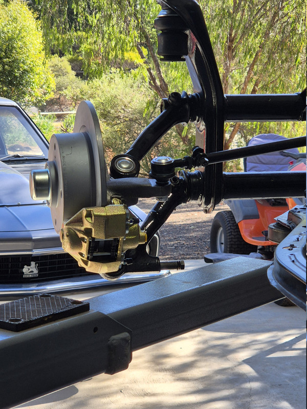

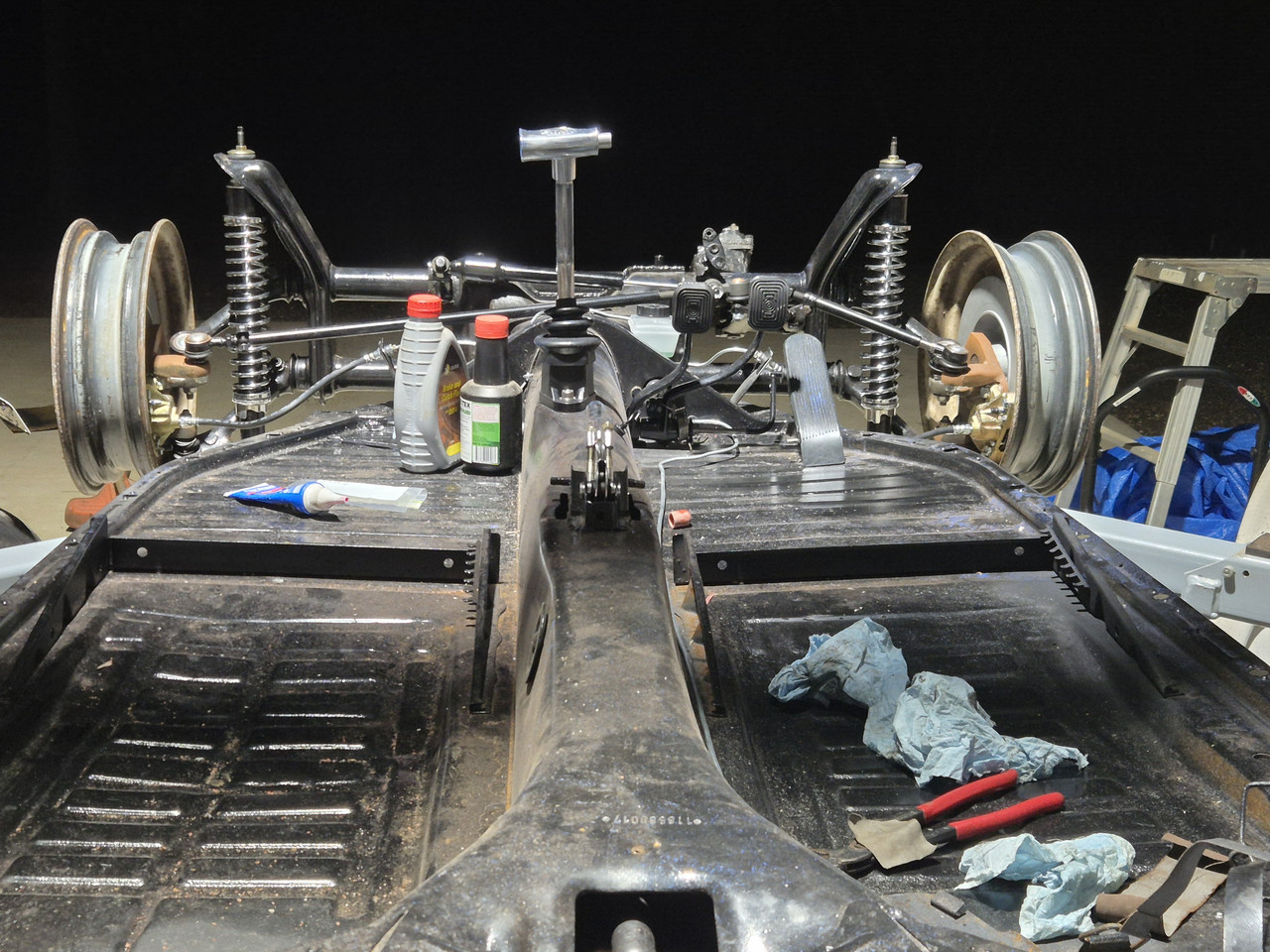

With the rear end sorted, it was onto the front Beam assembly and mounting the shocks and Disc Brakes.
The original plan was to go with the Red beam and components but Black looked so much cleaner.
I now know the purpose of the holes in the rear support arms, Thanks Volkswagen - you really thought of everything.

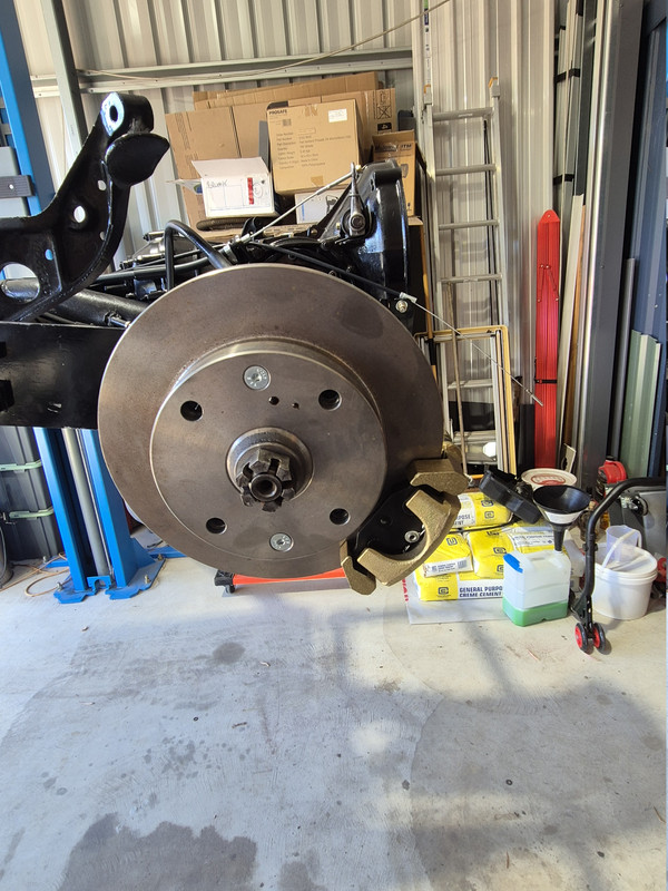

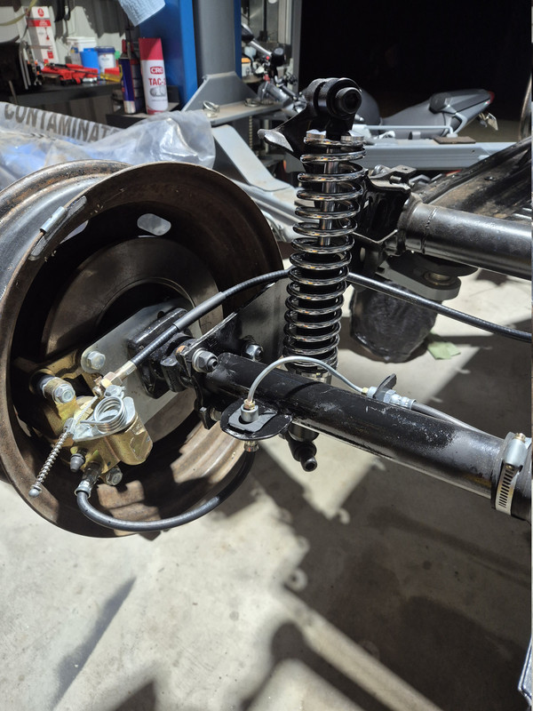

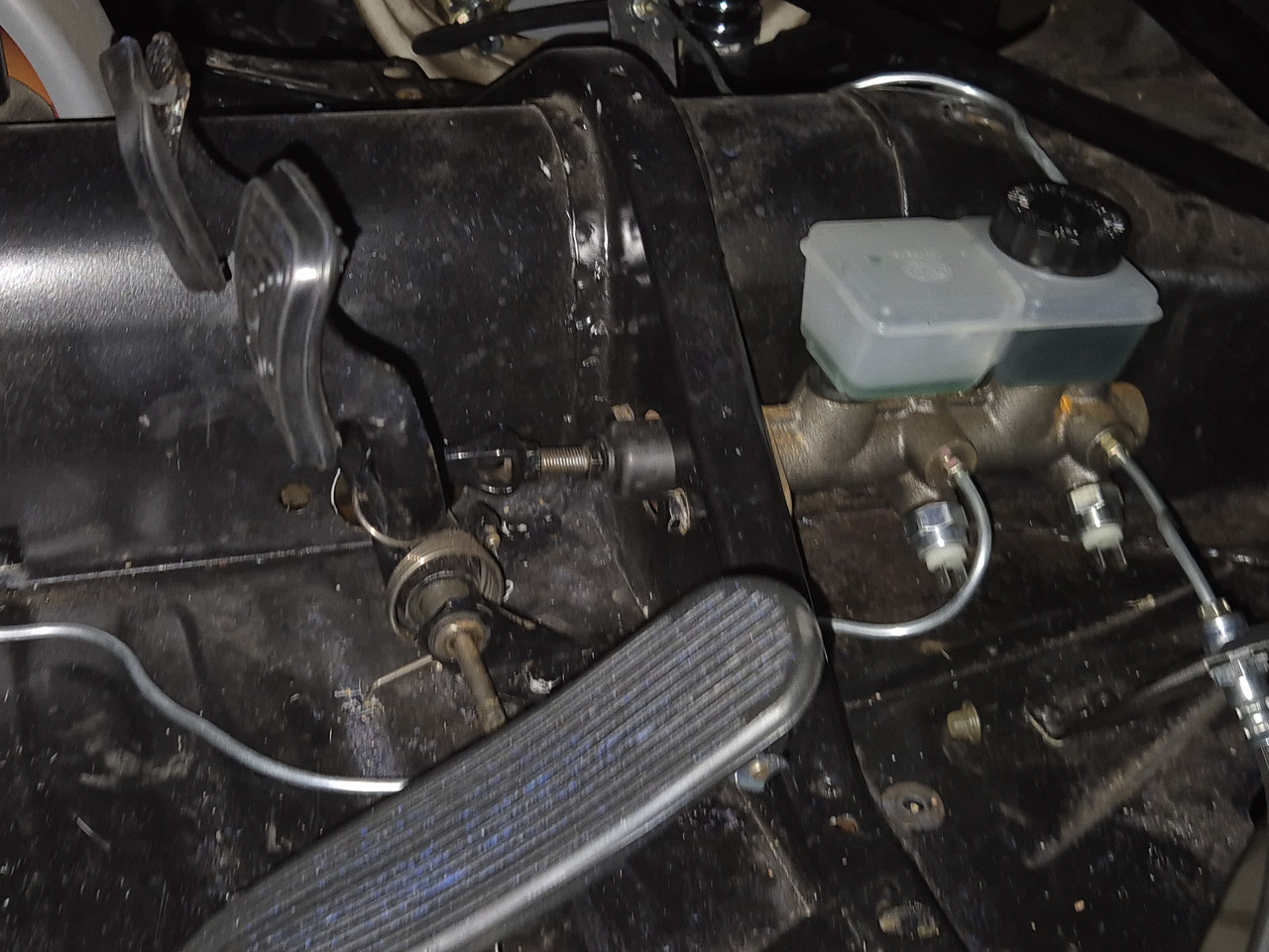

Disc brakes have been the topic of discussion in my household, do I stick with the drums all round, go with a combination disc front drum rear or just go all out and put discs on each corner. After doing the numbers as everything needed to be replaced any way, the Disc brakes are now on all-round. I'm just hoping my fasteners holding the fiberglass body are also good enough to stop the body with the brakes applied.
With the disc callipers installed, my attention shifted to the installation of new brake lines. The rear callipers needed a much longer brake hose than the drums had so I ended up fabricating and welding on a new rear mount to keep the flexible brake lines to a reasonable length.

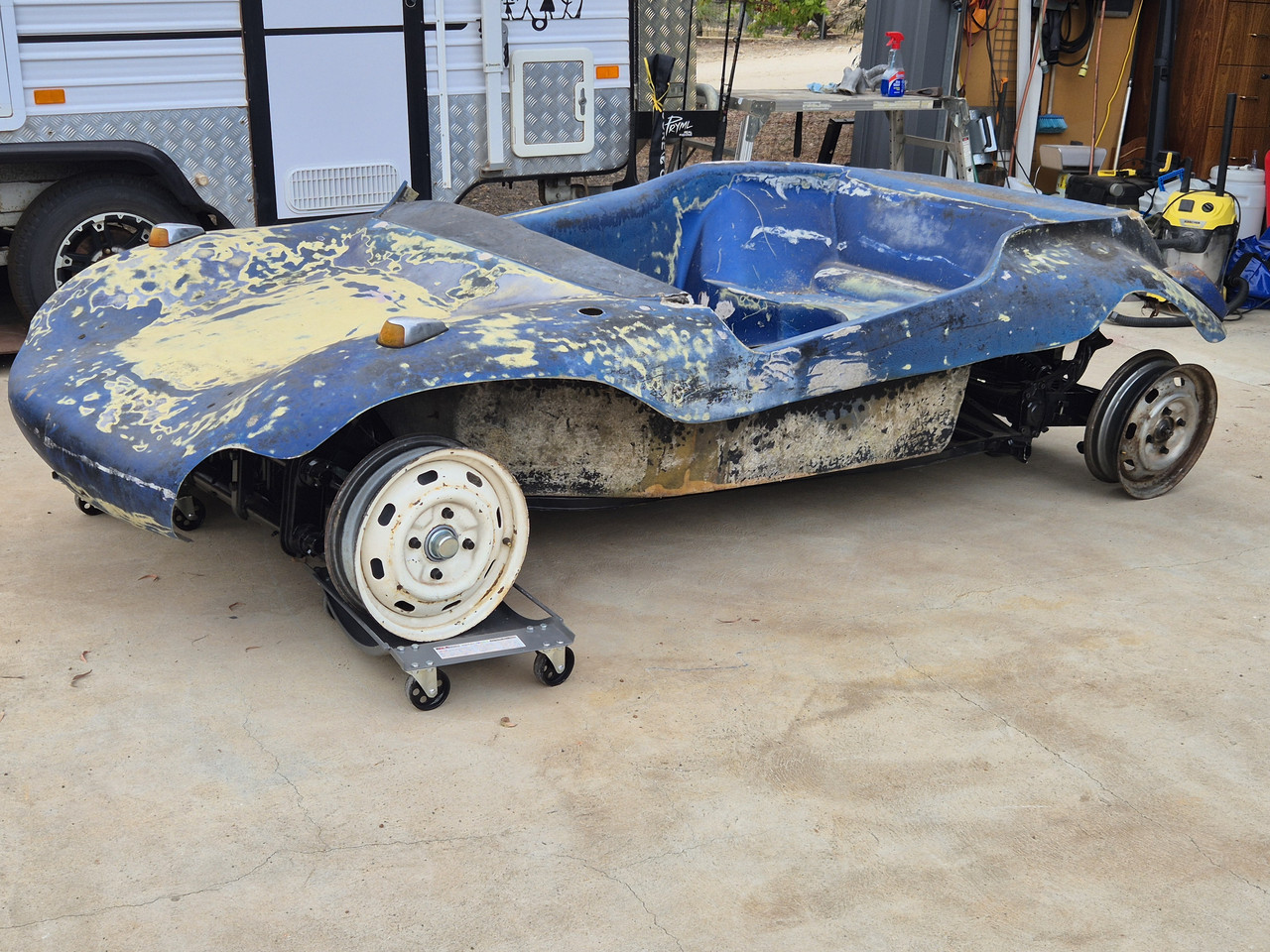

I couldn't help myself I had to pop the body on and see how it looked. I just need to start some fiberglass work and lengthen the body to fit the full length pan.

Quote from: snoopy on July 29, 2026, 07:27:47 AMGood to see progress being made, you may find the coil overs make it too hard so it bumps and bangs when driving.
Yea I think I got caught up in looks and being a two wheel fan as well I love the look of coil overs. After reading a lot of info in here, I have now also bought a set of normal ones just in case.
The rabbit hole of Volkswagen ownership appears to be very deep indeed.
Posts: 11,227
The springs are easily removed from the shocks then they are fine but here in the UK water and road salt means the piston chrome rusts and peels as there are no dust covers.
