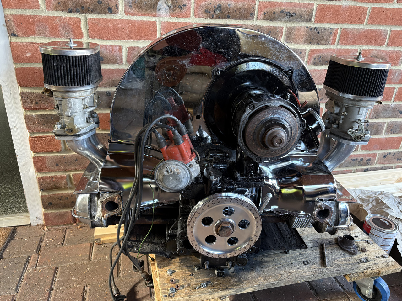

More fuel delivery problems it seems...after my stuttering and stop at Beer and again at Swanage last year, I made the cardinal error of leaving the buggy stood still for the winter (albeit pretty much empty of fuel). Now, it turns over but just won't start.
It will try, a little half-heatertedly with a short squirt of Easy Start into each air intake and I know I have a good strong spark. I have topped up with E5 fuel which I know is being delivered to the (twin Kadron) carbs. I have removed, stripped, inspected and thoroughly cleaned every bit of both carbs (which appeared fine anyway), blasted compressed air through every orifice (the carbs, not me), lost and replaced both of the tiny steel check balls (2.38mm diameter), refitted, removed again, stripped again, cleaned again, refitted again and still have the same problem of fuel starvation into the throttle body.
Nobody I can find in the UK stocks a fully complete Kadron rebuild kit including an emulsion tube which I originally suspected as being at fault so I have two kits on order from California via a friend in Kentucky which I won't get until he comes over at the end of May. I am now thinking that the accelerator pump diaphragm may be the culprit preventing fuel getting through from the bowl into the venturi but both diaphragms look OK with no visible damage and I have the exact same problem on both carbs, manifesting at the same time.
I have separately ordered new diaphragms anyway as an almost last resort. I've also ordered The Complete Kadron Manual and both should be here tomorrow
If I fit them and still don't solve the problem, I am now thinking that even if the rebuild kits work when I finally get them, (too late for this year's trip to Beer ☹️), there's nothing that says the same thing won't happen again, and I will still have that annoying persistent flat spot that was always there even when it was running well.
So, after all the rambling, what experience is there here with swapping from twin 40mm Kadrons to an EFI system?
Which system would you recommend and why?
Will it be worth it for the lack of grief frequently dished out by carburettors?
Cost and ease of installation & set-up are factors. I'm no mechanic but have learned a lot every time I have had to tinker and tweak (thats what it's all about, no?) so a complete kit that's as "plug and play" as possible would be ideal.
I don't relish the prospect of spending £2K to get my buggy running reliably now and every time I go to start it in future, but I will if it means I'm back on the road and might even make it to Beer next weekend (as long as it's not peeing down).
Finally, if I bite the bullet, does anyone want to make me an offer on these twin Kadrons (complete with two brand new rebuild kits and some spare diaphragms) to offset the cost a bit?
