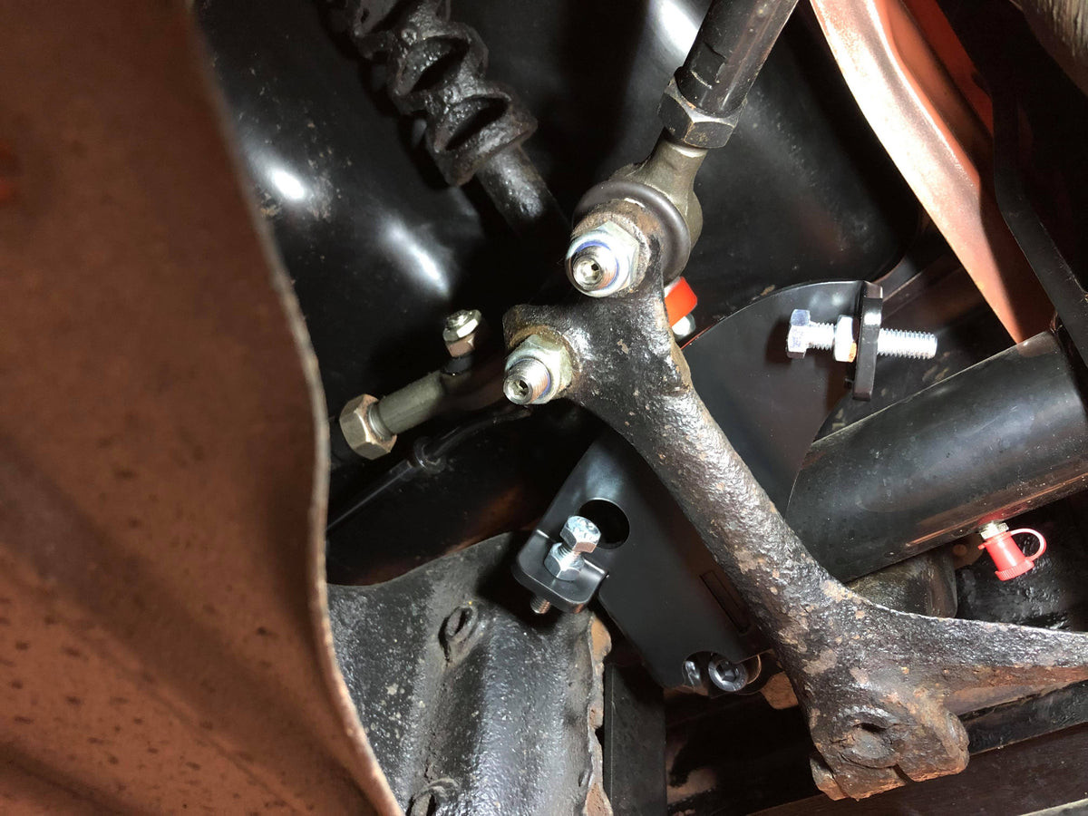

I'd still rather trust a positive mechanical steering stop, either the standard one that VW fitted or aftermarket, over just letting the steering box run out of travel possibly causing internal damage to components or running the chance of letting the tyres scrub away at the sides of the body tub on full lock.

On other front end matters my pet hates, the 'red ring of death', and the rather rusty collapsible section both make an appearance in that photo, plus I always fit flat washers under track rod end nuts and would fit lock washers under the steering stop nuts and fit locking nuts on the exposed threads of the stop bolts.
King and link pin steering angle stops are the castings on the swivels as they have limited movement unlike ball joint hubs.
