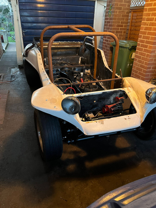

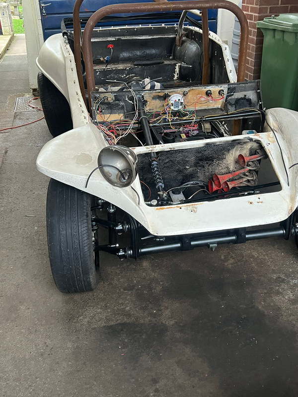

As it sits awaiting castor nuts and an inlet manifold

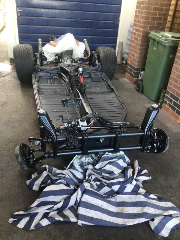

Missing suspension parts arrived so all back together and body bolted down onto a rubber seal not a open sponge type that was found on strip down causing the rot.
Dave turned up with  a cage from a lwb rat buggy but the upright front hoop needs some bends and angling to match the screen but a good buy for the money it is just dropped in to save storing it..
Great stuff. The body on starts to give out the buggy personality.
Certainly that roll cage looks suited to tall occupants who wear top hats !

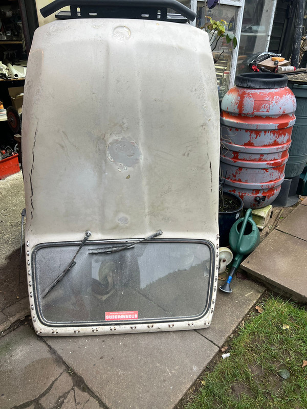

Well the Christmas period is over so got a few hours in, bonnet has been glassed and filled for the new petrol tank and filler along with the w/s/w jet hole as the wiper motor mount kept pushing the original out just needs smoothing off fully.

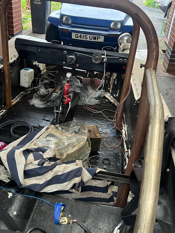

the reworked dash is in and wiring looms are in place the GPS boat/quad speedo has multiple input wires and shows a speed sender unit for the tacho but the paperwork is like a hand drawn unit with no info, only the word sender and an arrow pointing to it so thinking connecting it to the CB terminal of the coil may kill the unit.
Looks like it has an Oojamaflip high irritant air horn system. Does that need a compressor or leisure battery ?!

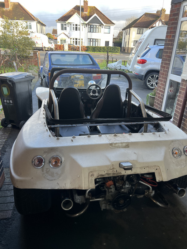

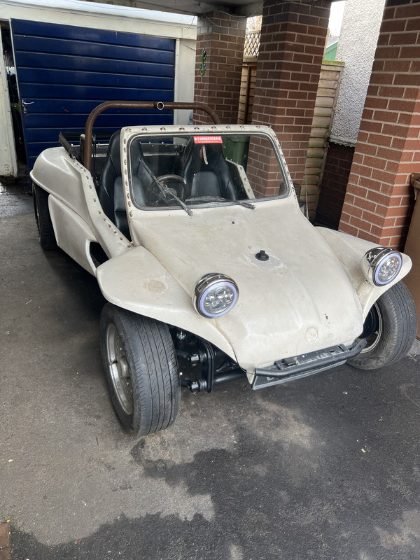

Well Graham took a lot longer than anticipated but it is now back together and useable so it will be going home to get some more jobs done like trimming and a back box/seat fitted. The rear of the brought roll frame fits but some Welsh company with a pipe bender needs to rework the front so it is near the screen.
The split axle boots one worked the other leaked from the box end but cleaning and resetting it 4 times it may be ok but use will tell a first as they normally seal ok.
Heated mx5 seats are in and wired. Should be good for a fair few years with nearly everything new on the brakes and suspension once the body is prepped and painted in the better weather he should be seen at a few meets.
That looks a delightfully clean, tidy and honest functional buggy.
