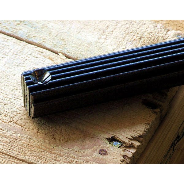

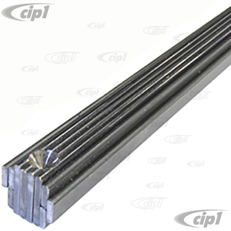

I've started putting the front end back together on my bucket of bits.
Things were looking good until on closer inspection I notice that one side sat lower than the other also when pressing down on the suspension one gave much more resistance. What could the problem be?
Bearing in mind when I put the torsion springs back in I put them in the same way as I took them out. This does not mean that they were in correctly to start with as I am unsure if the previous owner had removed them at any time as the rest of the front suspension had been removed.
Is there any way to determine which bars should be at the top and which way round they should be?
Posts: 834
You need them in the correct order to make the dimples to locate the grub screws in the torsion arms. You could also do away with the thinner leaves as not needed in a buggy really, so do, some don't up to you.
