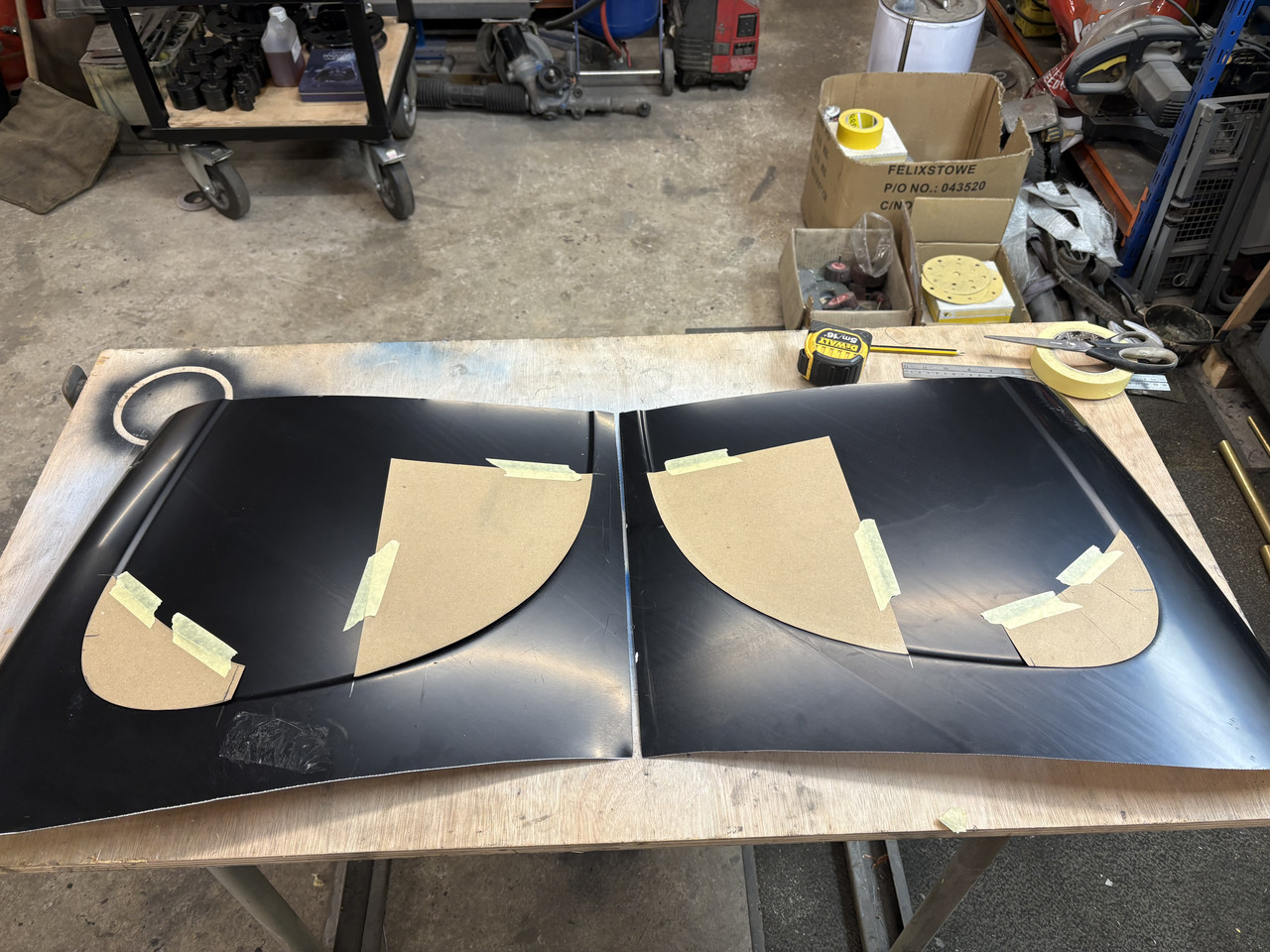

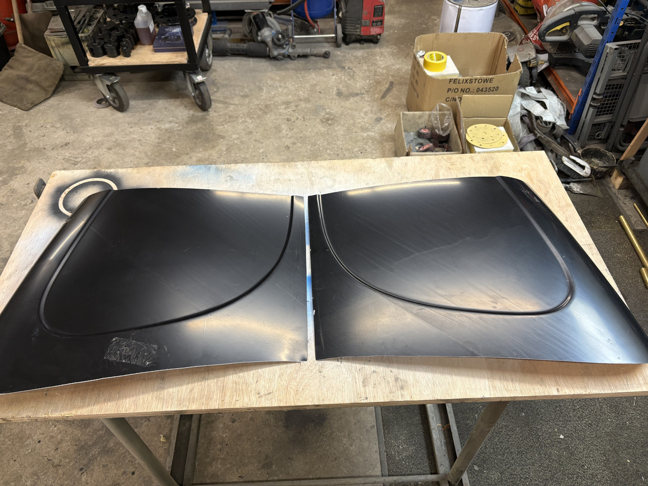

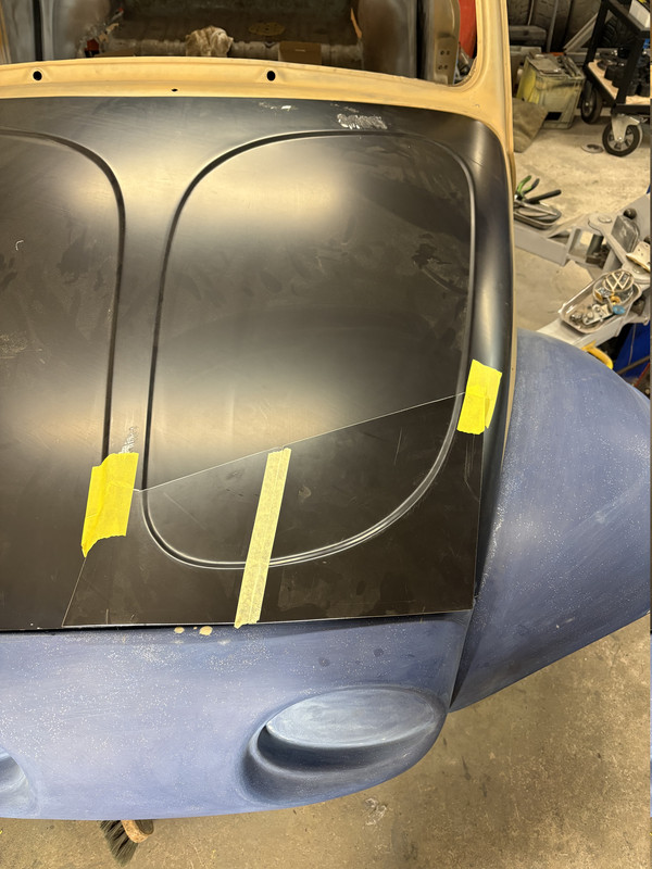

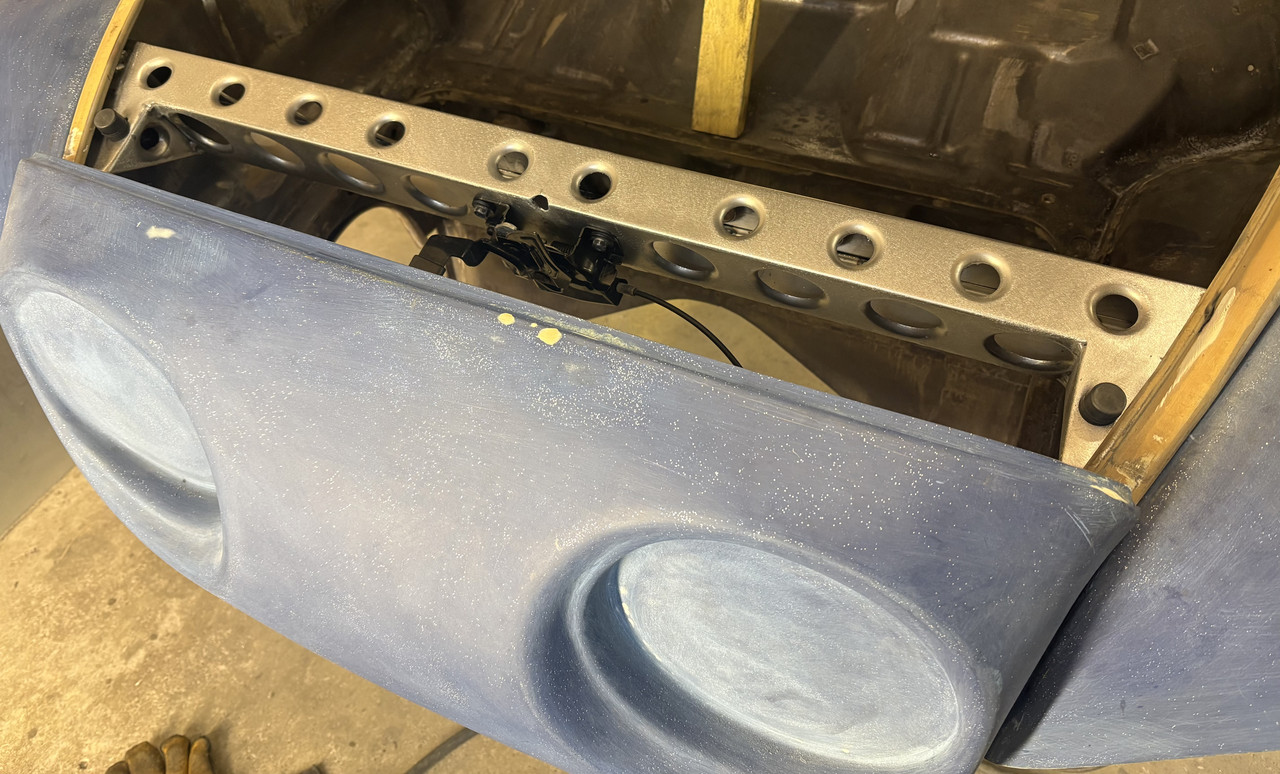

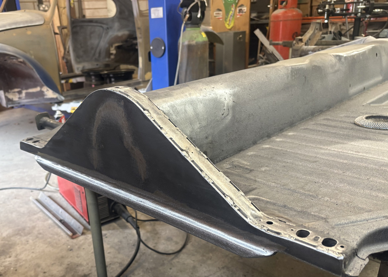

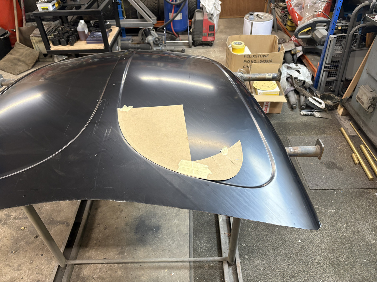

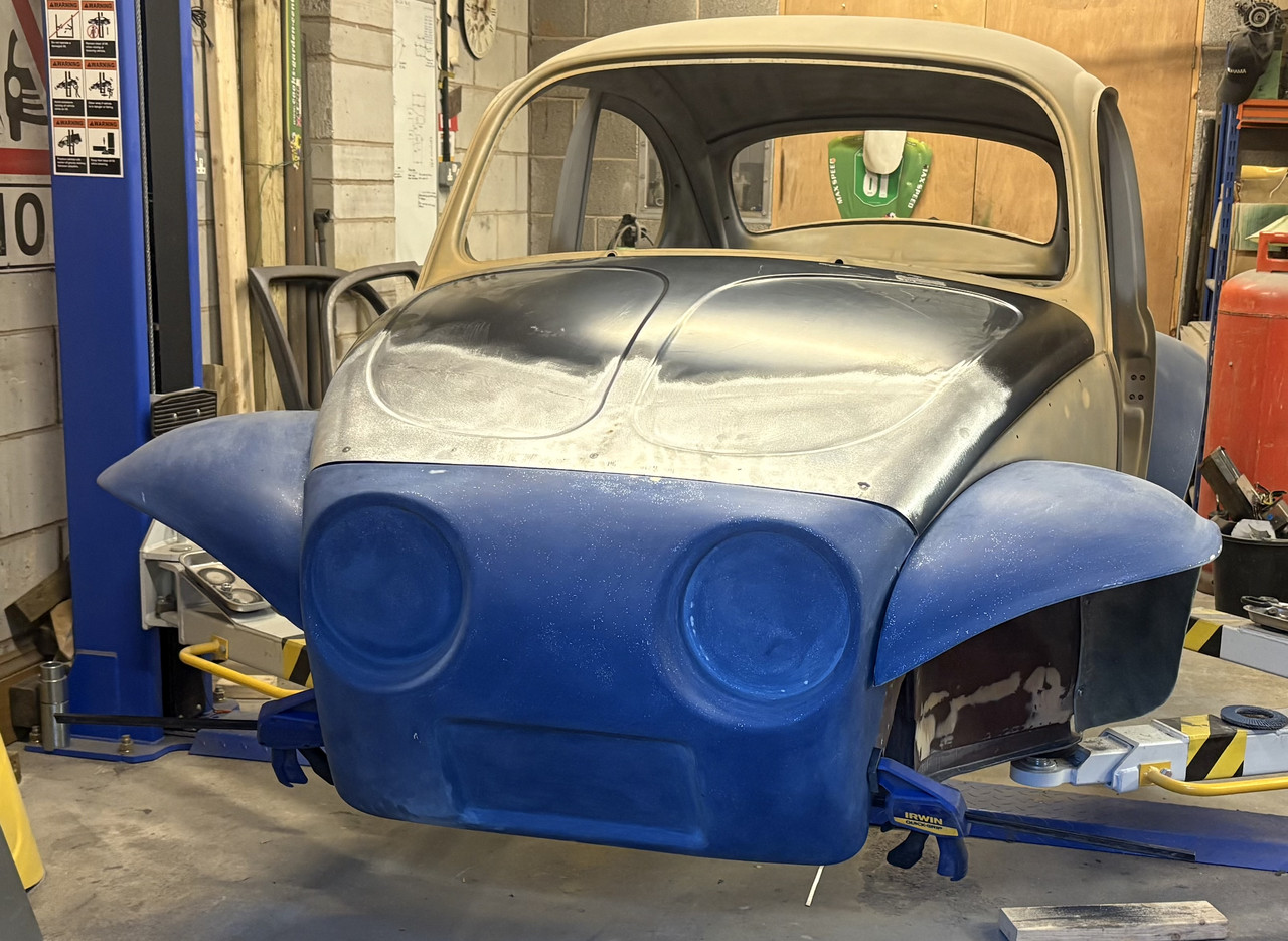

I'm not to keen on the fibreglass bonnet for the SandScorcher so I've made a rod for my own back, okay it's a bloody expensive way to achieve what I want but hopefully I'll end up with a steel properly opening and closing bonnet. Work in progress  ;-)up

 Now that's thinking out of the box, totally amazing!!!! Can't wait to see the finished bonnet....

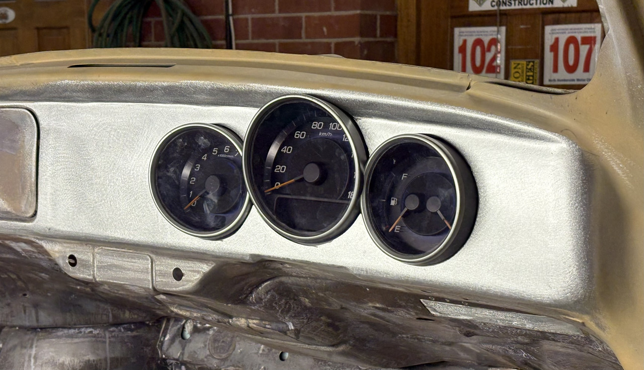

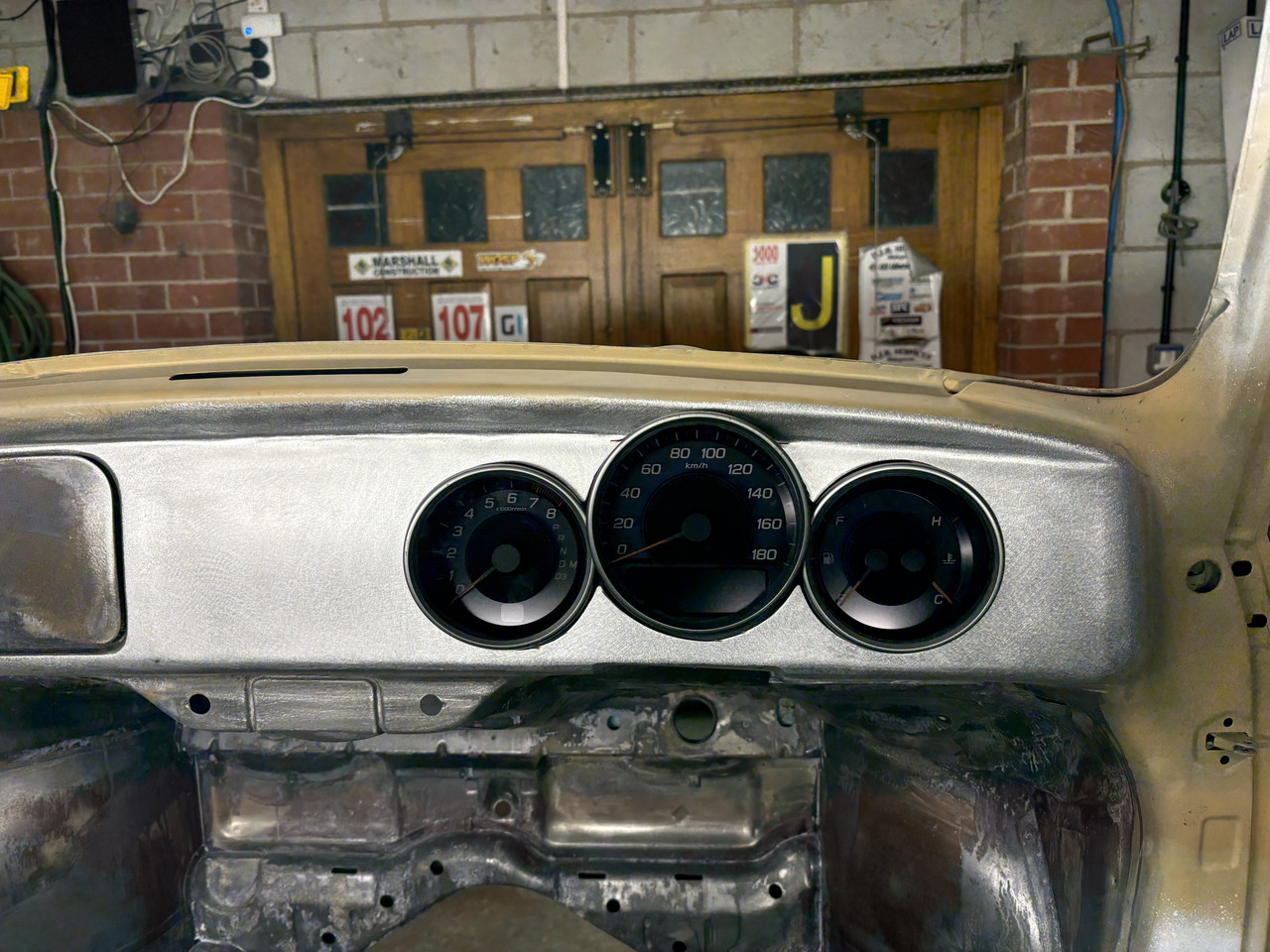

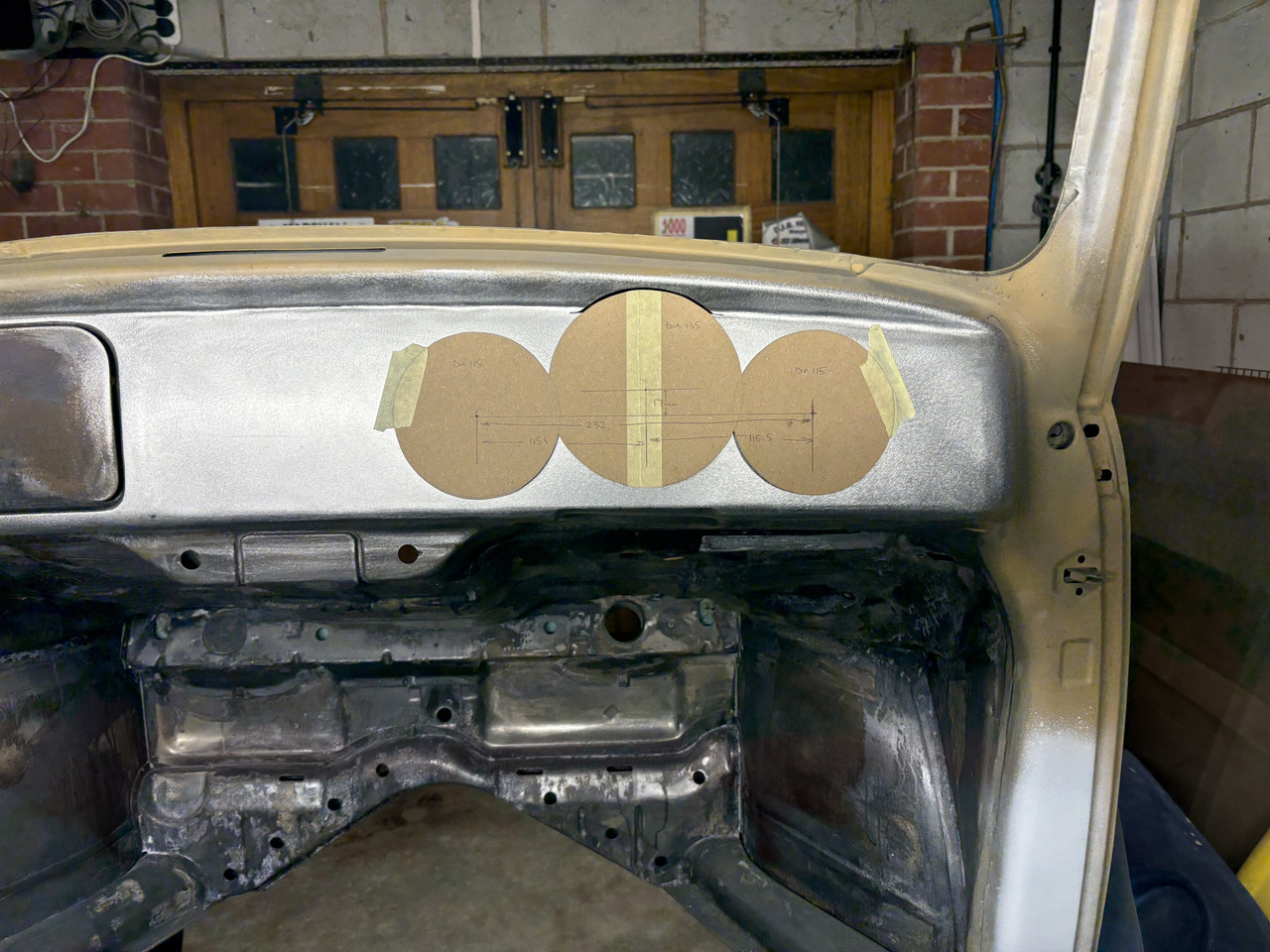

Dash modified and Honda clocks fitted, bit more dash line work to do but essentially there

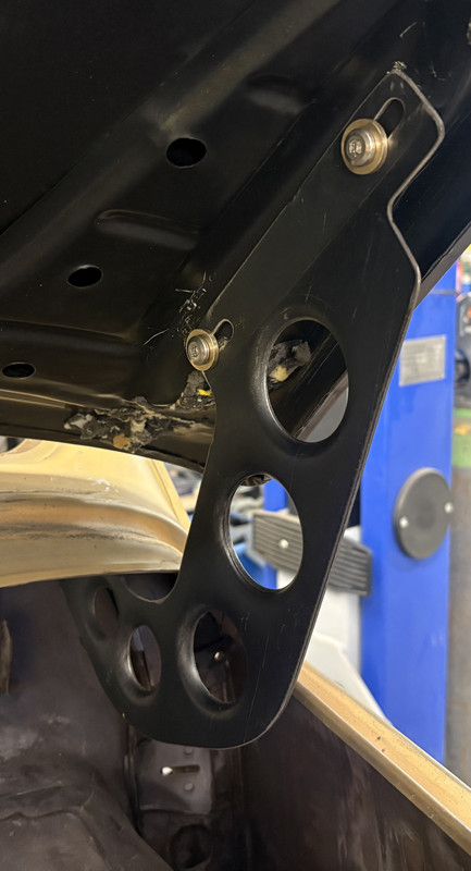

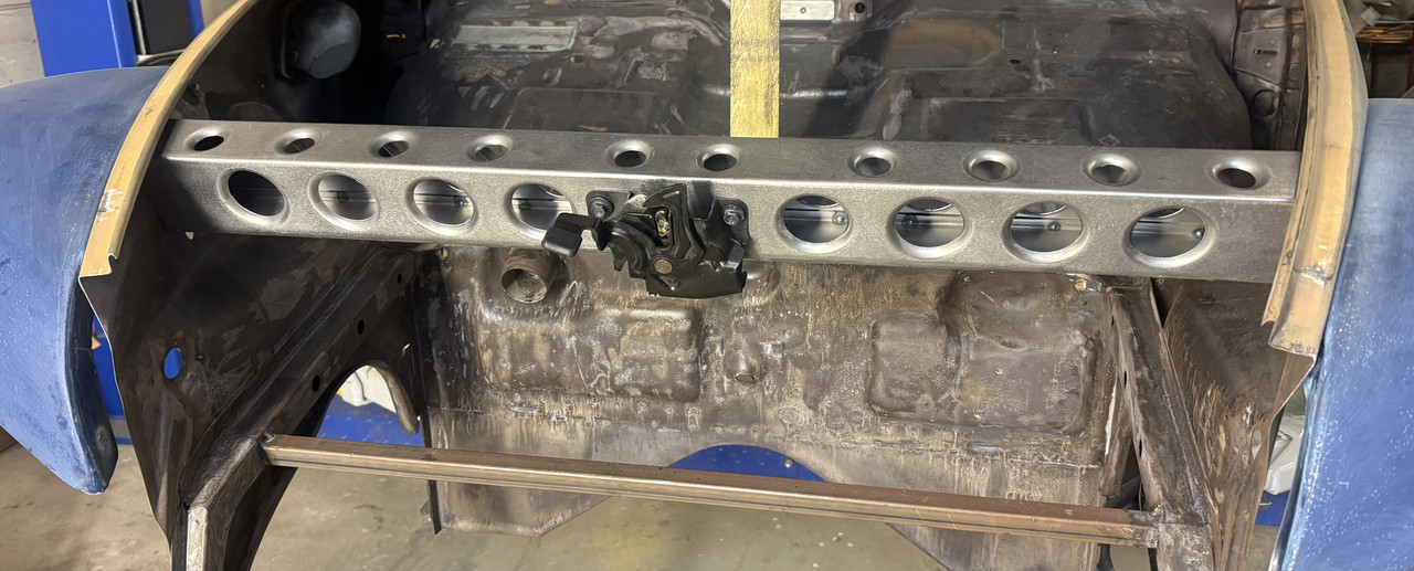

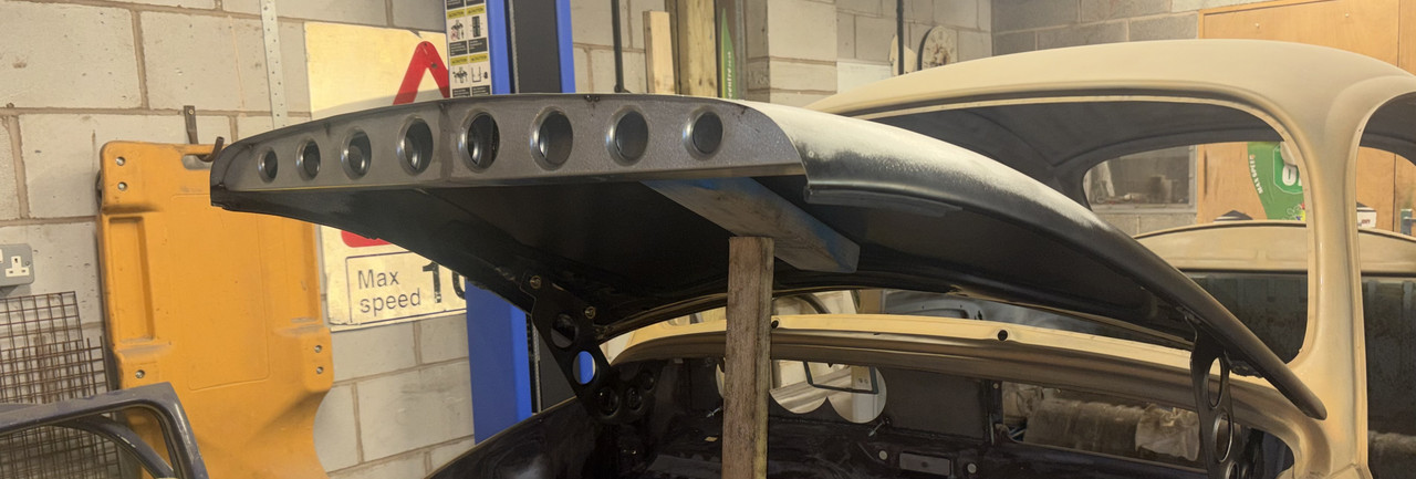

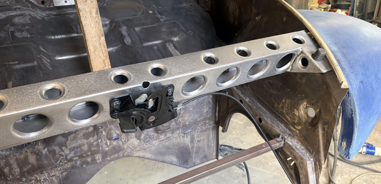

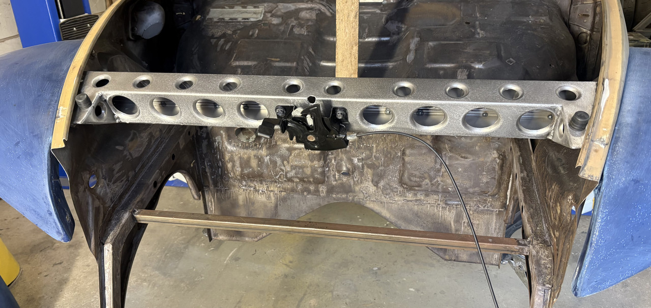

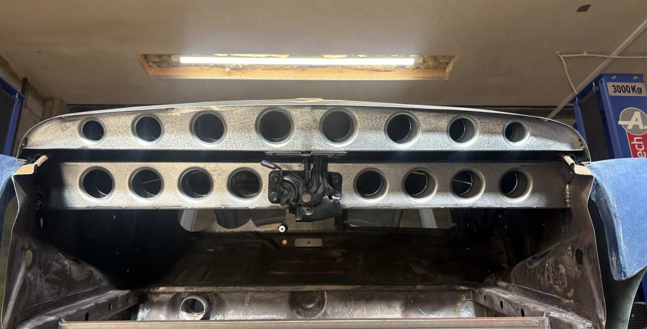

Home made bonnet hinges motorsport style
Work hard : play harder

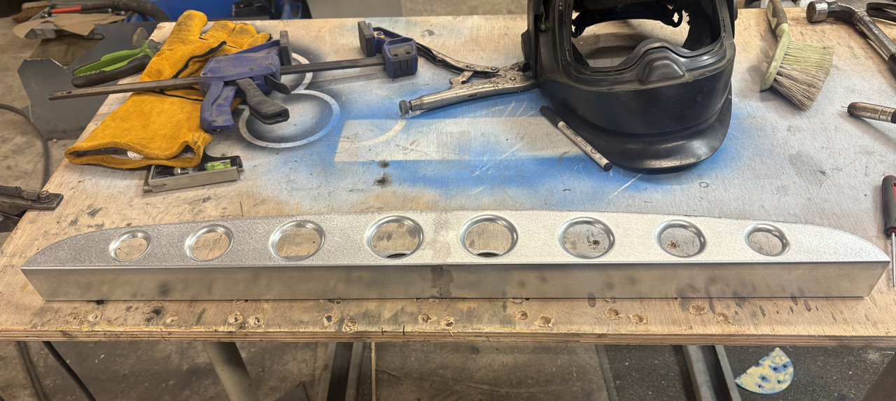

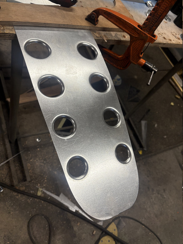

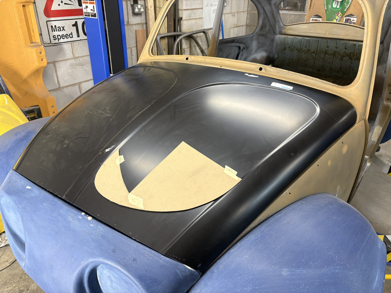

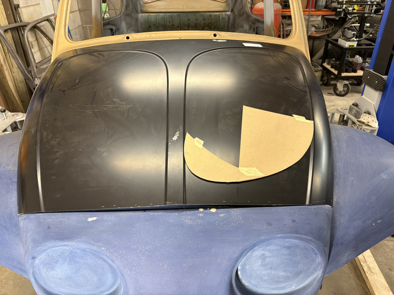

I wasn't going to post any pictures of bonnet etc until it was in primer but have decided it can be seen in its raw state. A little more panel beating is required and obviously some light skimming of body filler.
Once it's on gas rams I will put a second bonnet catch on so I can release the primary lock then the safety catch so it opens on its own for filling with fuel ⛽️

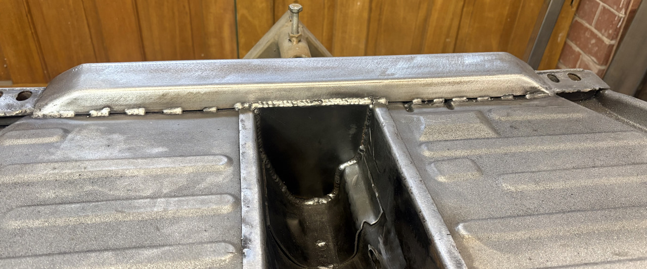

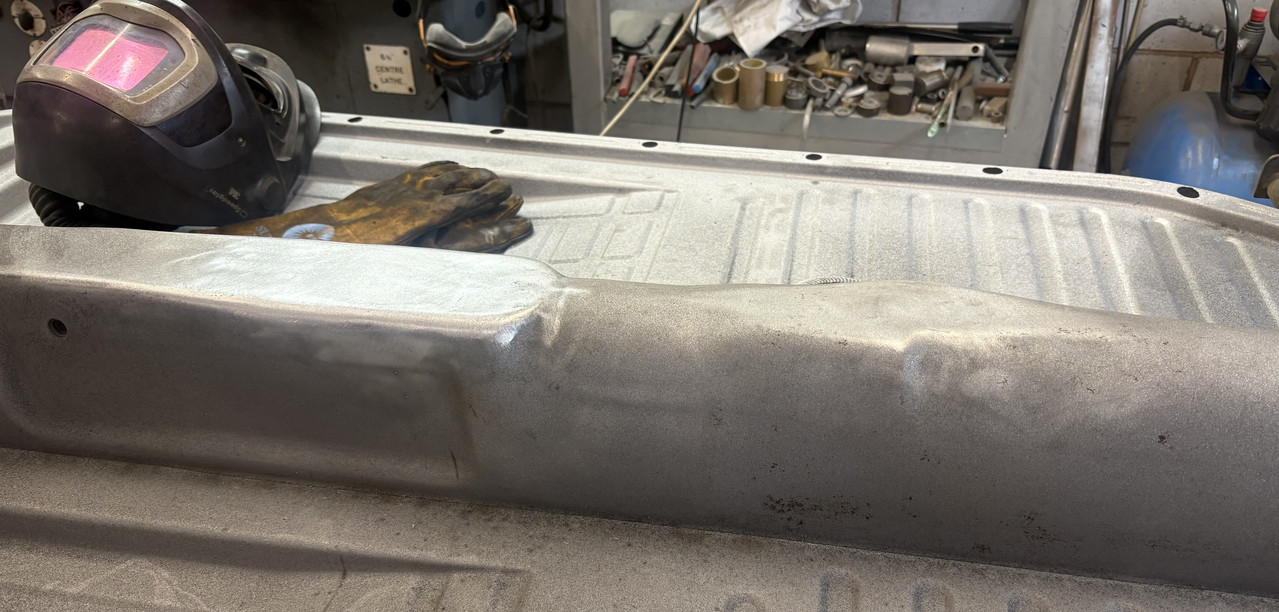

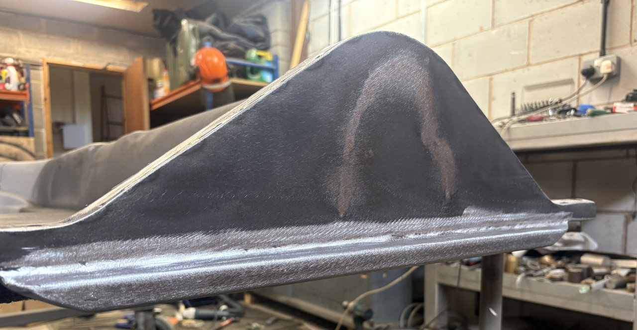

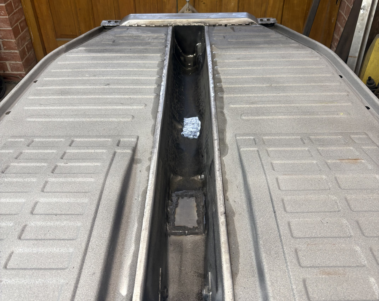

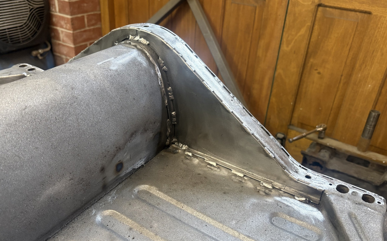

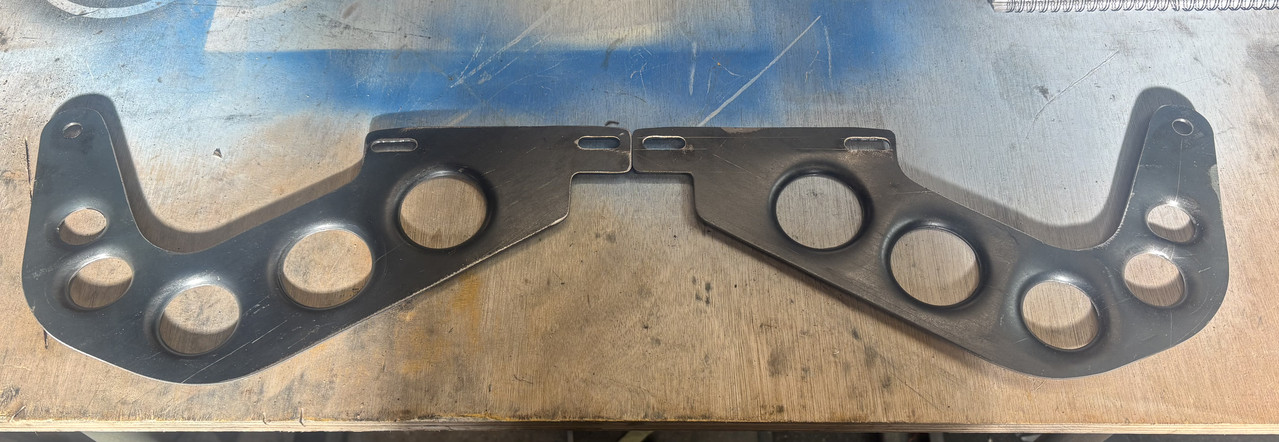

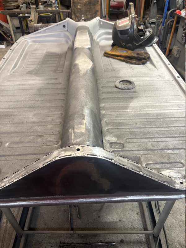

Started on the chassis, modified the front to accept A arm suspension the bottom plate will stay off to allow access for the gear change cable and the heater hoses. Oh I do like getting carried away  ;D
