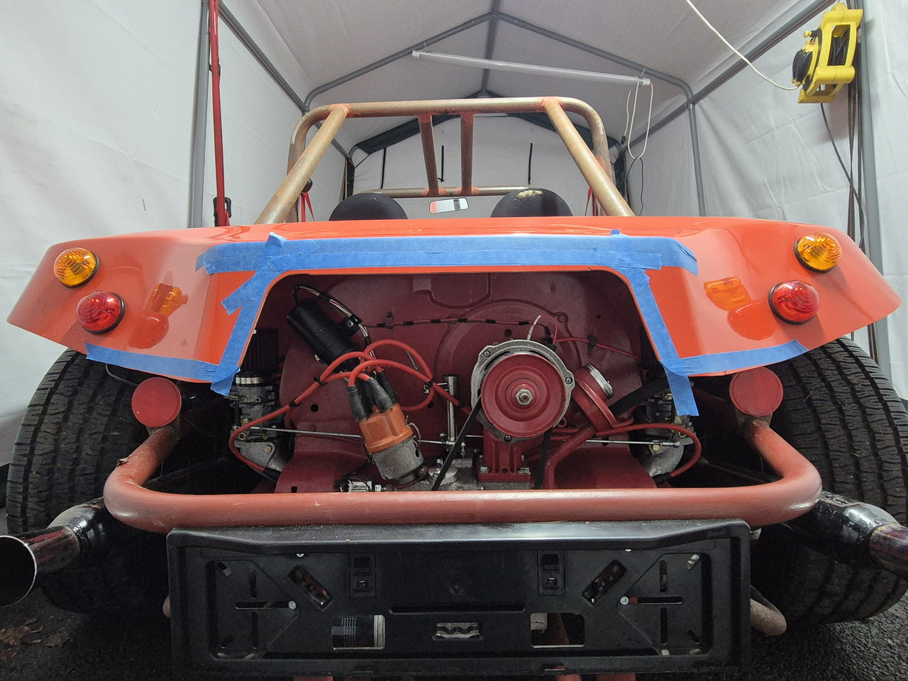

I always knew the body still needed to finish shape the edges after trimming, but i just wasnt happy with the way the engine opening looked.
The problem was that I cut a straight line under a curved body line. It just didn't sit right! I know its not much, but now the top line above the engine follows the body line above. I've also made sure that the shapes either side are symmetrical and flow properly.  I may be the only one to notice it, but I'm happy and if it doesn't stand out to anyone else, it must look correct.

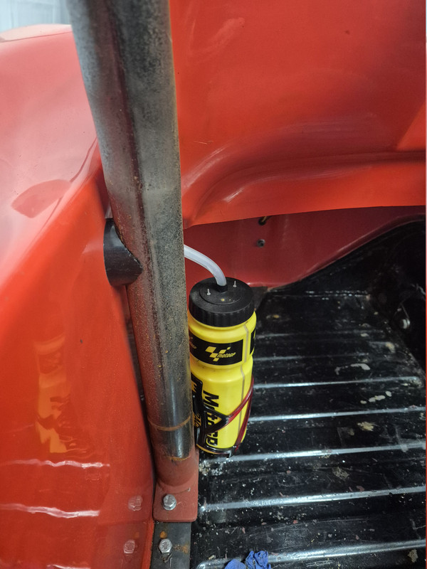

Washer bottle now mounted to the cage with rivnuts.

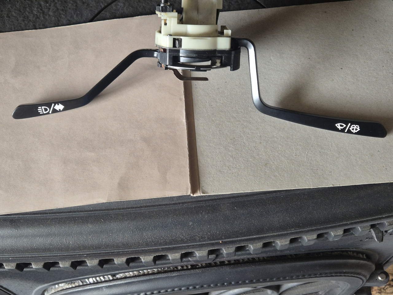

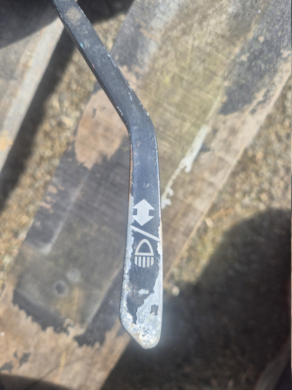

As you can imagine, the control stalks had seen better days! I repainted them and managed to get some vinyl mask templates to get the symbols back on. Really pleased with the transformation.

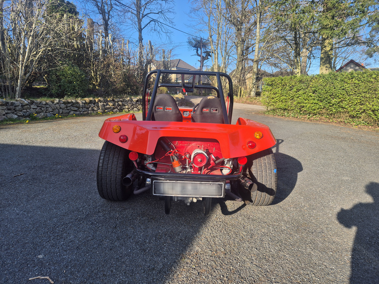

Good news. Buggy passed the mot first time and is now accepted and correctly registered by dvla as a VW Beach Buggy!
They say money can't buy happiness, but I bought a pile of car parts to build my happiness
"...may as well drive it..."
Indeed that's the prime purpose of buggys. It looks fab so I hope you get positive vibes from driving it whether to get a pint of milk or to attend a car show.
Great news another back on the road, it will give you shakedown and tweaking time waiting for the family upholstery to be done.
