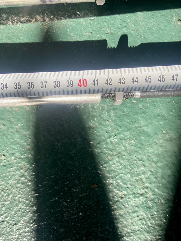

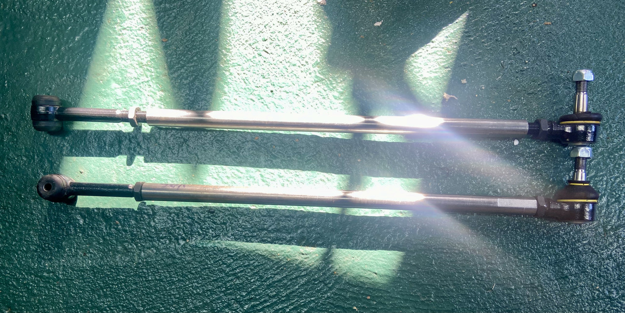

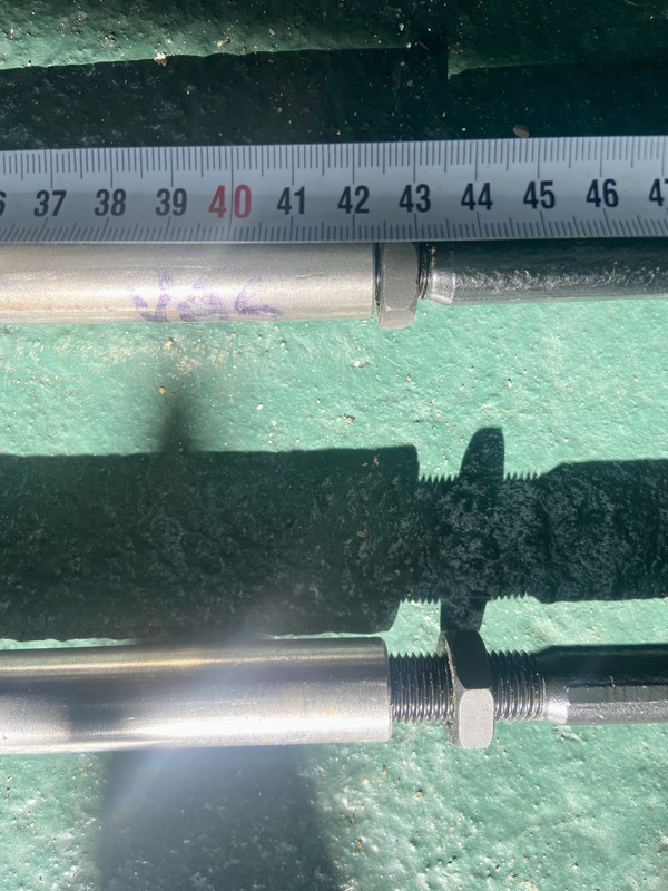

Quote from: Dave DND on June 13, 2023, 08:05:16 PM
what length are your rods and are they both adjustable?
I'll check tomorrow Dave. As far as i know they are straight bar tube with extra threads at each end so i can fit the rack in place, straighten the wheels up and see where i need to cut them so they can be adjusted by the normal way of turning each rod for toe in or out
Posts: 834
[/quote
There you go Dave
