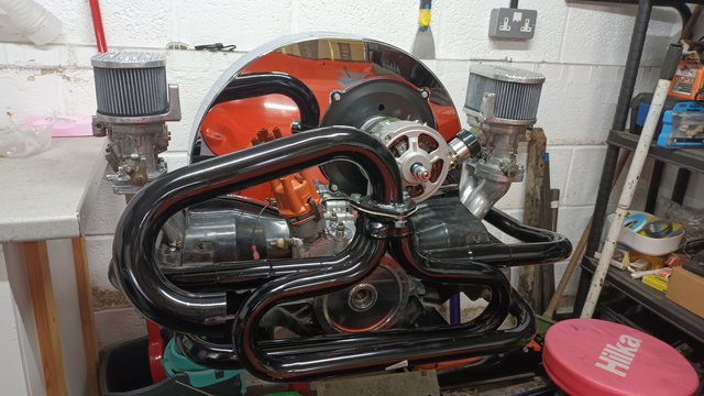

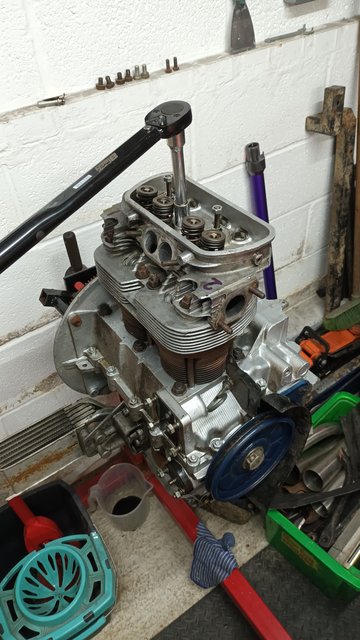

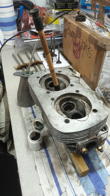

I got a bit fed up with the bodywork so I dug the engine out the shed and decided to give it a freshen up ready for install.
The heads were removed and stripped. I decoked them both and lapped the valves back in.
The barrels and pistons had minimal wear so I decided to leave these undisturbed as the engine was a good runner when I collected it.

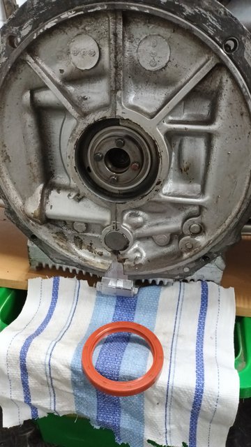

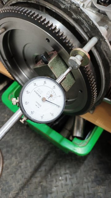

With the heads rebuilt and bolted back in place I fitted a new crank seal and flywheel. A bit of shim juggling and I got the desired 0.1mm endfloat.

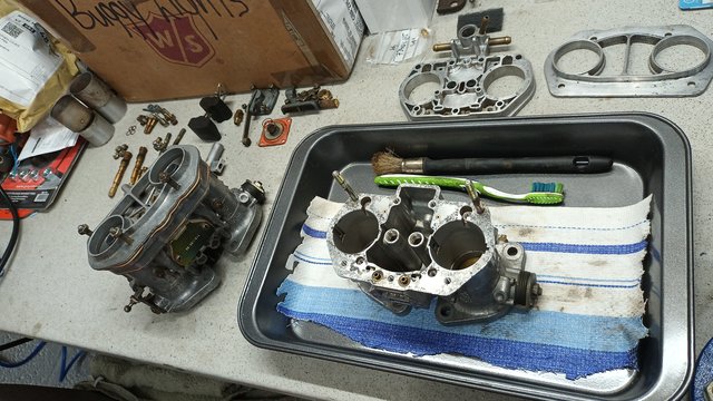

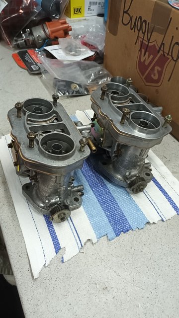

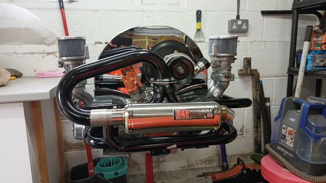

I wanted to add IDF's to the engine. I bought a pair of original Italian Webers from a friend who had them in storage for years.
A full rebuild followed with new gaskets and seals etc. I re-jeted them to the same setting I had on a previous 1600TP.
I also bought a CSP carb and linkage kit for the carb install. I also managed to get hold of a baja style header, a mock build with a new Alernator conversion and fan housing checked all looked okay.
Finally for a bit of bling I managed to get hold of a 'Yoshimura' race can to go across the rear. I hope it will sound good.

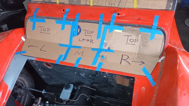

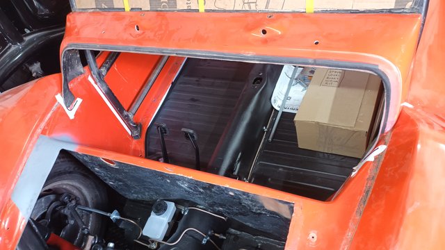

Back to the body and I wanted to make a panel to fill the hole betwen the tank and scuttle. I mocked up a pattern form cardboard then transferred this to a sheet of 1.5mm alloy sheet. This was folded and trimmed to suit. This will be a good place to mount the fuse boxes etc and stop drafts making my knees cold when driving.

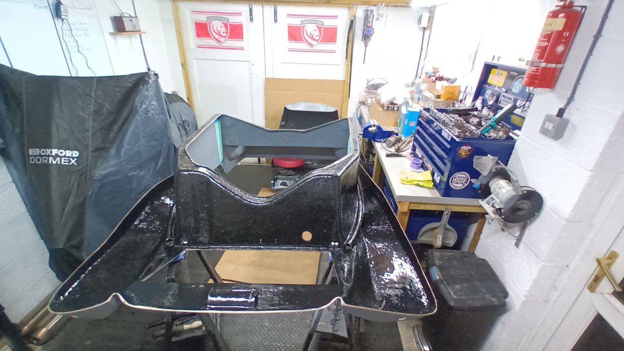

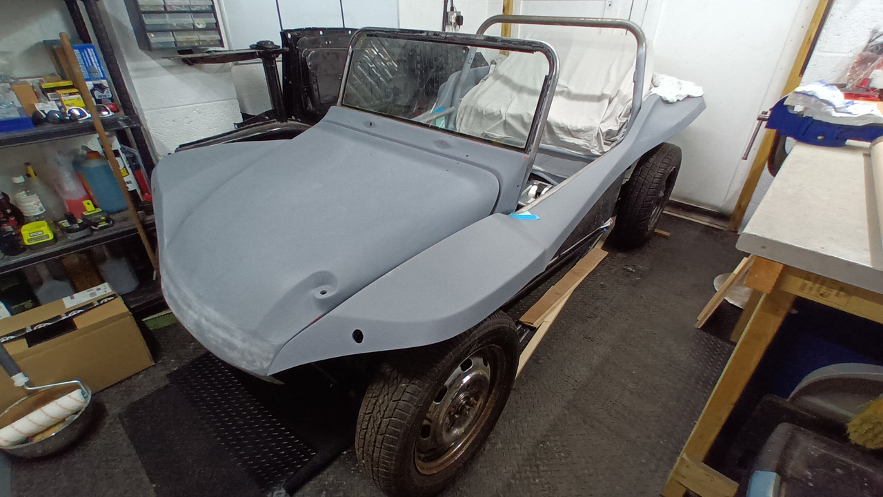

So, the Predator, I have been getting on with the body, I finished with all the repairs and after a few rounds or filling, sanding and priming I have the shell, bonnet and scuttle panel all etch primed.

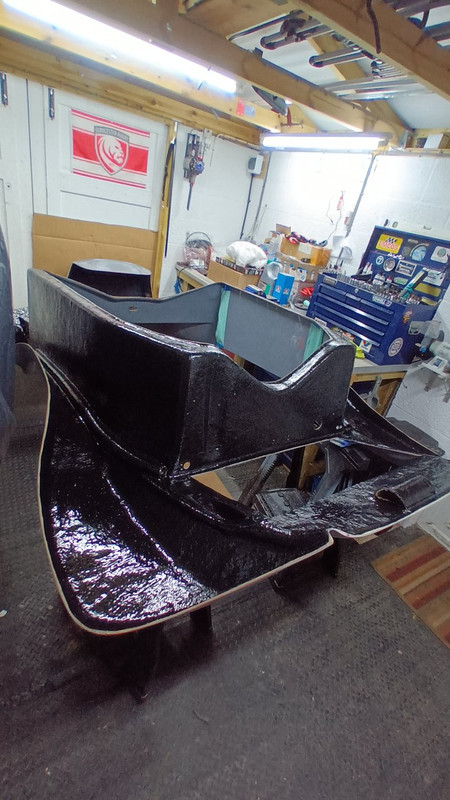

Once I was happy with the outside I painted all the underside in Satin black, two coats applied with a brush and 4" gloss roller.

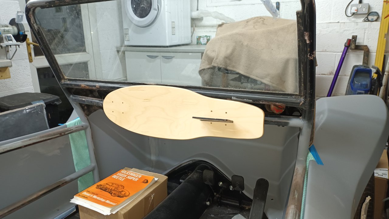

I have also started on making a dashboard for the Predator, as there was nothing there I decided to make one from a skateboard deck, Here is a shot from a test fit to see how it looks, what do you think ?

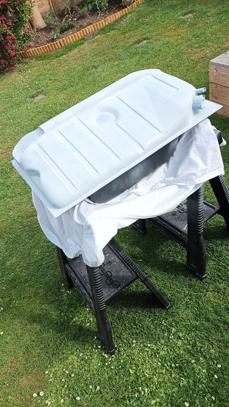

Also in between sanding and priming I tackled the fuel tank, a thorough degrease and a coat of etc primer and its looking a lot better, I have stone chipped the underside and will probably do the same on the top to protect it for years to come.

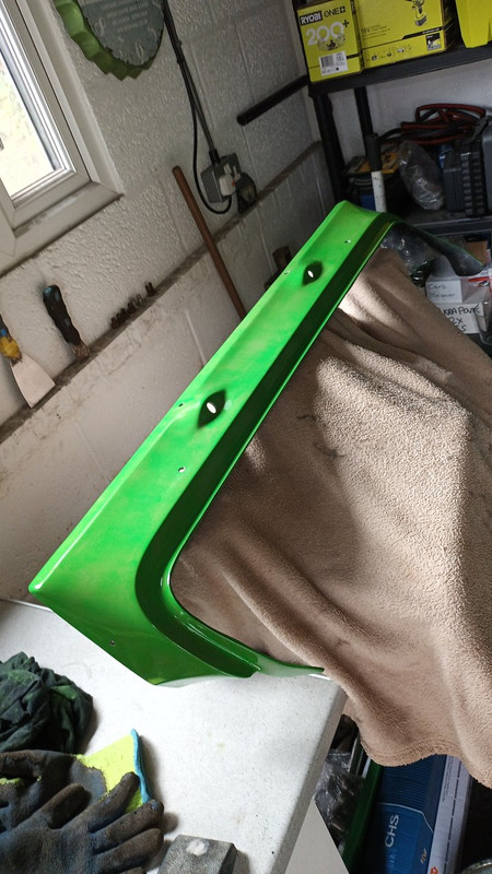

So, back to the shell and it was ready for top coats, I had many a family discussion to decide on the colour, the two options are keep it orange or go for bright green.
A couple of tests and we chose Green.
I dont have access to a spray booth so are hand painting it with Rustoleum Combi-Colour Multi Surface Gloss enamel paint.
I apply this using a 4" gloss roller and a fine brush for areas the roller does not get into.
I have had good success with this on previous cars, (Most recently a VW 1302s) and as long as you are patient, flat each coat between application it comes out really good, all for £50 of paint.

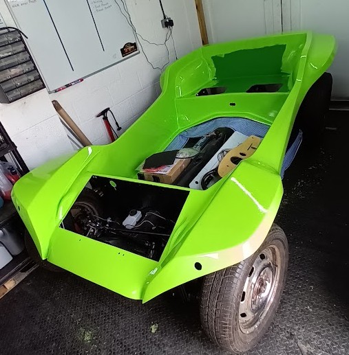

Here is the shell with 2 coats applied.

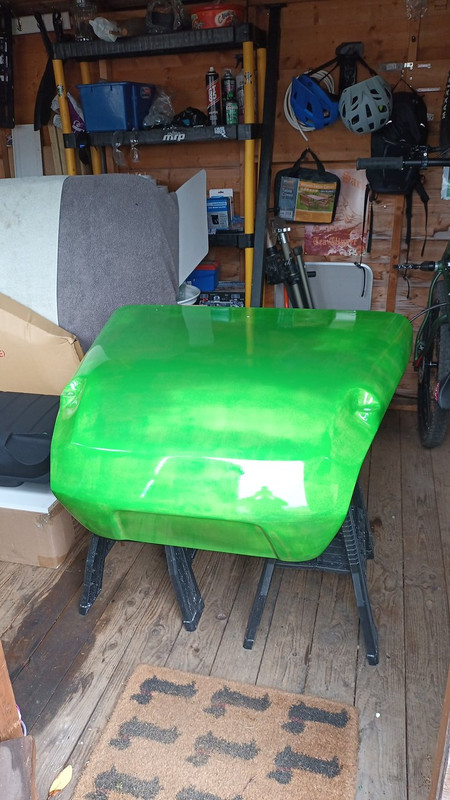

Here are the bonnet and scuttle panel after just one coat.
This is as far as I have got up to the bank holiday weekend, I have managed to wet sand with 600 all the shell, bonnet and scuttle ready for another coat hopefully before the end of this week.

I like the skateboard deck for a dash, nice original idea that will look cool  8)

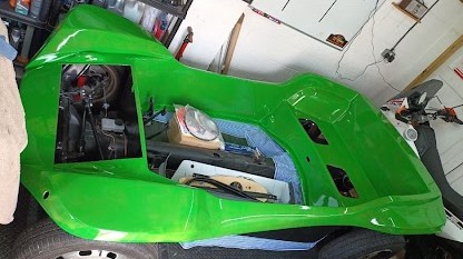

#44
Hi all,

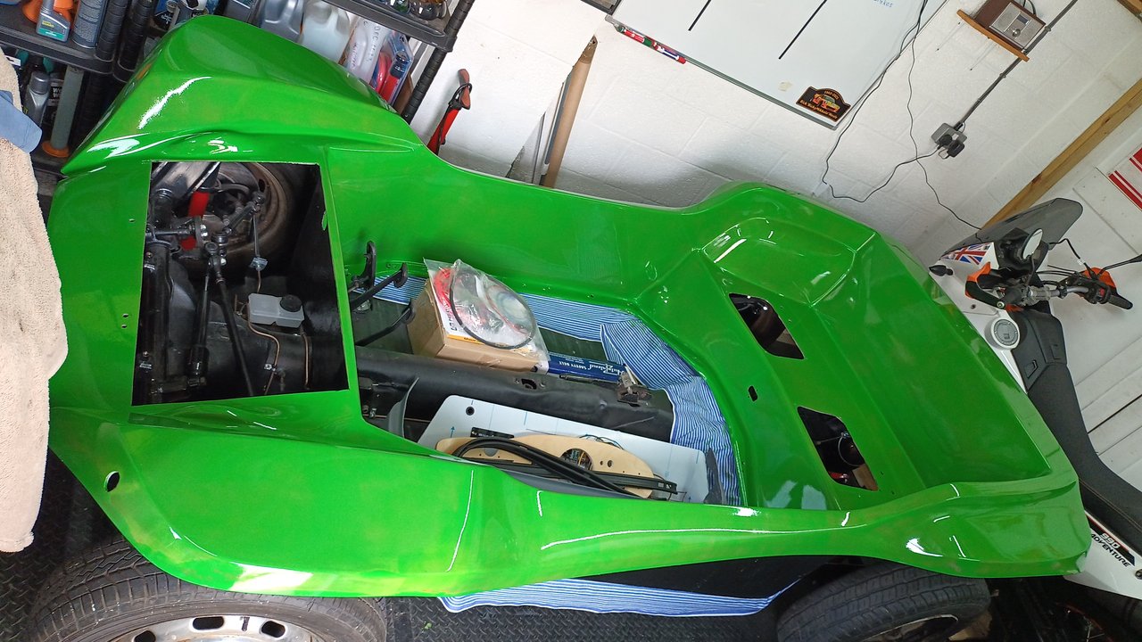

Managed to get the third coat on over the weekend, bit of a shock as the paint in the new tin is a "Slightly" different shade of green.  ;)
Same paint supplier, same paint manufacturer, same paint code.....
As you can see in the pictures below its a lot lighter. I have left a portion on the rear where the seat will go unpainted (Will paint black as its under the seats) see the difference.
2nd coat
3rd coat, new tin...
I dont mind the lighter colour, the more vibrant green has gone on well, I am happy with it.
Just goes to show though, never assume the paint will always be the same.
Hope to wet flat with 600 this weekend and get a 4th coat on next week.
