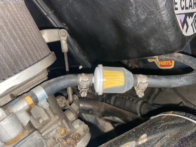

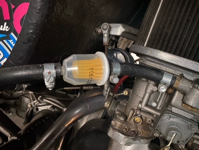

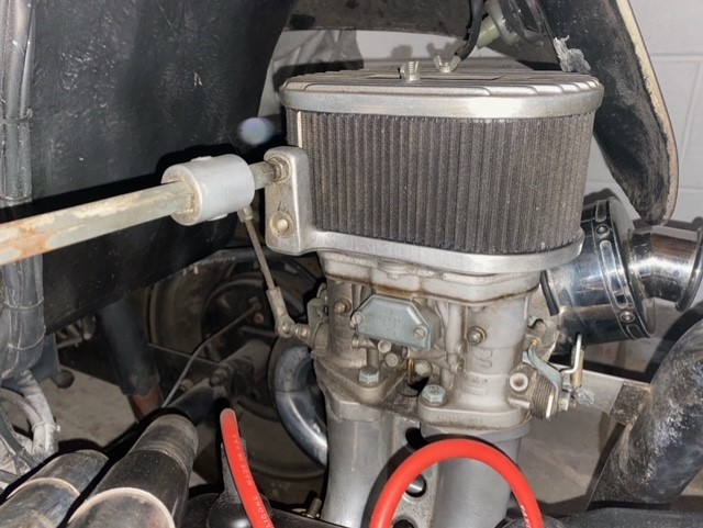

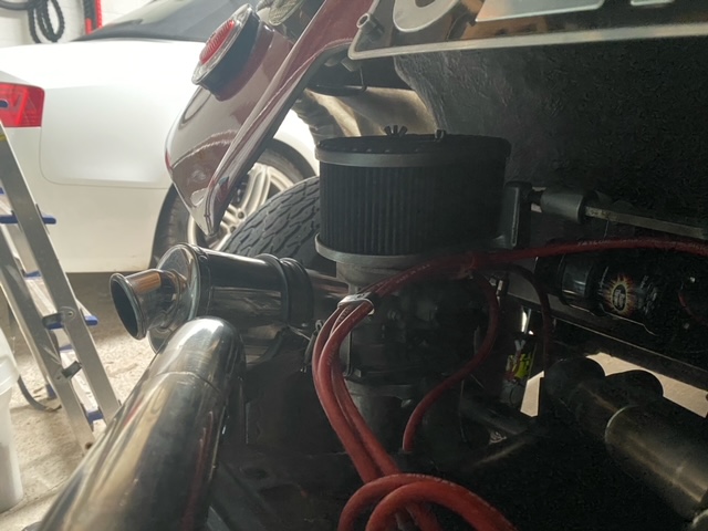

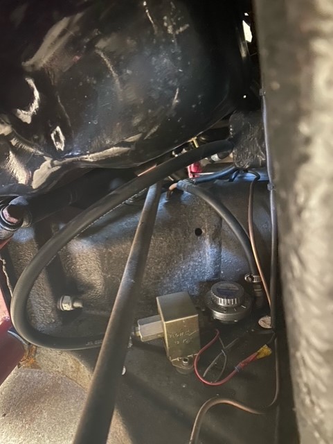

I have attached some pics for you guys to see.
Thanks for the fuel question. Only just bought it last week drove it like 20 miles, managed to get it back into my garage after it died on a roundabout and there she is stuck. So Im
a tad peeved I just bought it and It has ended up like this. But it's a lesson for me to learn more about it.
Some answers to some questions:
It is powered by a 1.8 type 4 engine uprated spec with twin 40 Webber carbs
I fitted the plastic inline filters to answer another question. Please see the photos you can see they are both new. (Hopefully the right way around?)

Best put one filter inline between the tank and the pump as they can and do burst with pressure and start a fire is not good.
