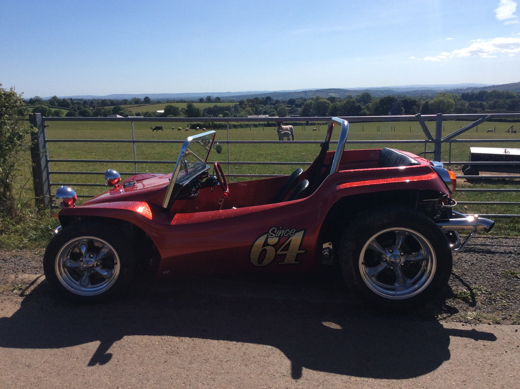

If it's possible I would change your brake drums for new ones pre drilled for five stud Chevy this will make life easy when choosing wheels and wheel bolts. Just my opinion but I would go for bigger diameter wheels on the Tramp as it's a long wheelbase Buggy and they will visually be more in proportion. Take a look at the Meyers Manx Manxster a lot of those have great wheel and tyre combinations. I have gone for Chevy bolt pattern 15 's up front and 17's on the rear of my Manx. I love the Tramp Roadster as my dad built one back in 1970.
make it if you can.
