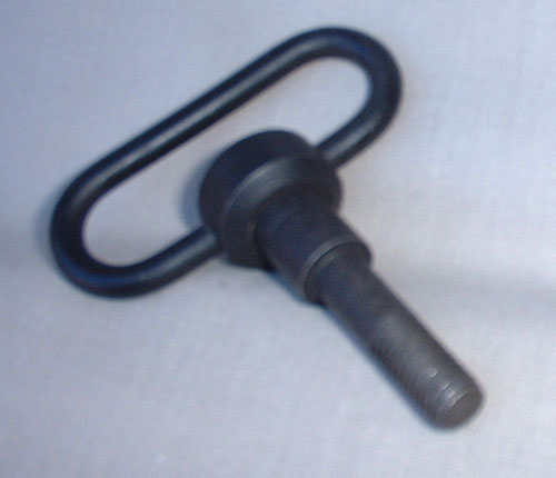

I have also use the luggage strap method but I used some shoulder strap loops of an old rifle to anchor
I just didn't have any old rifles lying about at the time, shame they look just  a the job.
You can also buy velcro straps pretty cheap off eBay, they would do fine
