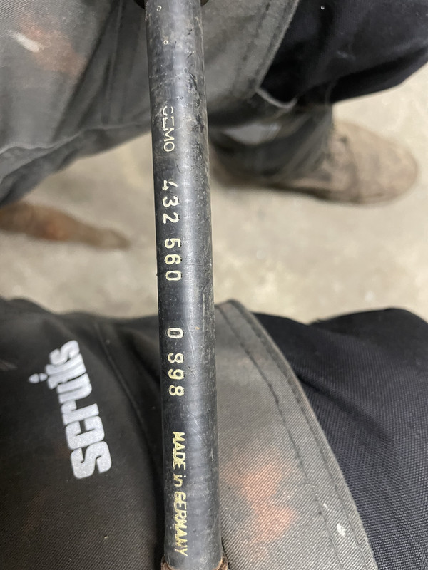

1 ) so part of my build relies on some custom parts , one is some brake cable tubes for the front of the horns to the handbrake .... The original tubes are in place from the horns to just infront of the rear torsion tube , where they are cut off ....  Now I've made up my handbrake system and just need to connect them up .
I've found the fittings on each end of the factory designed clutch cable tube is perfect , but in need some custom lengths , neither the same , but one about 40mm longer and one about 120mm longer , as the system is lob sided ...
I'm talking about these ones ,,, I don't mind attempting shortening them or even making a pair up fresh , but I can't even find a supplier of parts , only the usual shops , and I'm sure the likes of GEMO won't be interested in selling just parts ...

@Snoop , I'm trying to get longer clutch sleeves , opposed to shorter , I could use longer brake cables and cut the them down , I'd just need to buy two sets , one for the actual rear , hun to horns and then one set to modify on the actual chassis side .
It was just that clutch cable sleeves have a male and female ferrule on them and the female sleeves nicely over the solid tube coming into what would be original tunnel ...
So in effect I would need either make and female or two male ends , as the proper brake cable sleeves have as you know a cranked sort of end for the hub ans wouldn't fit into the tube section or bracket for the handbrake fitting ..
I'll try and a get a pic tomorrow to show ... the only people with joining would be that I need to do a bit of snaking around stuff and jsut worry that a sleeve / joiner may end up kinking a bit .

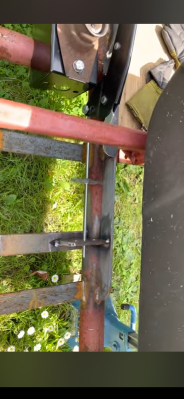

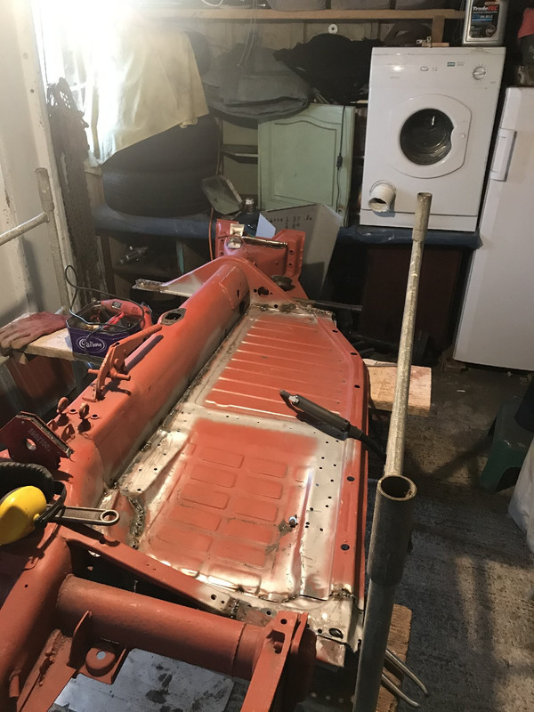

Here is an idea of what I've done , using the CBS basic handbrake ... and a homemade balance bare set up
And if you're really bored . Here is a link to a vid I did a few years ago when working on it ... https://youtu.be/7jL4EATgqLo?si=bLOM-5rqQnjdIHlf
It's the having to snake around the gear selector and being biased one side to the other that has got me a bit .... And I'm always wanting to try and achieve the best I can and tend to overthink how to do it .

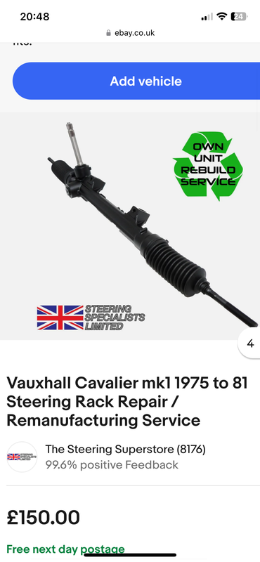

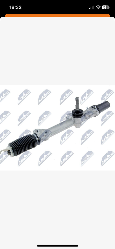

I've found a what you've mentioned , re the 106 / saxo one .... Jsut to make sure I've got the right one ... is this it as it doesn't clarify if it's power assisted ... I did see it  has both control rods connecting at one side , does this make it tricky for keeping the turning function balanced ?
And this one as a cavalier ??  Which I prefer the look / style as the rods are at each end and guess makes it easier to set up the geometry
