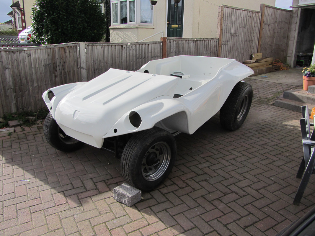

Reply #23 on: July 03, 2019, 07:23:35 PM
I've been reading all the great stories and advise so thought I would give an update of my buggy story.
It's been a while with some delays on parts and fabrication and some electrical gremlins. Engine up and running again although needed to change the distributor as the centrifugal spring was mangled up in the mechanism somehow and the carb was refusing to run smoothly so changed that too although I think a proper clean and rebuild and the 34 pict 3 would be good to go again - just went for a quick fix really.
Here she is so far. So close to being finished, just a few issues. Found one of the headlight not working although all was good a few weeks ago. Brakes lights not working so a full check of that circuit now needs doing - just replaced the switch when changing the master cylinder... The recent talk about bleeding the brake system came in very handy to get a solid brake pedal.
Clutch working perfect but gear selection not working correctly I don't  think enough care when reinstalled .
I'm sure I will find more to do before the mot but it's getting close to the big day.
