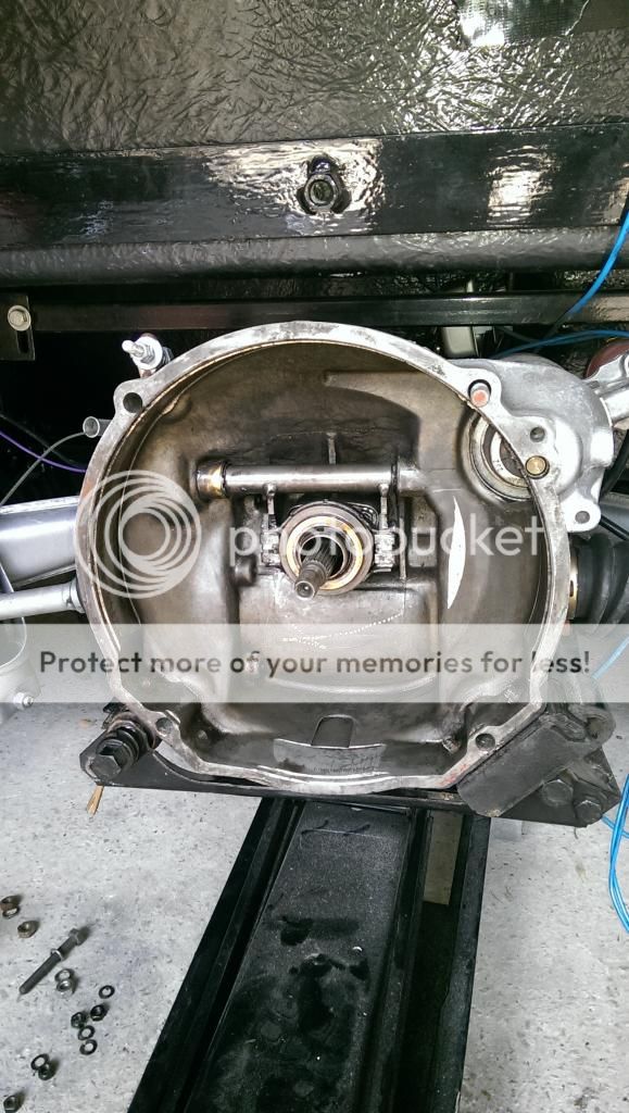

First one (and yes Shaggy I should know but I did say this would take pics for me to explain  :D)   .... Took the old engine out and this is the thrust bearing

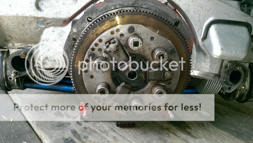

and this is my old engine
Inteestingly looks to be a bit of wear on it....

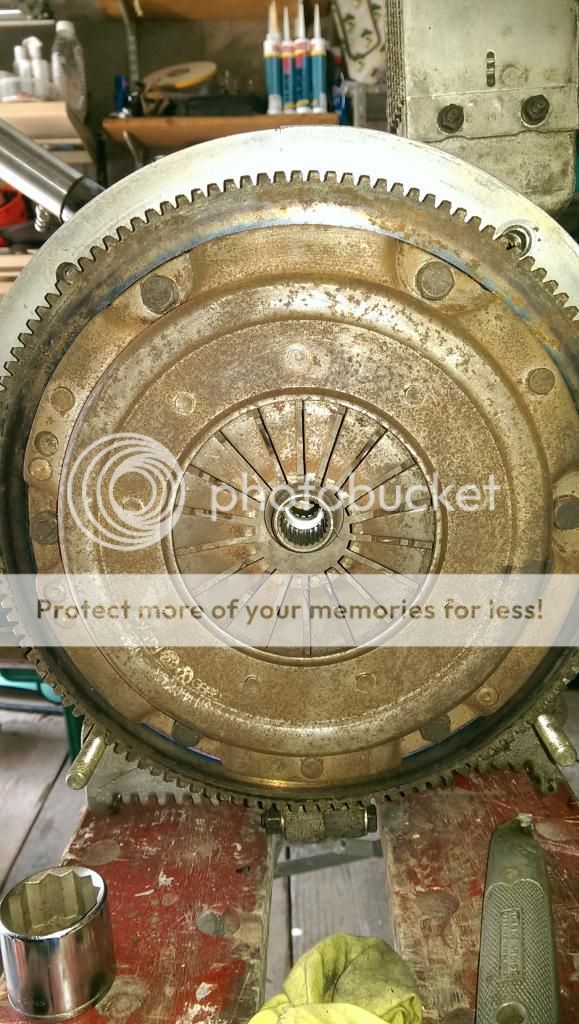

And this is the replacement engine....
So do I need to change anything.... if its just the clut plate would I be wise going Kennedy Stage one as its a 1776 and will have twin Del 40s?

The new style clutch pressure plate'll be fine. It's just a different design (diaphragm rather than coil spring) but it'll match up with your release bearing OK.
Photos printed on genuine ILFORDŽ paper.
this user is offline Shaggy
  • Posts: 2477
  • midlands
  • Limited edition Californian
Reply #2 on: June 01, 2014, 05:11:10 PM
Will fit straight in ...no messing about. You shouldn't need a kennedy clutch. I would try it first and see how it goes then order one if it starts slipping under load.

I think Dave dream was or is having some issues with a slipping clutch and his engine is the same size as your new one I think. He did put a post up about going for a Kennedy clutch. My opinion if it were mine would be go for the Kennedy clutch while your engine is out now. The new clutch comes with all you need to fit it to that release bearing.

I've run a 1776 on a stock clutch in the past with no issues at all. TBH I don't think my knees would stand pressing on anything stronger these days...I'd suck it and see, if you need the engine out again it's only 4 bolts anyway... ;-)up
